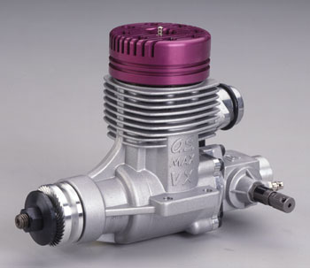

RE: Nitro models pusher Bobcat?
What is your opinion about this engine (OS 46 VX-FX) without Ducted Fan? Just a good and specific Pusher Propeller, for example 10x7 or 11x7.
#1130
Join Date: Nov 2002
Location: Crete,
IL
Posts: 2,251
That's an OS .46 VX-DF not FX. That engine wouldn't work without major surgery to the rear of the plane. It's a rear exhaust engine which means it won't fit in the stock location because the exhaust and carb would be into the rear of the fuselage. That engine is designed for high RPM's and a lot of concentrated cooling air moving past the head. I'm not even sure that engine will work properly with a prop instead of a ducted fan unit, maybe someone else can chime in and give you more info.

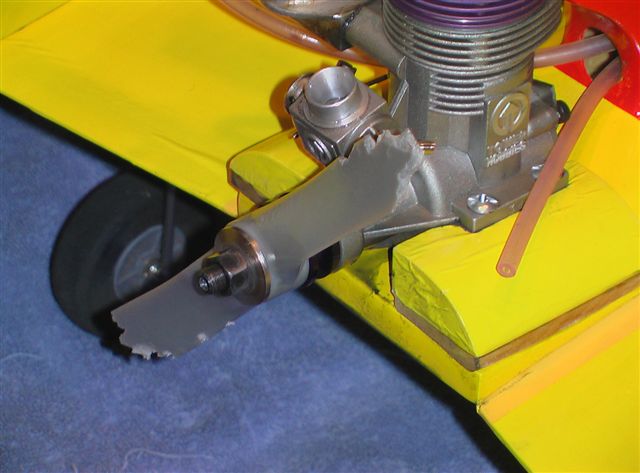

After having the needle valve bracket break and the needle valve get sucked into the prop Sunday, I took the needle valve bracket and valve off a Tower .61 I have in my Extra 300 and put it in the Bobcat. However, I didn't, but should have, taken dragonpilots advice and used a piece of carbon fiber or flat bar instead of the bracket. Did the same damn thing happen yesterday and another needle valve get sucked into the prop?.....yeah....Do I feel like a dumbass for letting that happen again?.....yeah
I bought a Magnum .91 and mounted it. Waiting for 14x7 three blade props on order. Instead of cutting the blades down tho for ground clearance, I think I'm going to make some taller gear. I've already made new gear with 5/32 wire purchased at LHS, so I know this will be easy to do. I fly off a nice smooth black top, so I don't think the taller gear will be an issue.

Posts: 940
ORIGINAL: flyinmagician
You only have so much room between the booms no matter how tall your gear is
Ah yes..right you are,...I have an 11 inch prop on it now and only have about 1 1/4" clearance,...I will have to cut the blades down a bit won't I.....chit
