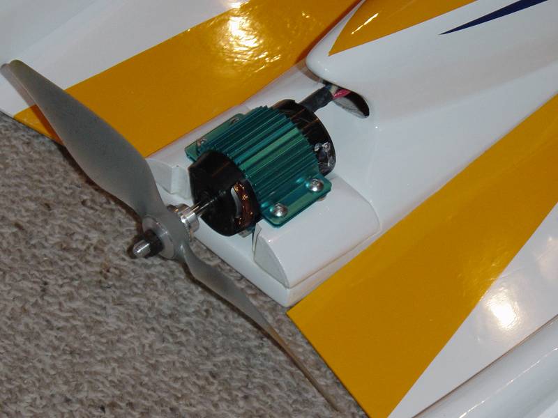

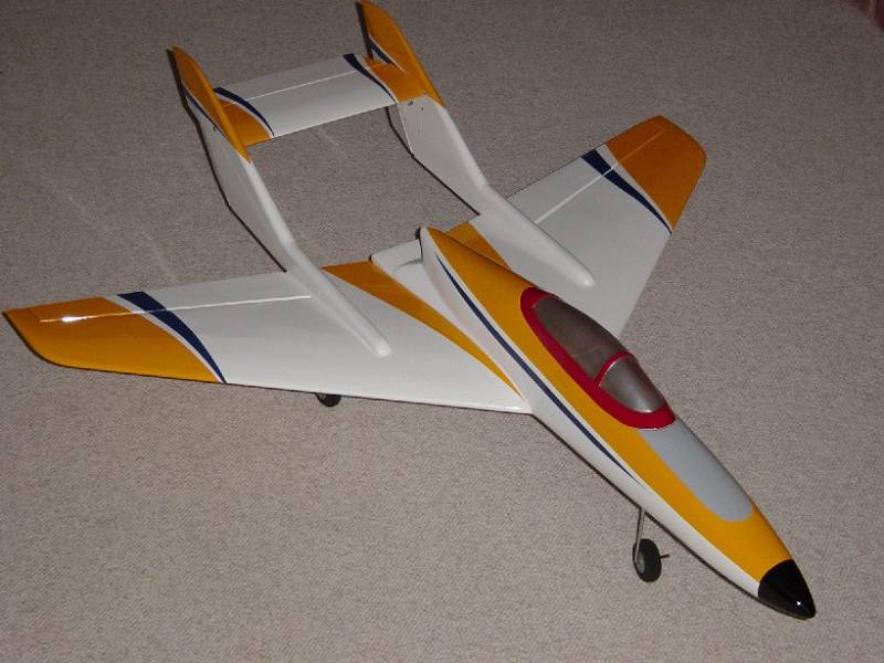

I test flew my falcon .25 with Mega 22/30/3 on 4s and about 830 watts. It was ok. Probably 80-90mph. The speed control overheated and had to land deadstick and broke the landing gear block, so will add retracts or hand launch now. I need a better motor combo though cause it was pretty boring at that speed.

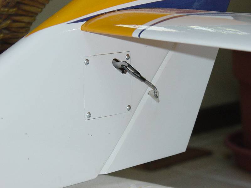

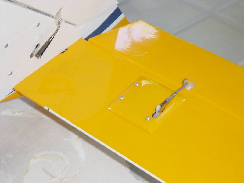

I re-covered the whole things cause the Chinacote was all wrinkled and added hatches and recessed all the servos.

Very nice particularly the rudder assembly.
You have it perpendicular to the control horn doing away with the angled linkage movement of the default setup.

Tumbler:
Did you adjust your ESC's timing to your motor.
I find that it makes a HUGE difference.
You need to hook up a watt meter to reveal what is the best timing configuration.
I tripled my motor's initially anemic output by adjusting the timing and playing with prop sizes.
IMHO with your setup you should be running at LEAST a 10x8 3 blade prop.

No waaaay. I am drawing 60amps already with an 8x8. That would be way beyond what the motor, speed control can take. I need to get something that will draw somewhere around 40-50 amps, give me at least 60-70 ozs of thrust and have a picth speed of over 130+ to get it to fly close to how I want.
Brian

Strange, I put a 10x7x3 MA Prop on mine and it's drawing about 420 watts at 30 amps.
I haven't measured it but I believe I'm getting about 58+ oz of thrust as the plane which weights 3lb's 6oz easily lifts itself and accelerates when pointed straight up.

Are you sure you have the same motor? I am well over 800 watts on mine with an 8x8. Mega 22/30/3. Mine is direct drive. Are you using a gearbox maybe?

No it's not the same motor.
It's a Tower Pro ( sold as the BP2915D at BP Hobbies ).
This motor has a max capacity of about 500 watts, and is supposed to be the equivalent of a .30 sized glow engine.
Since yours is far more powerful, I would assume that it needs an even bigger prop to be able to draw more power.

No it doesn't really work that way. It depends on a lot of factors. The KV of the motor, the number of cells you use, etc. For example, on 4 cells and a 8x8 prop mine draws 60 amps and 800 watts. On 5 cells I would have to drop the prop down to probably a 7x7 or less because the motor will turn higher rpms and draw more . The idea being that the more cells you add, the lower your amp draw will be. High volts/low amps is the key to power. You have to find the combination that lets you stay in the range of your motor, speed control, and battery and still give you waht you want.
