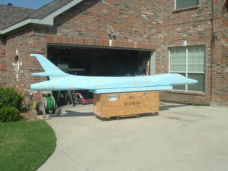

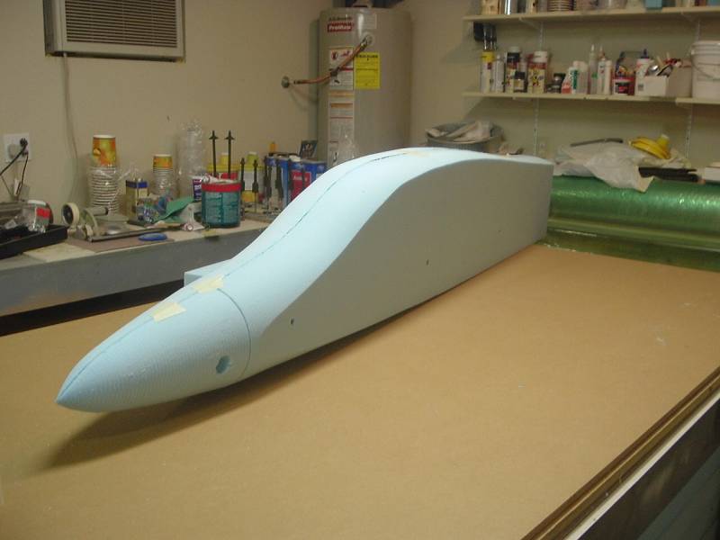

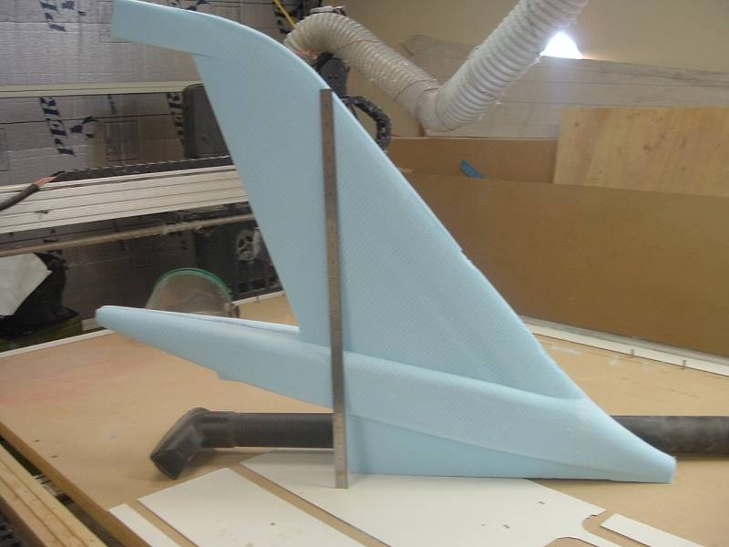

I finaly started cutting my B-1B. It is 1/8th scale,length 214.25", wing span 205.75". Hope to have all the parts cut by Southwest Jet Meet in Waco.

What kind of foam are you using ?
Im looking for some like that to build a model with and cant seem to find any.

It is Blue Styrofoam. http://www.southwestvault.com/home.html It is in Dallas Texas but they might be able to help you find some in England. Butch

Butch how are you cutting it out? Fill it us in, it looks really awesome, I always admire your handiwork.

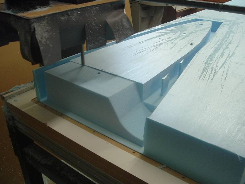

I have a CNC router. 50"x108"x10". I had to split the fuse up into 34 pieces so I could cut it. Wish I had a 5 axis machine. I will put more pictures this weekend as I cut them out. Butch

Is the router home made or commercial? Are you the one who had a gear mock-up at the Southwest Jet Rally about 2002?

It is a commercial router. It is made by EZCNC. It's not the greatest machine but it is great for what I use it for. Yes that was the gear. It was 1/14th scale,it is going to enlarged. Paul Stelly is helping with the project, he will be making the gear and what ever else he wants to do. Butch

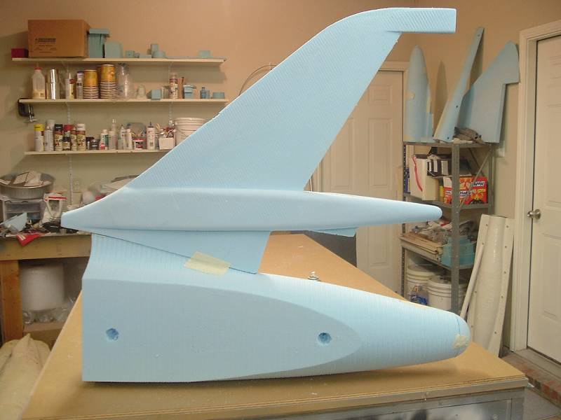

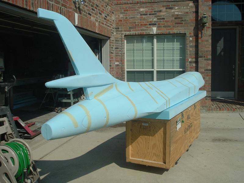

A few more pictures. Will have most of the parts for the fuse cut out this week.

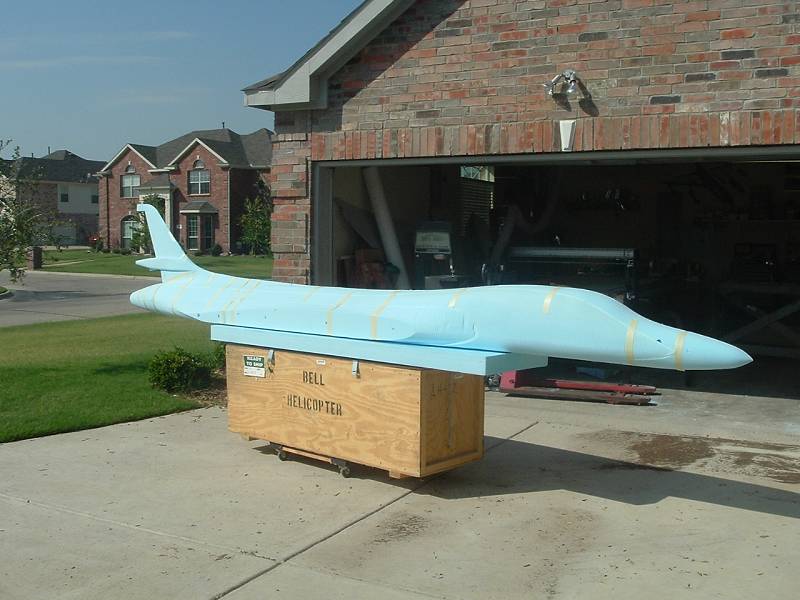

Two more days of cutting and I will have the fuse done. This is the first time my Wife has said it was to BIG!

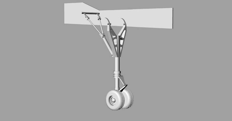

I will be making molds, the wing will swing and as far as the turbines,I don't know yet. I hope to have everything operational when it is finished. Butch Sickels 817-223-0779 rssickels@sbcglobal.net

This is going to be a Plug. I will be putting 3 layers of glass over the foam and filling and sanding it till it smooth. White foam expands and contracts to much. If you are planing on making more than one you should make plugs and molds.It is a pain but worth it in the long run.
