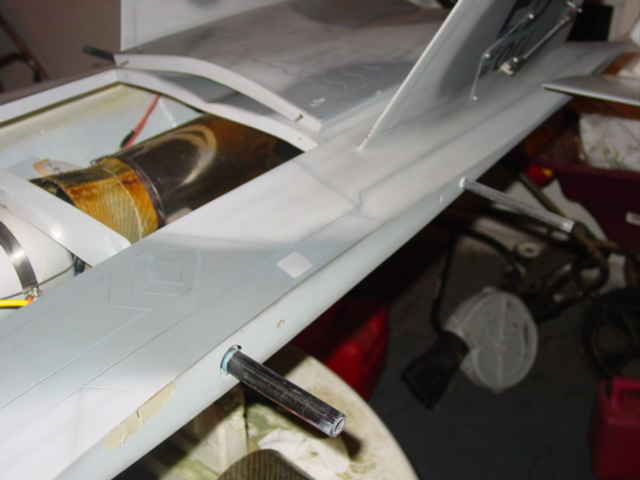

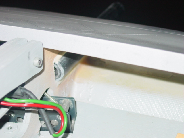

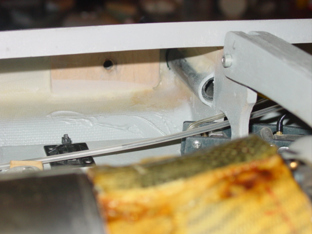

I have this setup on my Cristen Diffussion F-22
I can take some pics tonight.
Basically there are 2 carbon rods projecting out of the wing.
They have a receiver tube mounted just inside the fuse.
I use 2 thumb screws through the fuse into the side of the wing to keep the wings snug to the fuse.
The receiver tubes do not go all the way across the fuse. They are glued into part of a former on the side, maybe 2 inches into the fuse.
Very strong setup.

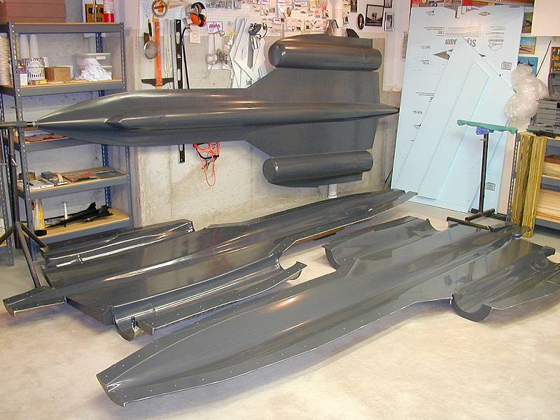

Actually, Ron's drawing above, hits the nail about on the head. At this point what former goes where is totally open ended, depending on the needs of the best method.
This is the bird:
[link]http://www.mmrca.org/lance/sledframe.html[/link]
And I've got another update ready to upload when I get home tonight, as I've just finished the bottom fuse mold.
Now with all the major molds done, I'm turning to the final points of former layout and placement. I've got most of them worked out in my head, where they are going and why, but am still open minded on wing attachment methods.
Lance

Been following your project since the beggining... congrats! didn´t knew that it was yours. And you are going to cut the wings between the
fuselage and engine pods, or just the outer panels?
Enrique
Enrique
RE: Wing Attachment Method - Seeking Advice
Just the outer pannels, which will make for fairly simple plug in wings.
The nose will come off, just infront of the wing. However the molds for the fuse are in one piece, and the separation formers for that joint will be glassed in while it is still in the mold. That way, when the plane comes out of the mold, the nose will be cut off, and the alighnment is already build in for it's bolting back on for routine use.
That will leave the aft section as a solid unit, that contains the main landing gear, 2 engines and mounts, fuel system, 2 nacelles, 2 vertical fins, drag chute. That signifigantly simplifies former layout and keeps the meat of the gear as one strong piece.
