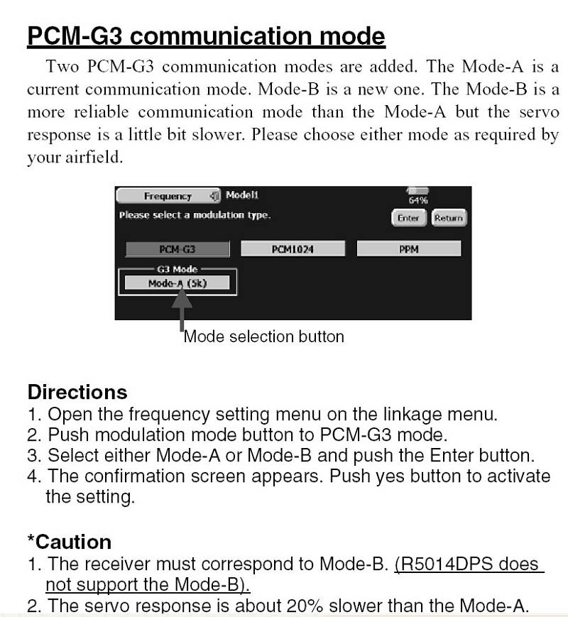

RE: 14mz and jets ??
Ok.. you wil have more chances to be successful with the 14MZ if the slower-and-less-prone-to-lockout-PCM is selected. However, you can´t do this if you have the original R5014DPS receiver, this can be done only with the newer R5114DPS rx.
Unfortunately this problem was found after some expensive crashes worldwide... However IMO there is another flaw in this gear wich make me decide to not use it anymore on any airplane . I was spared from a Jet crash on plain luck, and don´t want to push my chances with it again.
Enrique
Enrique
