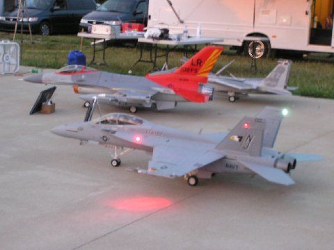

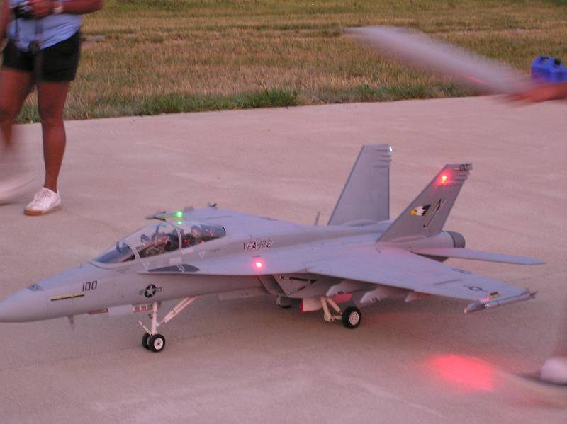

Thanks........they do look good. The orange hue on the nav's is due to me not dying the lenses red long enough on the 18......you kind of have to experiment with how much light you want visible when you are using lenses over luxeon emmitters because they are so bright! I had Andy give me burning kerosene color with the AB's because I'm experimenting with something else right now so I need as much light coming out of the tail as possible........otherwise, there are many different hues of emmitter to go with depending on how you want everything to look..........stay tuned......see if we can get some shockwave going on the next bird................

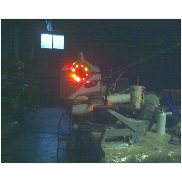

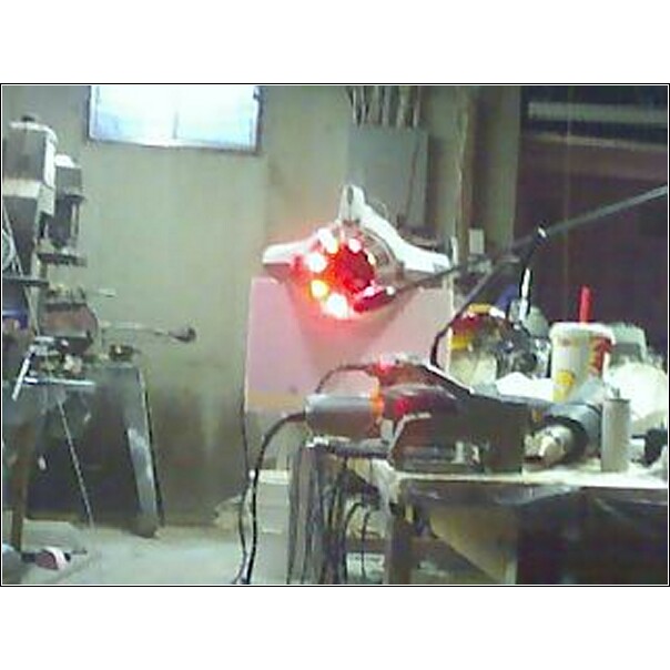

Here is my falcon.. hand made from LED's I havn't had it on with the tail pipe in yet.

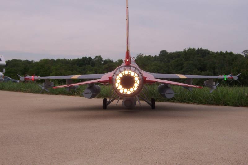

Here is real Color .
For the budget minded, I have under $5.00 in the ones I made for the F-16. Hooked into the nav lights.

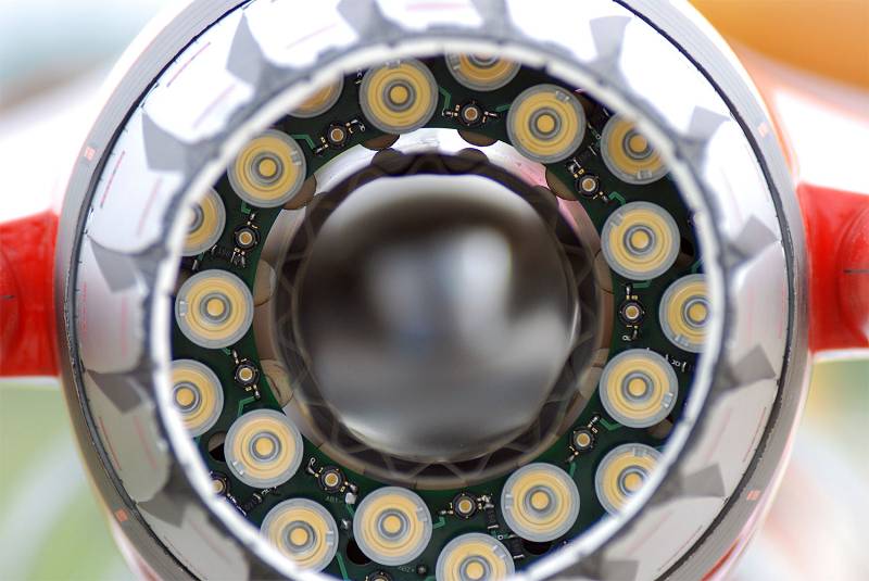

First, let me clarify.... Our AB rings are made from Super Bright SMT FlashLED bulbs, I realized I was in error earlier when I stated they where Luxeon Emitters. While most of the lighting products we carry are Luxeon, due to heat dissapation and costing, Flugmodellbau felt the could produce a better effect without the negatives by using SMT's. These rings do not generate ANY noticeable heat.
Well, as you can see from my attempts below, it is very difficult to take a picture of this AB Ring without it completely washing out the image. I had to reduce the battery to 4.8 from 6V and make some funky adjustments to the camera just to get these.
Our AB Rings use a very mild Amber bulb. In addition, the lighting module sends an intermittent current fluctuation enhancing the effect of a burning flame.
Technical info:
* Inner diameter 96mm, outer diameter 106mm
* Powersupply: 2s Lipo or 6V Nixx
* Power consumption approx. 1.2 Ampere
Pricing for the AB Rings is 199.00 although I am going to run an introductory sale on them for 179.00. Should have them up on the site shortly...
