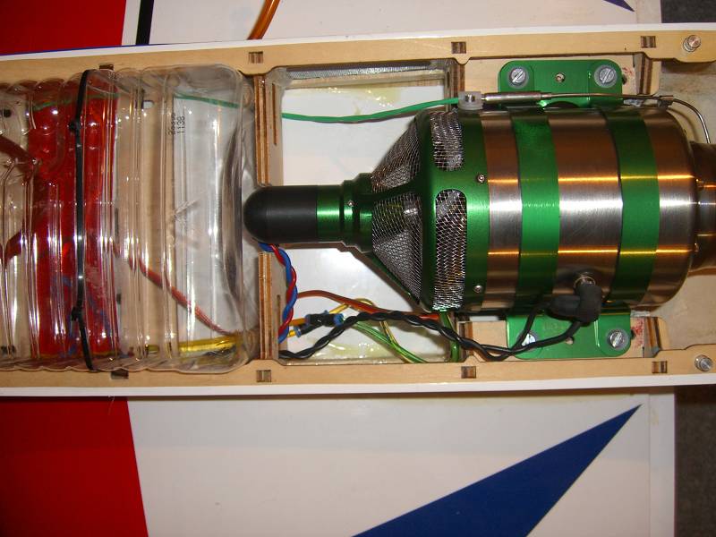

I have done the mod with the hatch to prevent hot gases. Ive included a pic, in case mine looks insufficient, but i cant see how i could restrict it further.
Oddly enough however, the hatch does seem warmer after flying than it did when i had the 54 mk2 in there.

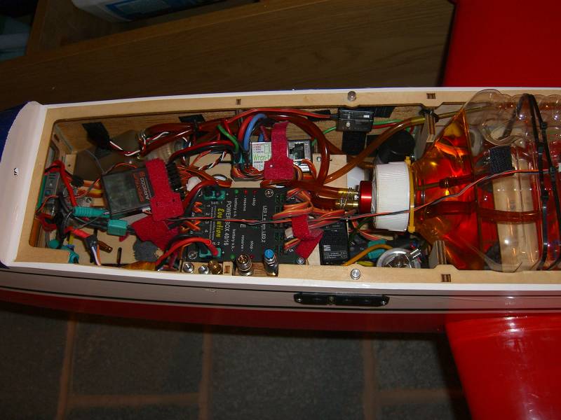

Heres some pics of my setup in case im missing something.

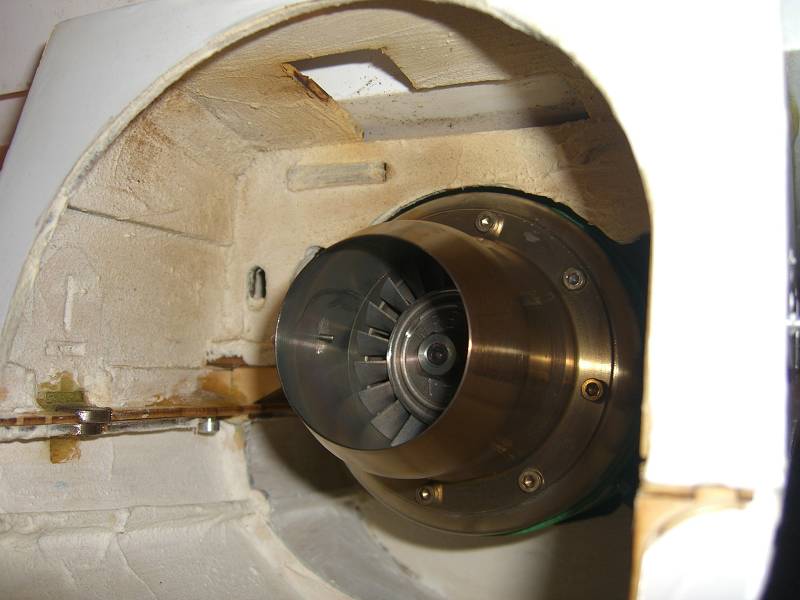

I have actually had a Wren 44 stall in a a Savex L39 (which is not TOO bad for an unducted installation,) doing tailslides. there was a sort of burping noise (from the engine !!) on throttle up and the engine would not accelerate at all. I shut it down knowing that the EGT was probably rising. The second time this happened I had enough height to idle the engine, dive the airplane to re-establish good airflow to the engine, and then slowly accelerated the engine out of the stall and after that it ran fine.
Any jet engine need a smooth or at least reasonably smooth air inlet and anything else will not help performance, in terms of thrust or operating temps. at all . The installation shown has a virtual flat wall in front of it, the rear of the tank, further compounded by a FOD screen (in itself no bad thing ) but some of these unducted installations really are awful, in fluid flow terms ! Its made worse by another flat screen former (without any holes visible to allow any air to pass through it) at the rear of the engine The turbulence of the air as it meets the engine intake must be dreadful. The temps. rise with the hatch installed are another clue that all is not well.
Please, Birdseed, dont take it personally, I am really directing my remarks at ALL such installations. "designed" totally without any real consideration for engine intake requirements , and there are a lot around but in many instances, inefficient though they are we get away with it.

I understand what youre getting at with the poor air inflow. My dilemma is partly because, and i assume, other boomer drivers are not having these slow spool up times.
It works for others so im assuming theres something different about my setup.

Jason it looks this is one of the ones that will have a surge or lack of air while flying.
my best guess is that it has not enough fresch air when flying and starts sucking in hot air while accel.
he said him self as soon he takes off , at some distance he has lack of power..
@ do you have big enough air intakes?>
the ones on the side are NOT enough.
you need to make naca ducts or screens directly above the Inlet.
RE: Wren SS spool up time gnd vs air differences
I have air intakes on top of the hatch. Quick sum, its about 50 sq cm.
