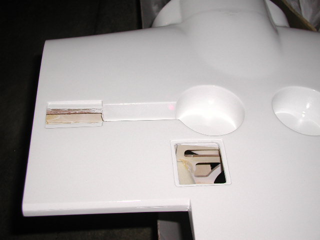

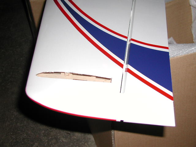

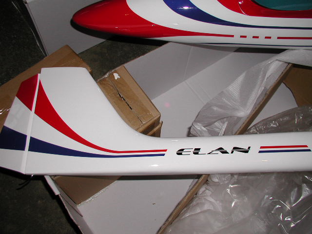

Just opened up the triple boxes and this is what I have! All looks good so far! Paint is very good and the fuse seems light or at least not heavy! Covering is excellent. All surfaces are prehinged. Nice hardware pack. Aluminum wing tube. VERY VERY nice!

Dave, you said the surfaces are pre-hinged - are they already glued in or just the slots cut?
From what I've read in other posts, the Jet-1A's & sullivan tanks are still a couple weeks away.
I thought Sandor said his retracts need a shim or minor mod done, but that piece will be included in his gear package.
From the pics, I'm shocked to see there really isn't enough lip on the cutout for many retracts to just drop in.

after this anodising will be done and the new oleo,s will be done
about the mounting:
there will be a little work , but surely not more then 10 minutes.
you do NOT have to modify the jet-1A at any time!.
you will however have to cut a bit of the thunnel away.
Alan and myself have spoken about this and be reasured it has NOTHING to do with the strenght of the model.
there will be even a small cover plate included in the kit , that will cover the opening left on the rails of the main LG.
you do NOT see anything optical
there will be also a new former , that is included with the Landing gear that needs to be glued on top of the existing 2 rails.
1 is to strenghten it more
2 is to lift the front retract by 5mm , to clear steering and a small nose up.
you can start the build even withouth the landing gear.
EDIT: added picture
you can see when we where prototyping , dont mind the oleo or pin this is for measuring only.
as you can see the retract fits perfect , just need to make some space for the cylinder and connector to the LG.
the side of the retract will be covered with a small piece of fake carbon plating.
