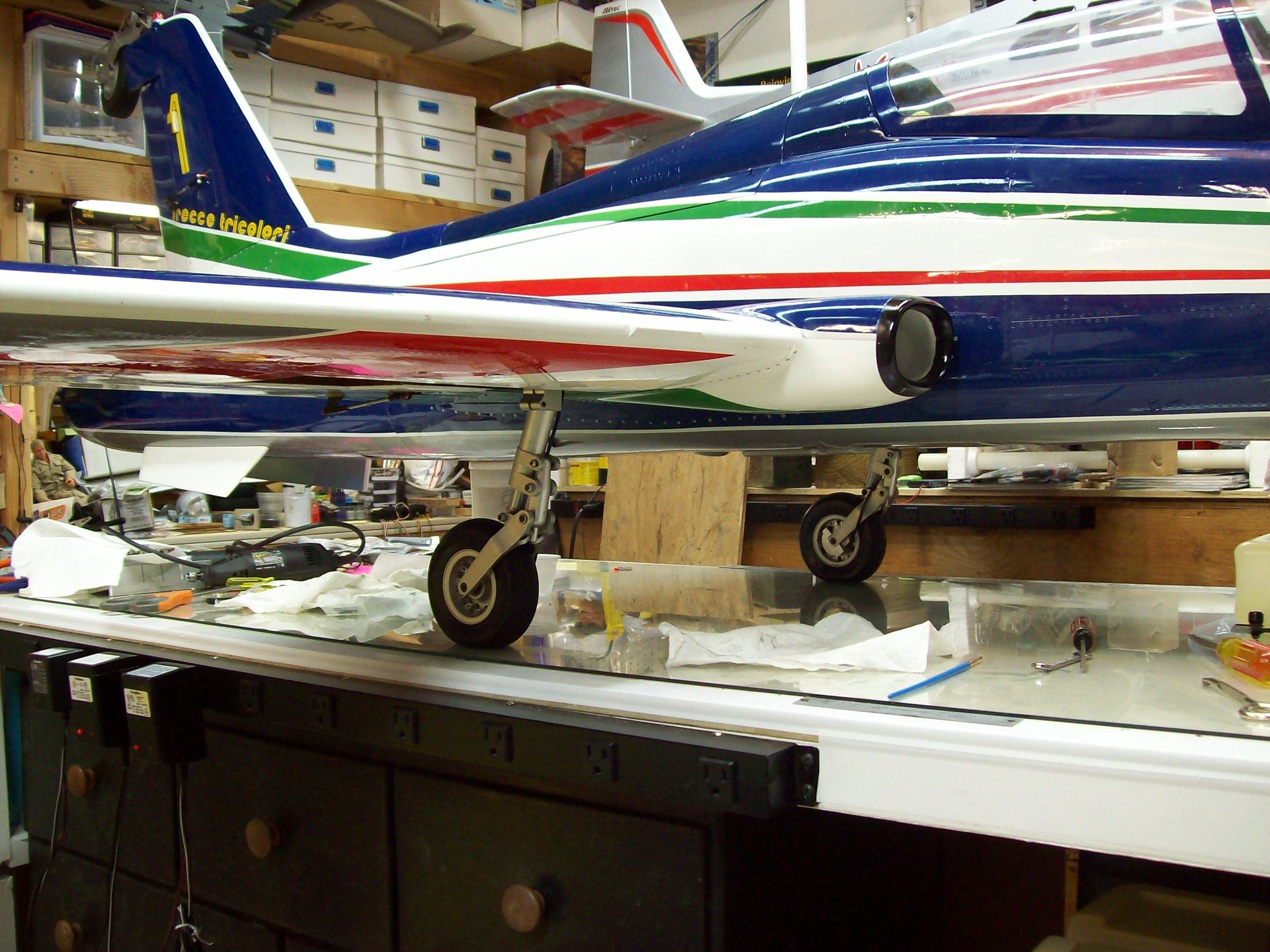

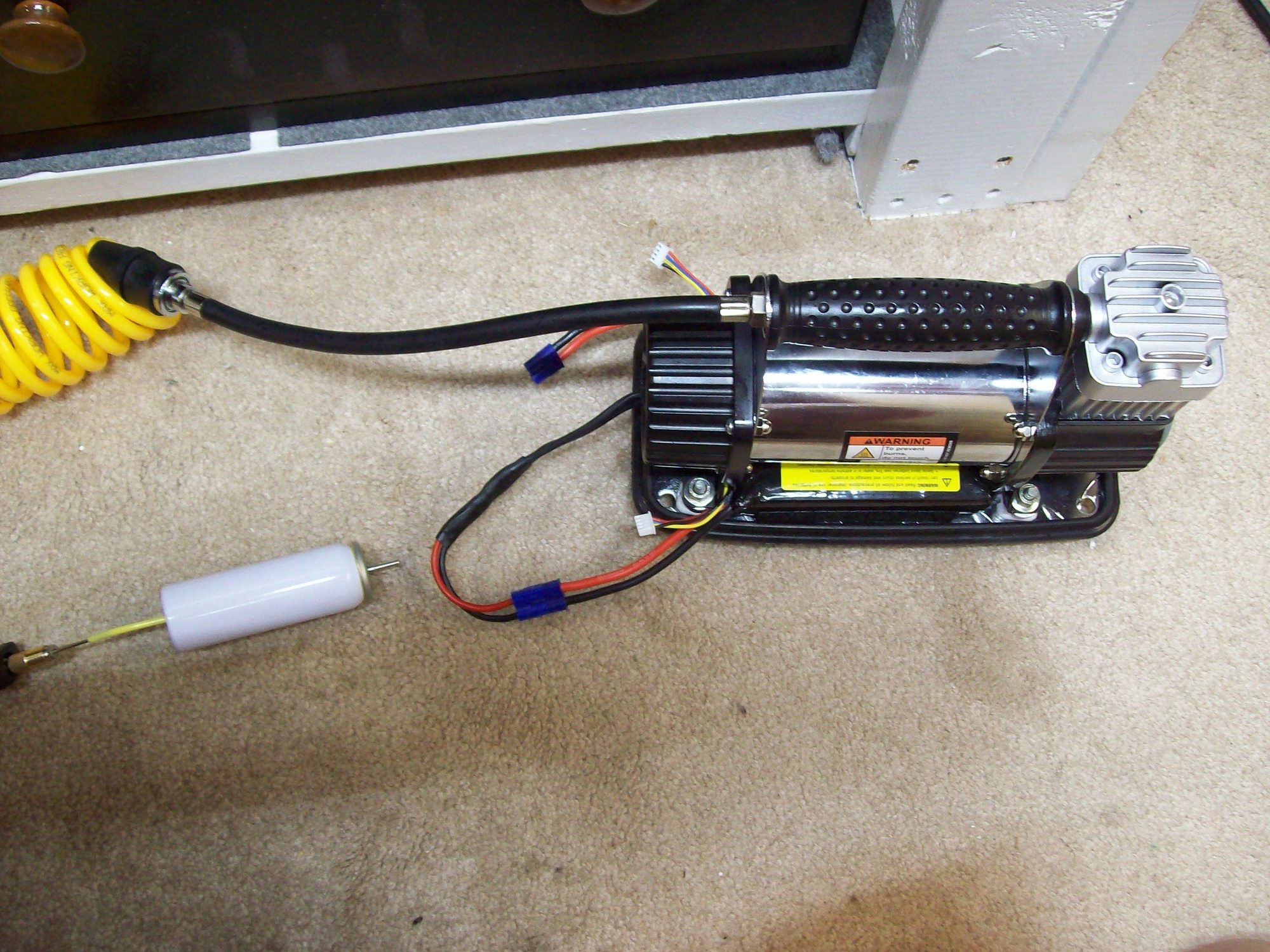

Default Landing gear help
So I have I guess made it worse.. from the last time I tried it.. lol
if I dont fix this issue then there wont be flying it tomorrow....
I have maybe takin a risk but I pressurized that small tank past 150 psi
and it still does not seem to matter I dont hear it leaking air I even
loosed the brass fitting slightly to try to force more air in.. and still didnt
help. I was able to charge the nose gear with out any issues..
works great... I am just wondering if there is enough Oil in the gear
I understand that the oil if for the bottom end of the strut working dampining
but the way I read it the air is what suppose to hold the plane up....
any ideas ???

Im using a empty propane bottle ( the one to refill lighter)

I guess I over looked the video that you speak of....
I was up late last night looking and I didnt find
a thing to help me. according to a friend of mine
I am doing it right ... what I need is an explanation
of what could be the cause or problem as to why
its not working ?
if it was a seal...at a 150psi you should hear that leak
is it possible I dont have enough OIL in the units ?
TeamMuir1 is offline

I found the video.... it was actually in the part for the MB-339...
I actually learned a little something.. so I am going to go
put it into action.. and get back and tell what my results are.

Default Sky Master Retract Service
I found the videos... and watched them twice.... and of course I was omitting a step.
so after watching the video and followed what was done mine is now fixed.
I always say.. ( knowing is half the battle )

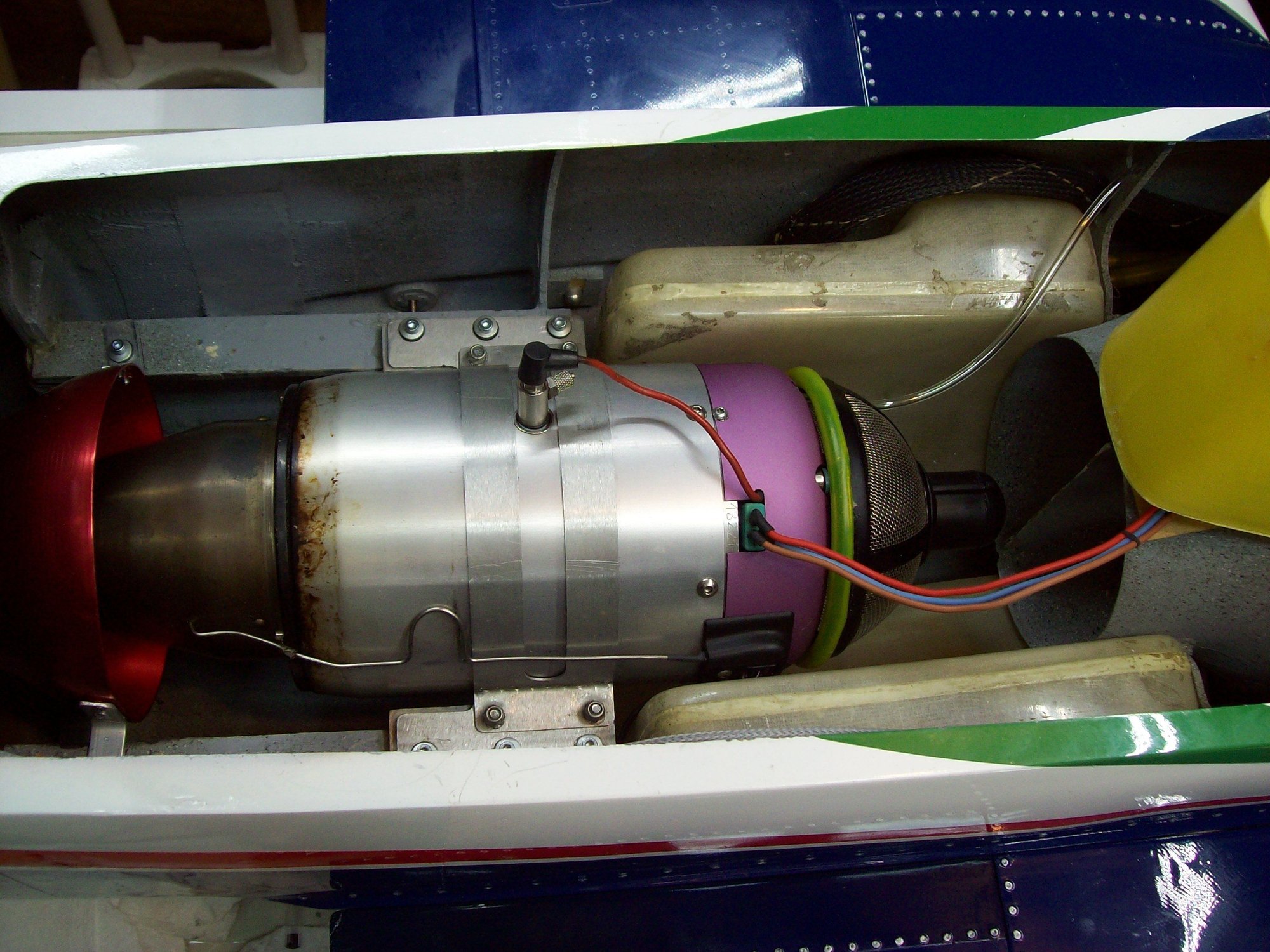

I have yet another question...check out the difference the air intakes are different
than mine.. I have noticed on this thread there are 2 different ones.. or maybe there
is the issue were mine just wasnt made that way or takin off. I will show the difference
Should I worry about not having it extended to the front of the motor?
should I make something? or just leave it alone ?

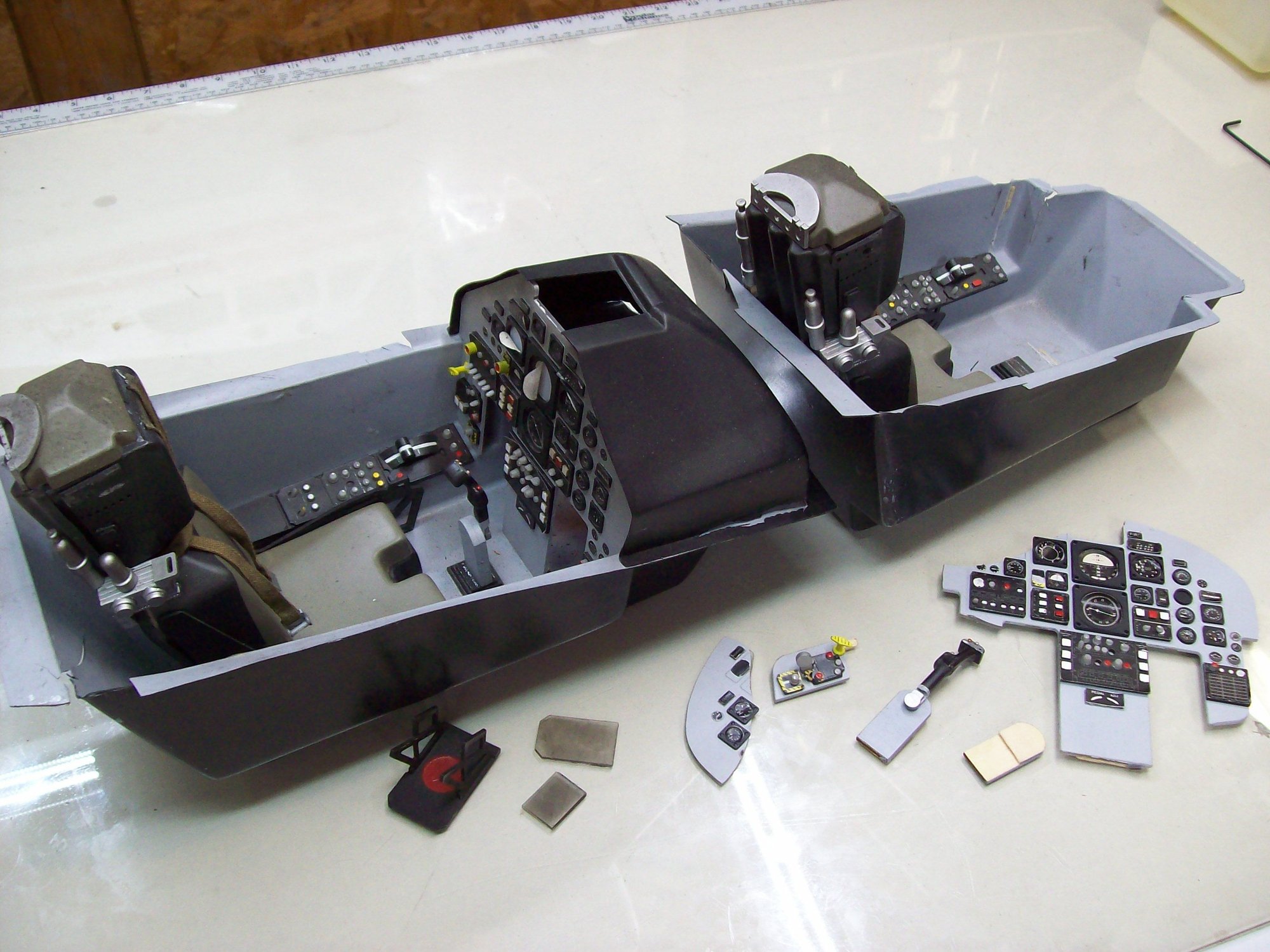

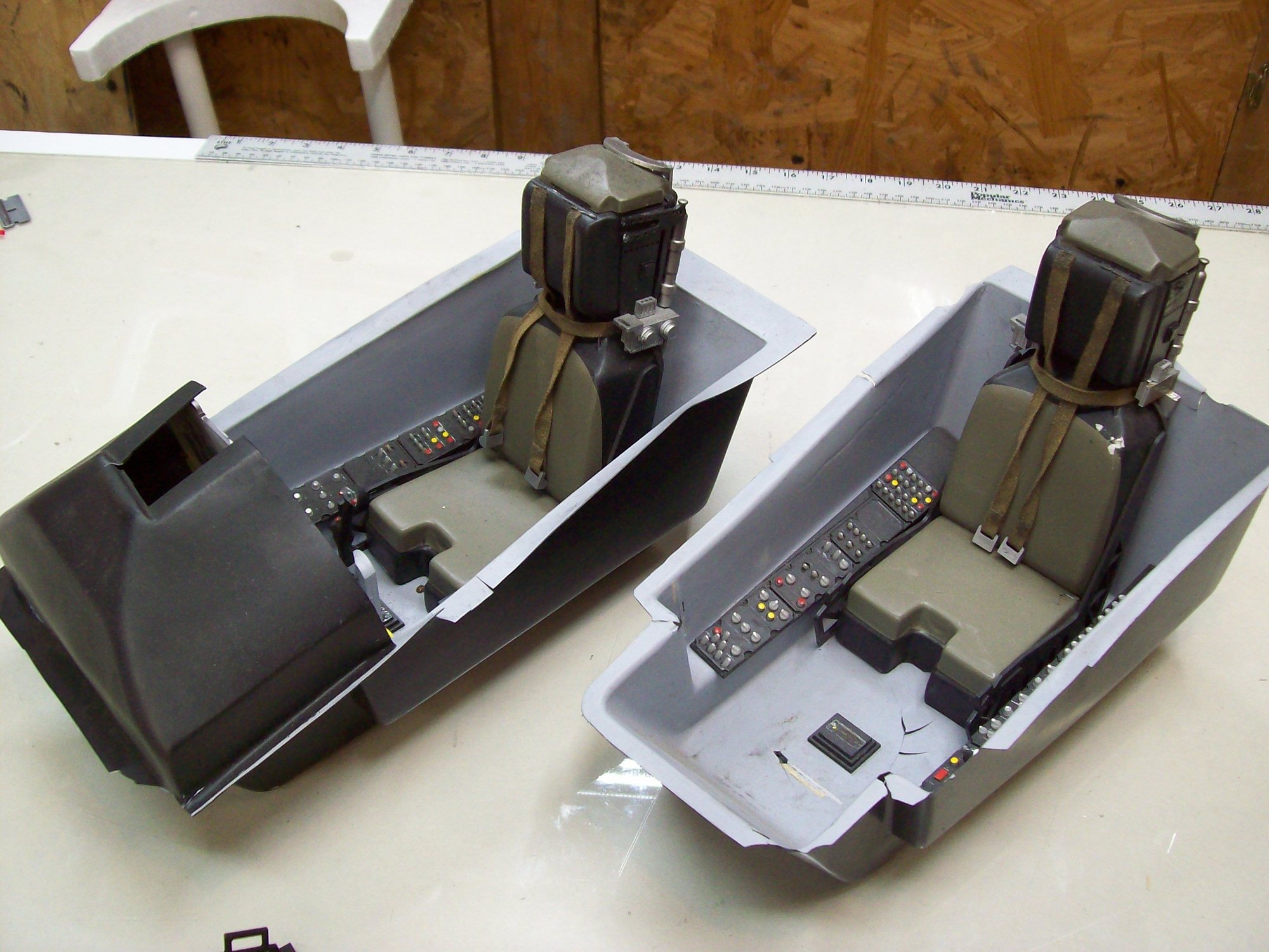

Default MB 339 Cockpits
I mentioned earlier that I bought my 339 second hand... the cockpits that came with the 339 are junk....
I am not too sure if they are worth fixing.... but I guess I am going to try and come up with something
that resembles a cockpit... I do like that pilot that I noticed earlier in the thread with the blue flight uniform
and the painted helmet that matches the frt insignia on the plane... thats cool detail.... I will have to go
back and reread that info on that pilot.
but if someone has more detailed pictures on their cockpits I would appreciate the help....
I have read some glue them to the canopy... and some didnt...not too sure what would be best...
but my cockpits are in terrible shape... wonder were that pilot was purchased at...with the blue
flight suit.

Yes the cockpits are of poor quality and the pilots are too small "scale". possibly to keep the weight down. I had to modify the tubs quite a bit to fit it all inside.
The nose gear is extended too high, look at pictures of the original, it is more "kneeling" as the supplied one does, thereby lowering the nose as You can see in ramp pictures.
The result is You need to flare the beast well, when still in the beginning I did not, and it started to bounce resulting in some damage. (Concrete RWY). Part of the problem was I had the CG too far in front, since is corrected, in stages, and now it flares like a *****.
Keep the intake tubes as is, they function well, don't need to reach the front of the engine.
However make a test you have the engine at the right place in FRONT of the thrust tube, the difference in thrust can be enormous. You need to measure the thrust with the engine in a few spots.
Which JetCat engine You have, P160, 180?
Richard

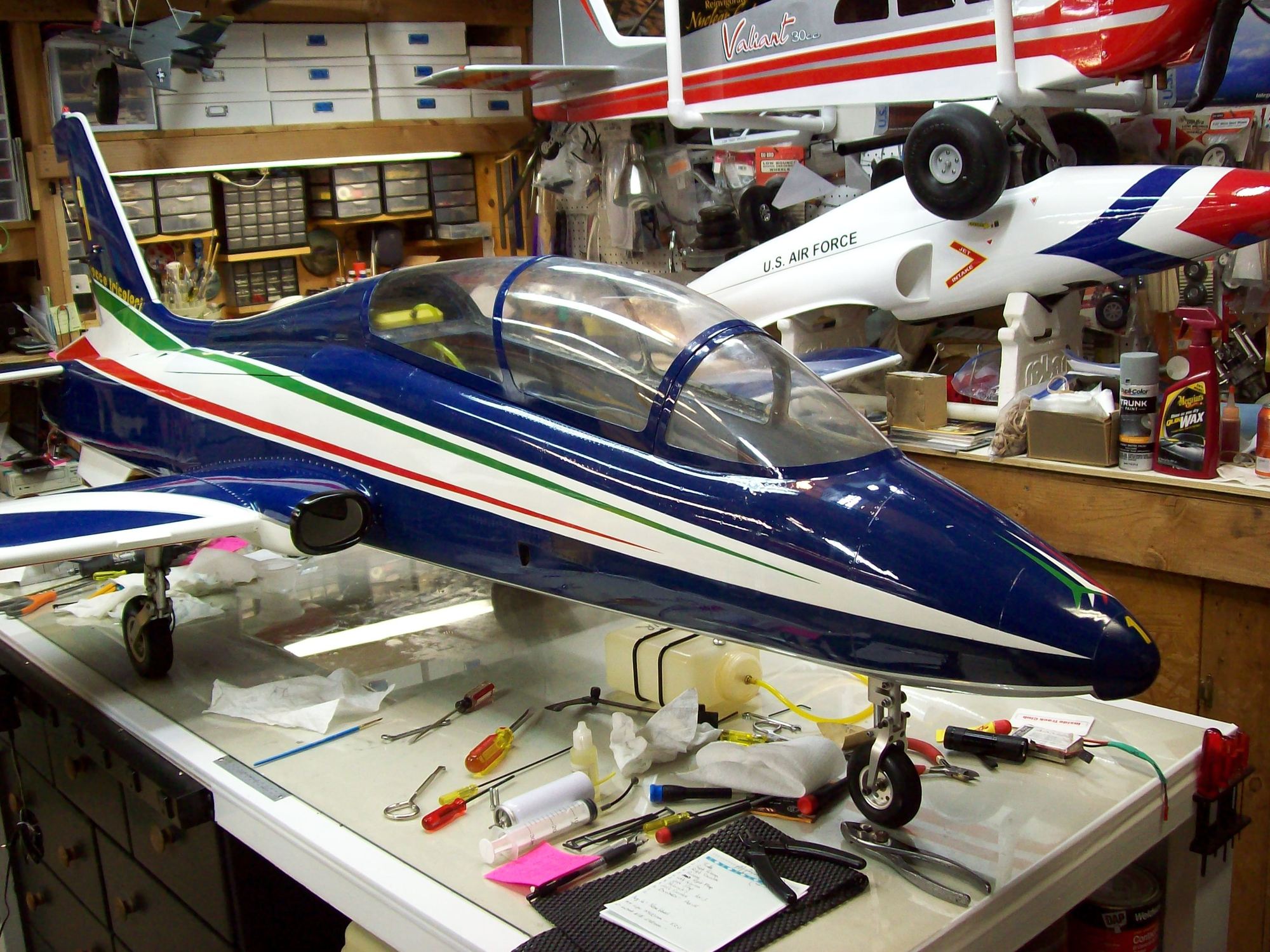

I worked more on my 339 today after work....
it took many times trial and error to get the front gear at the correct pressure to keep it up
and to be able to rebound with out it being to hard,,, it was worth it cause I dont think I could get
it any better.... Started the P-180 after that... fired up and ran what seemed to good to be true..
sure is very strong for this plane ( so it seems ) ...
I set up the Cortex Demon Pro....that seems to be working great too... so with just a little more
beautifying it will be ready to maiden ( soon )..... I however would like to maiden it with cockpits
finished.. and pilots in... but that might not happen.. I am very anxious to get this bird in the air.
I have a light kit I thought about installing.. that may come later ... If I do that light kit the top of
the rudder has what seems to be a huge red light... would I have to install one that big ?
has any one installed a light kit and would post pictures.. I would like to get an idea what
I should do....

The nose gear isn't Your problem, it is designed wrong, the full unloaded position is much too far straight. I tried it also but one would probably have to figure out some kind of maximum extended stop in order to attain something scale like ground position and I wonder it then You have any upward/backward swinging left.
The P180 is just perfect for the job, if I could I would swap my P160 for a P180 anytime. The 160 is OK, but off wet grass I could do with a little more ummmpfff.
You have probably bought the P180 used, as normally they come with an original JetCat ECU. I don't know if JetCat has a good service center in the US, You might ask what a service costs, including an ECU. In all it is an expensive bird, You have to be sure about the reliability of the engine. It is also a heavy model, so possibly dangerous, I take no shortcuts in safety.
As I live close to Germany, it is less cumbersome to send it in to the factory if I run into some problems.
The demon...I fly it w/o any stabilization, absolutely not necessary, it is a stable bird. But the Demon is a good unit, I use them in two choppers.
The red light on top of the rudder is in full size a rotating beacon (or flashing nowadays), You can buy those in several sizes, as with MANY other modellers in Europe, we install the products of Unilight.at I have chosen my own separate units, however they sell also as sets. But a full blown system would set You off a few hundred euros...Service from them is outstanding, in the past I even got answers to mails during weekends... A good 2S Lipo with minimum 2500 MaH will do..
A few contributions back at number 396's pictures one can see them in bright daylight. I have found that with less than optimum visibility they really enhance one's view on pitch and bank angle. Especially when You can only see a silhouette, not being able to recognize top from under side. A real killer flying jet models. But In good light the difference in discriminating top from under side is tremendous well because of the complete different color scheme.
But I would test fly it w/o too much work, nice to do things, can be done later.
If the CG is about right (too many modellers talk about THE CG, which is not correct, all planes have a CG RANGE), For this jet it can be easily 5-6 cm. You can adjust to Your liking as a result of test flights. As long as You will not be too far aft, nothing serious will happen.
At the backside of the range it will become more sensitive on elevator, too far in front the Elev will become "Heavy" and You will need more Elev in roundout and flare during landing. As I fly many times with my son, he prefers a slightly more aft CG position in our models, I opt mostly for a more conservative front position.
Remember the original can be flown with different tanks, fuel capacity (not all exactly in the CG), and with 1 or 2 pilots. There is not one full size airplane I know of that has ONE CG position, all have a RANGE, to be precise an "envelope".
I note You have only one air bottle installed, I use three, as I always separate the brake system from the gear. Air tubing running to the brake pads is vulnerable to get damaged, depleting the system after T/O as a worst case, right after retracting the gear. For the gear itself I use two bottles coupled together, as it uses quite a bit of air during one full cycle. I would recommend to aim for 5 cycles before the systems starts to gets too slow for comfort. I start at 8 BAR. Mine looses a bit of air during flight, cannot find the leak.
Plus I operate the ventral air brake with an air cylinder as well, which gets air pressure from the brake air system. See it extended upon landing in my 396 contrib. It extends via a mixer when I select full flap, but would I have to make a gear UP landing, I can switch the mixer off and hope for less damage. Great to extend it, the model starts to whistle!
Good luck with the first flight.

and after he looked at the nose gear assembly he made the comment that it could be fixed with a set screw
on the top side were the arm pendelem's you can adjust how the arm travels and were it stops. hhhhhmm
made some since... but I guess it wasnt in the design at the time they made the gear lol.
It took a good while to get the gear sitting were I was happy with it... its not a certain amount of PSI... its the
technique you use to get the Air in the retract... its a hit or miss thing... every ones plane weighs different.
the biggest problem I had was you have to cycle the retracts each time to get to the charge valve
so the plane has to be put together for 2 reasons.. keep the air in the system and to test your work ....
AIR TANK
I used the big Robart tank and your right I only have one.... and it will be used for retracts and brakes,
I didnt hesitate to only use one tank I can get 5 cycles with 125psi and still be able to use my brakes ...I
have the EVO JET PRO Proportional Brake Valve I dont think you can get any better than that for Air...I do
however see your point of the brake line if I were flying from a grass field. I however only fly off Pavement.

Ron I have a WREN (in another jet) and it exactly did the same, failed a few times during spinup after a prolonged time in idle. I hate that because I need to be sure it will spinup under any condition. It is currently in the UK for an inspection and service. I too fly at an airfield with 2800m at hand, so no need to worry about running out of landing surface... more like running out of eye sight
Maybe better to cut out the speed brake, if I remember correctly, the kit included some hardware, like the speed brake. One would have to make the hinges Yrself, I activate it by air pressure and a "cockpit" air valve, which has a large travel range. Supplied by https://www.modelaviationproducts.co...ion-products/7
They are from Canada, so not too difficult to get for You.
The effect of the speed brake is very well noticeable, it really works.
I noticed the engine You have is quite dirty, maybe send it in and have it serviced. That is the price if You buy 2nd hand... They might ask You to send it in including pump, wiring and valves. Better invest some money or risk the whole plane. Maybe switch to an original JetCat ECU... (not cheap though)
If it doesn't start it won't be too difficult to find the root cause.

I hope Yr cockpit tubs will fit, I see the components on the radio tray sticking up quite high.
When I did a complete reinstall a few Years ago I moved all the "service" points to the engine bay. That is, refueling, radio switch and air pressure.
Just for charging I need to remove the cockpit hood and the tubs.
I did not like to glue the back tub to the cockpit hood. I left the flanges on the tubs, and when installing them they slip UNDER the cockpit flanges of the fuse. I also glued a balsa block on the underside of the back tub so that the tub is pressed upwards against the fuse's cockpit flanges.
Then I tape them fixed with a few strips of black duct tape, hardly noticeable.
But again, I rate the cockpit design as awful. Fitting the front instrument panel was a disaster, as it needs to be removable to be able to work in the front of the fuse. I had to use Velcro to get it done and even removed some parts of the front tub so I could slide it under the instrument panel..
