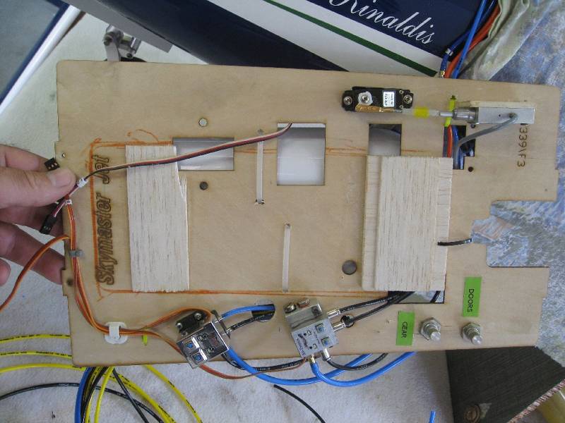

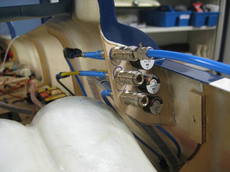

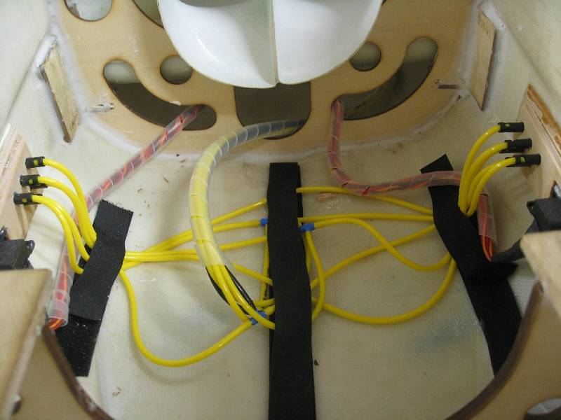

I went on with the systems , focusing on the pneumatics. Gear was mounted, no big deal although some work on the bearers had to be done (not enough clearance). The gear operates now as advertised, I have to figure out however to limit the downspeed (it slams down). Already installed a FESTO flow limiter in the wasted air line, but basically You can optimise the speed in only ONE direction...
I included some pics of the engine bay taken from behind. The QD conn's reach some 2cm into the fuse, and the tubing has to bend downward quite steeply, tight fit, but I got it working. Festo line will knick here, I use UP line for these purposes.

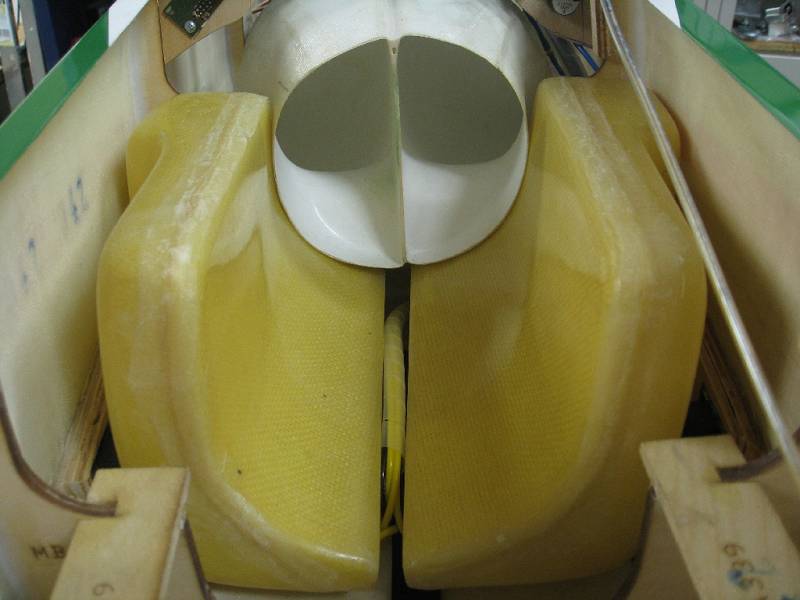

Test fitted the tanks, intake air duct and engine bottom duct, all seem to fit OK.
Oh, I elected the engine bay as service bay, I am working on getting it accessible for all systems, so I made small formers to take up the air refill conn's plus press indicators and the other side houses the Weatronic socket. I will make side panels for bat recharging etc. Did not want to have the cockpit area for all of this, too complex to open it every time.
Still lotsa work to be done....

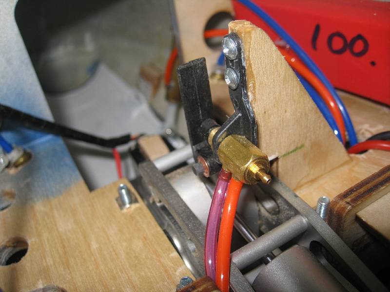

There are several ways to operate the gear/door mechanism, that determines also the way the small doors open.
Each system has its pre- and cons. I chose a system based on 2 X (jettronics) electric valves, one for the doors, one for the gear.
For the 2 small nose doors I used a BVM mechanical pneumatic switch. That is, the nose strut operates a switch that can open or close a pneumatic valve.
Setup is that both small doors get OPEN pressure from the GEAR system when selected gear DOWN. They open then simultaneously with the (nose) gear.
Same for doors CLOSE, it will get get pressure from the gear UP line, however, the pressure cannot reach the doors yet, as it is blocked by the switch.
As soon as the nose strut is almost retracted, it contacts the switch and lets pressure go to the doors.
Sounds simple, but got me a while off the street to figure it all out!'

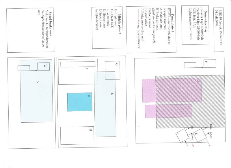

Btw my friend Leo who builds another MB went up the route with mechanical valves, he uses the UP4/UP2 combo.
Together with Leo we drew the setup in a worddoc, here is a scan, I don't know if it will readable, I could not upload a worddoc. If needed I can send it by email.

I made a few pics of the nosegear actuated switch, one is with the nosegear down, one half way and one fully retracted, thereby compressing the lever. I used the backside of the steering servo with a small block to actuate it. For the switch itself I made a bracket that supports it.
Also hooked up another file of the scan sideways, hopefully it will be better.

Now that I figured out which air source to use for the OPEN and CLOSE position of the small doors, setting up the system as I did does not involve a lot of work, just making a bracket for the air switch is most of the work and it works flawlessly. Btw, the air switch is even not very expensive: BVM #5753 $27.50
When installing it, just be sure NOT to contact the backside of the servo yet, make the final adjustment by means of the small wooden block which is glued to the servo.

Here my last updates, tanks are fitted with a bracket as earlier in this thread. Had to ream out the holes where the tank fittings stick through. Both to the inboard and top side.
Top tank fitting was too tight, had to file back the flanges of the fuse and engine bay cover.
Plus pic of the bottom of engine bay where pneumatic tubes run and electrics from the wing, YES, I like VELCRO tape!
Note the high tech balsa blocks , they serve as bottom rests for the tanks.
When installing them finally I will put a dab of silicon kit on those, plus the side that almost contacts the fuse sides.

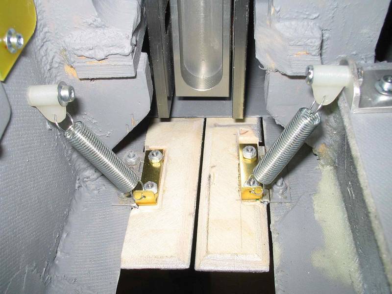

Guys not that it may be possible to use but this was the door system used on the one I built recently for a customer....
marc
marc
Thanks Marc for the idea. I had a spring setup to hold the doors but I could not find a way to actuate the doors via the strut in the up position. The servo tray is getting in the way so I decided to go the button valve and cylinder route.

We ran into the same problem, part of the front equipment plate cannot be used for component placement as the bottom of the front cockpit almost touches it. In fact by gluing small strips of balsa on it, I use it as a bottom support for the cockpit pan itself.
BTW, I guess the pans can be installed in several ways.
The broad flanges on the pans look as if they have to be mounted in BETWEEN the cockpit hood and the fuselage, but that results in far from perfect fitting of the hood itself.
I trimmed down the flanges and now they slip UNDER the flanges of the fuse. This requires some jiggling but is OK to do once in a while, but will be a pain when have to be done for every flight,

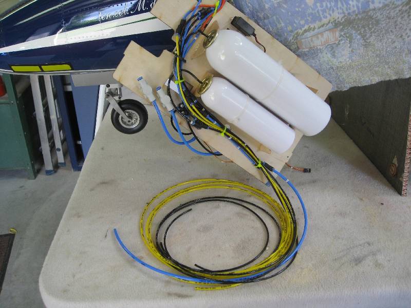

so I elected to have regular access to all systems, like refuelling, charging and pumping air via the engine bay.
Here is a sced of the plates plus some pics of how I installed my systems. Sced is rotated to its side for better readability, after printing it.

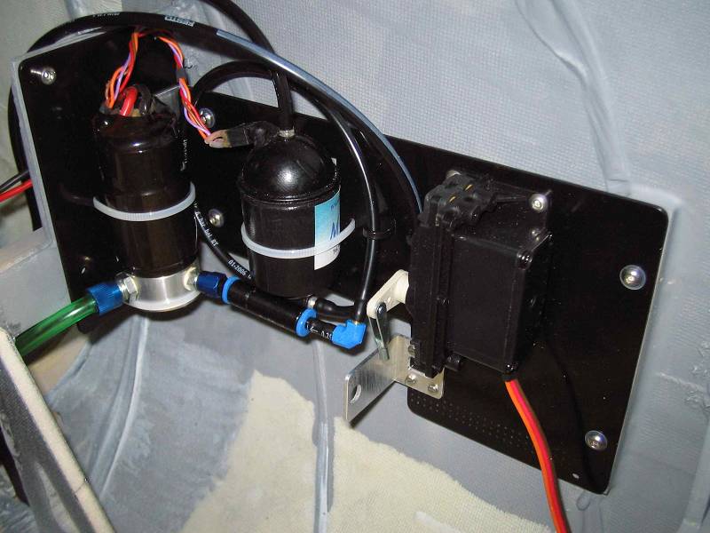

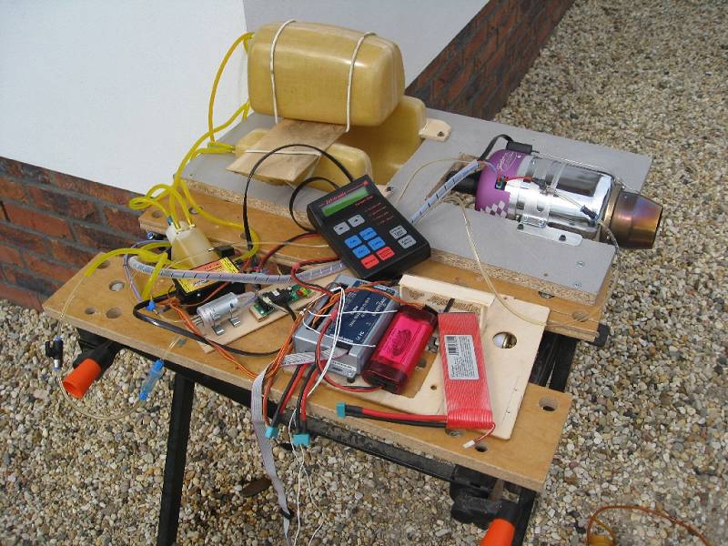

Did a few things today, finally completed my teststand for the engine and did some testruns. This is my first new type (P160) engine with fast accel. Holy moly!
Had an air leak though, had my FESTO ball shutoff valve at the refuelling side connected to that blue festo airline, obviously does not match very well, as it leaked fuel and air. After I changed it to the clear tubing that comes with the JC, all OK.
If You look clearly You will notice the old type NC engine battery. The Lipo is already built into the airframe...

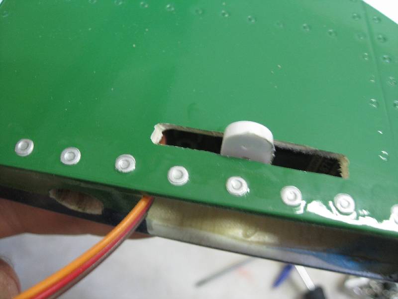

Also started at the tailplanes. Here is how I did the servo mounting.
I used the alu brackets that comes with the kit, screwed them (with sunken head M3 screws) to a 3mm plywood plate and glued that onto the bottom of the stabiliser. The opening in the stab for the servo needs only little to be widened top and bottom side.
I already bought larger servo horns, but I see that that I need even longer ones.
Hmmm, my shopping list for JetPower next weekend is GROWING...

Neat solution, what in earth is that all You've built in? I don't recognize some parts at all.
I am going to use the side walls in the engine bay as well, in order to have all servicing accessible from there.
Good idea to paint the inside of the fuse, looks very pro.
Btw, I have defuelled the system after the testrun and a full fuel system holds around 5,5 litres, including the hopper.
