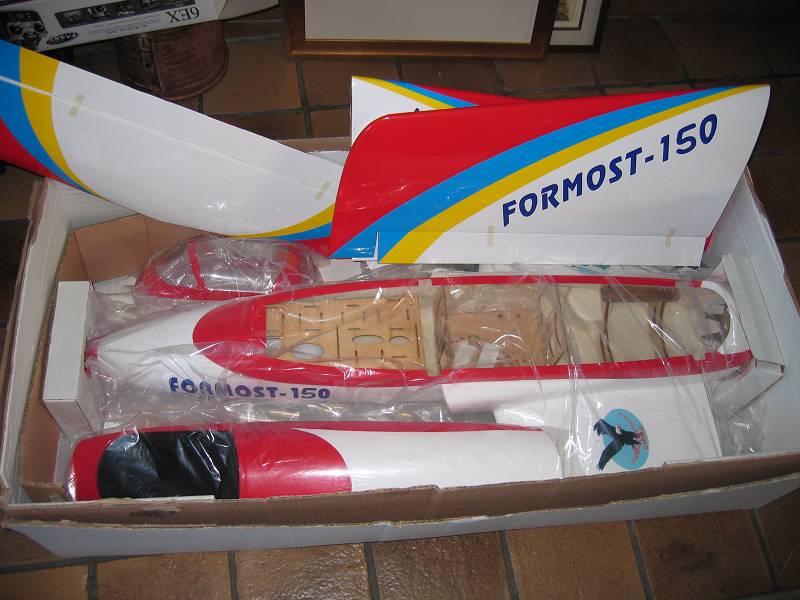

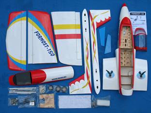

Opening the box
Everything was well packed, the outer box was packed once again in another box. No damages whatsover.
Fuselage and tailbooms are fiberglass, wings and stab are balsa+plywood construction.
No special remarks here. Fiberglass work is done in 'Speedy Gonzales' style in China, but I assume nobody wants to take this one to a world masters competition anyway.
All (lasercut) formers are installed, some perhaps a bit flimsy, but sufficient.
What I liked is that the main tray is removable by four bolts.

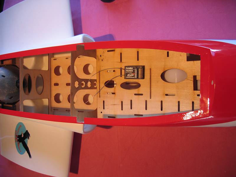

Available space.
It is obvious you'll have plenty of space to do anything you want inside the fuselage, the available space is really big and without any doubt you can install here at least 4 liters of fuel.
There is a fuel tank included, but for turbines this one is good for the bin (too small volume : 550cc). The manual speaks about 150-180 two stroke engine with a pusher prop
I placed a Futaba R606FS FASST receiver on the tray to give an idea of dimensions.
Just been checking some options with some available tanks. Here two Sullivan BT-32 (32 ounce fuel tanks / about 960cc each) placed horizontally and vertically. No problem.
Even two tanks of 2 liters must be possible to do, by moving one bulkhead.

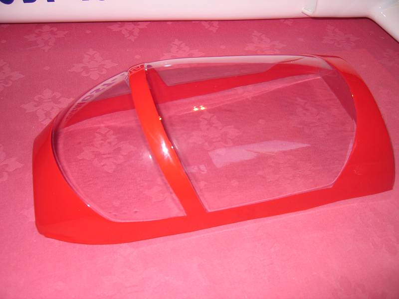

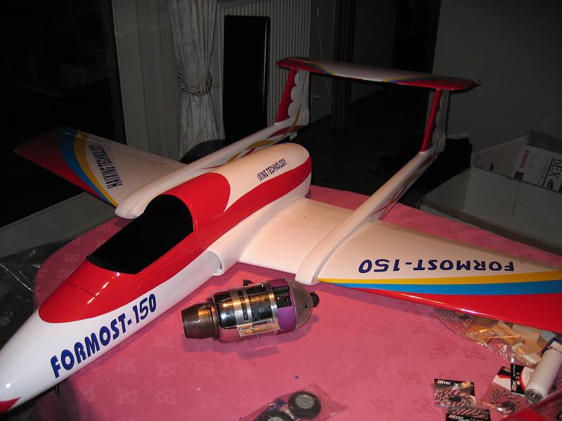

General first impression
This is absolutely stunning value for money !

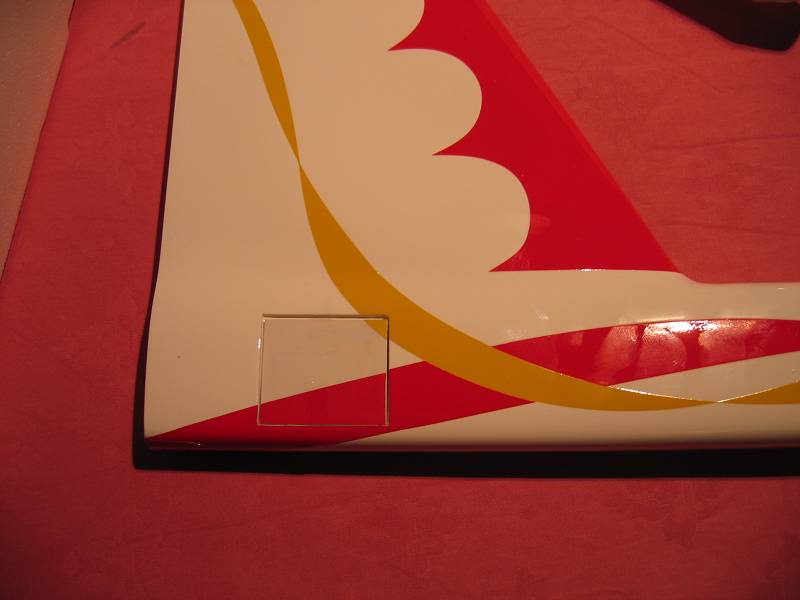

Only two things I did not like at first glance : the awful shape of the canopy (looks like a WW1 canopy, not like a modern jet) and the horrible decals (the two eagles on the wings plus the "formost-150" and "Haixing Technology" cut-out lettering. However, I removed one already and it is very easy to do !
The sticker adhesive can be without any doubt be easily removed with cellulose paint thinner.

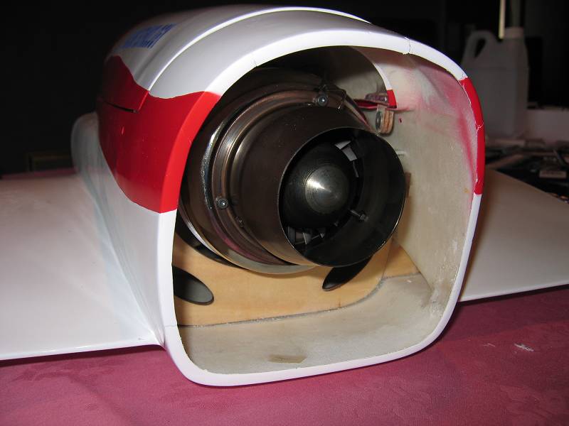

Turbine choice ?
This is the big first question.
Frankly speaking, I have no experience myself with this type of jet.
All I can say for now is that this one will be VERY light and a rocketship if you overpower it.
I have a JetCat P-160 (of my JL L-39) on hand and a SimJet 1200 with 8 kgrs of thrust (coming next weekend), and although I have no doubt you CAN install the P-160, you MUST downrate it to some 8 kgrs thrust max or all structural limits will be reached very fast.
Now I have this kit in my hands, I am absolutely sure that even a P-120 is a dangerous choice.
Nevertheless, just to see how it would look like with a P-160, I dropped in this turbine for the photos.
A jet pilot from Singapore told me in the shop they take off with the Formost 150 with a JetCat P-80 at about half throttle on tarmac runways.
Therefore, I will go for the SimJet 1200 and benefit the light weight of this turbine choice as well, and install 2x 32 ounce tanks + a Digitech UAT.

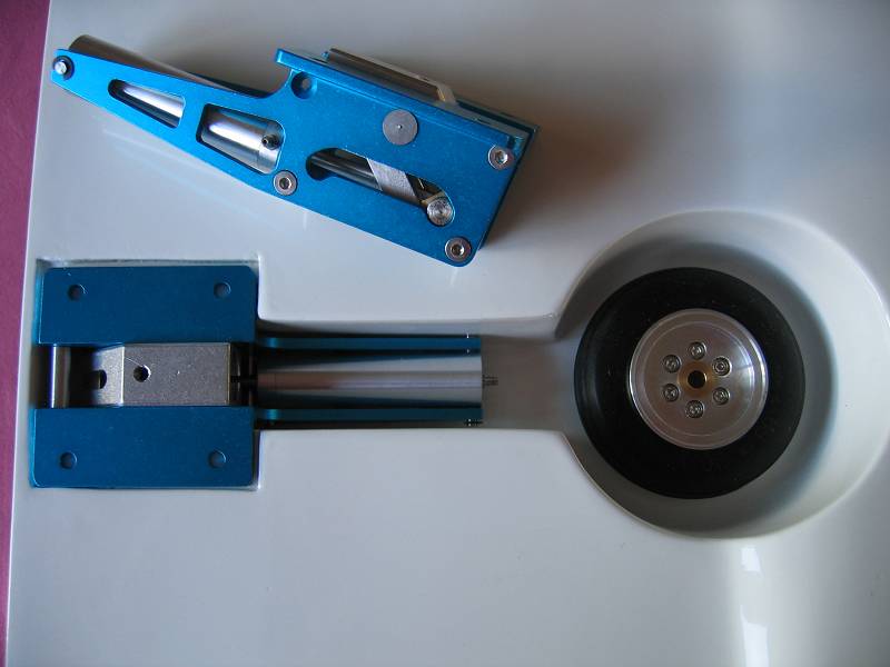

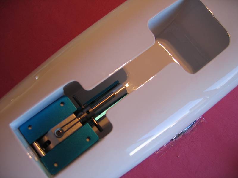

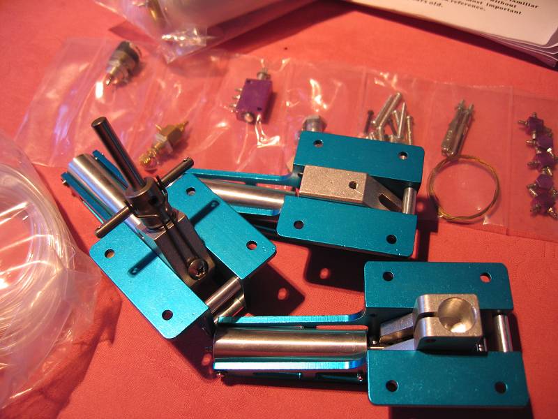

Retracts.
While the kit itself was an impulsive but generous gift from my Boss ; however she ignored my most gentle but sincere interest for some nice retracts.
In the kit is some sort of fix landing gear set-up although all openings and covers are installed ; it is obvious this plane cries for retracts.
As the retracts on hand in the shop where really an astonishing drop fit without any modification needed at all. These were of excellent machining quality as well.
I took those in my luggage too, together with some nice jet wheels in the same size as the cheap plastic wheels provided in the kit.
However, these wheels do not have wheel brakes. This is no problem since I fly from grass field only and will keep this plane as simple and maintenance free as possible.
Jet with wheel brakes is not an obligation in my country.
Most likely, I will install the Jet 1A oleo struts, available strut dimensions permitting. still have to check it with Digitech.
For those interested, the references are :
Excellence EX1319 "120 Class & Above Air retract set" (about 150 euro for the complete landing gear set except struts)
Excellence HY006-01402 "Jet Wheel w Alloy Hub D64x H20mm 2.5inch" (Main wheel)
Excellence HY006-01401 "Jet Wheel w Alloy Hub D57 x H20mm 2.25inch (Nose wheel)

EX1318 is the 60-120 version, which looks exactly like the one being sold on HobbyCity.
I guess you bought the same brand, but the larger size model ?

For the retracts, I think that Digitech will have a complete Jet 1A plug&play set soon, once it is clear what the dimensions are for this kit...

Just opened one servo hatch to peek what this kit has on offer.
Inside frame of the fiberglass fuselage is reinforced with a plywood frame, preinstalled.
No servo mounts in this kit.
Nicolas.
Nicolas.

Wing tubes, booms, wings, stab, everything slides together very nicely.
Chris, bring your Futaba 12FG FASST Mode 2. We'll fly it Saturday afternoon together if you pass me the turbine on Thursday evening when you arrive.
Nicolas.

ORIGINAL: SpiderJets
Sandor,
Do you have Jet A1 oleos with following dimensions ?
Mains : pivot block 1/2" - length from pivot block to wheel axle : 122 mm (minimum : 114 / max : 128 mm) - axle diameter : 4,90mm (=brass bushings) - wheel axle length : 24 mm.
Nose : pivot axle : 6 mm / wheel axle : 4,90 mm (= wheel brass bushings) - length strut : same as mains or longer (max 20mm)
Nicolas.
Sandor,
Nicolas.
yes we do have those oleo,s , i think the Kingcat are a bit overkill.
but i got other things also
also i do have those retracts , you showed but for the "Formost"they are a but weak if you aks me
UH in hk sells those
i have a better idea
why dont you and mr cyprus get in the car visit me bring your model , we set it up on its legs , after that we will have a good dinner on my expense.. (good steakhouse)
or we go to a good greek..
Join Date: Jul 2004
Location: Bendigo, AUSTRALIA
Posts: 34
We have a order of kits on there way to us in Australia with more to follow in March.
From what I have seen I think a P-80 size would be the max as going for a bigger size you will have the extra idle thrust.
I will be installing a PST600 in our first kit but I do have a P-80 in the box so I will put that in after I see how the 600 goes.
Pete
Pete
