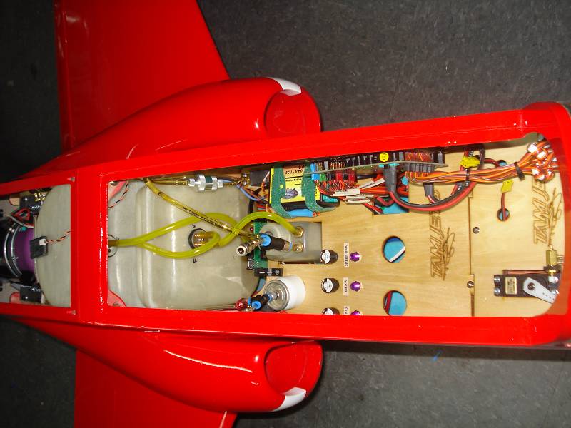

I would recommend the Powerbox in any aircraft that it will fit. It is a great way to get redundancy. I have used them in all my planes. Here's where I mounted it in the FB hawk. I mounted it to the side of the fuse.

Hey Billy; I noticed you have one of the Rx's on top of the fuel tank. There was an earlier thread about the possibility of Kero blocking the 2.4 signal, any opinions?
