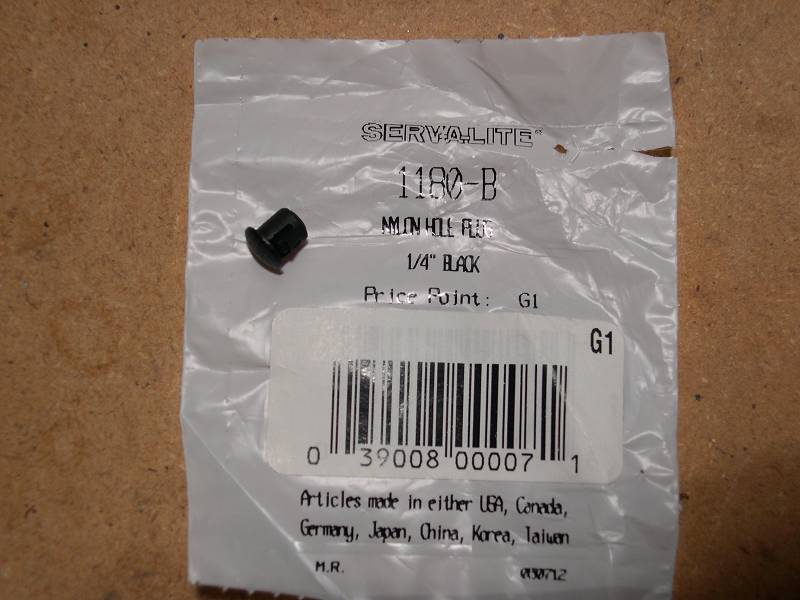

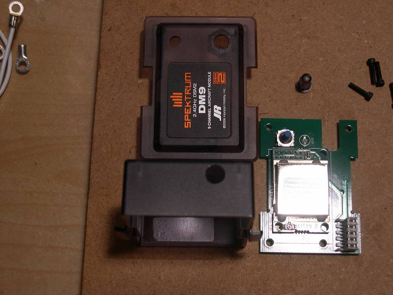

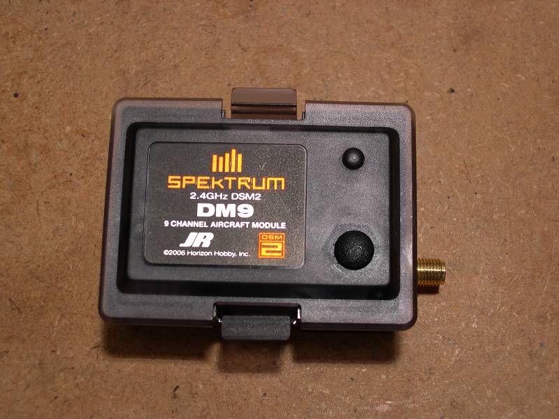

I have been staring at the back of my 10X with the Spektrum module sticking out the back for way too long now, it was time for them to permanently join together and do away with the important thingy sticking out the back that had to be bolted on prior to each day of flying and unbolted to put back in the case and could be wacked real easily if the transmitter tipped over on its back. I pretty much decided that I was never going to fly anything non 2.4 ever again, so why not modify my 10X to do just that.
First I had to relocate the external jack in the module so that it could be all internal when installed in my 10X. Orchard Supply Hardware has a really nice selection of plastic plugs, and got one to fit perfect in the existing hole.

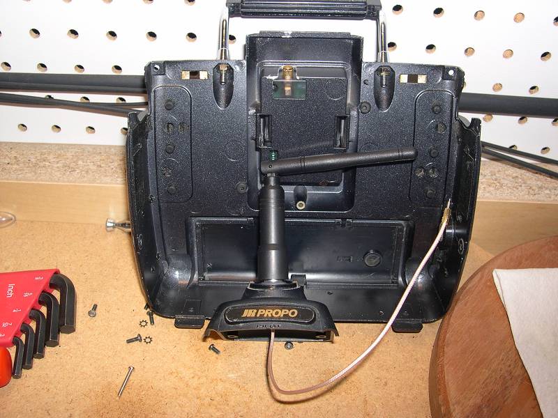

re routed the antenna internally

had to relieve some of the aluminum in the transmitter case for the new location of the antenna attachment.

Dave,
Can you expand a little more how you ran the antena down the inside of the mast? What did you do to the 90degree connector?

ORIGINAL: Jerry Kirwan
Dave,
Jerry
Jerry there is a flat head screw on the 90deg connector, unscrew this cap and it exposes the connection. Unsolder and pull out. There is a brass crimp connection that holds the wire to the 90deg connector right where it goes in, there is no way to get that out without breaking the brass. After you run the wire and are ready to re connect with the 90deg connector, you will be able to re solder this at the same time.
