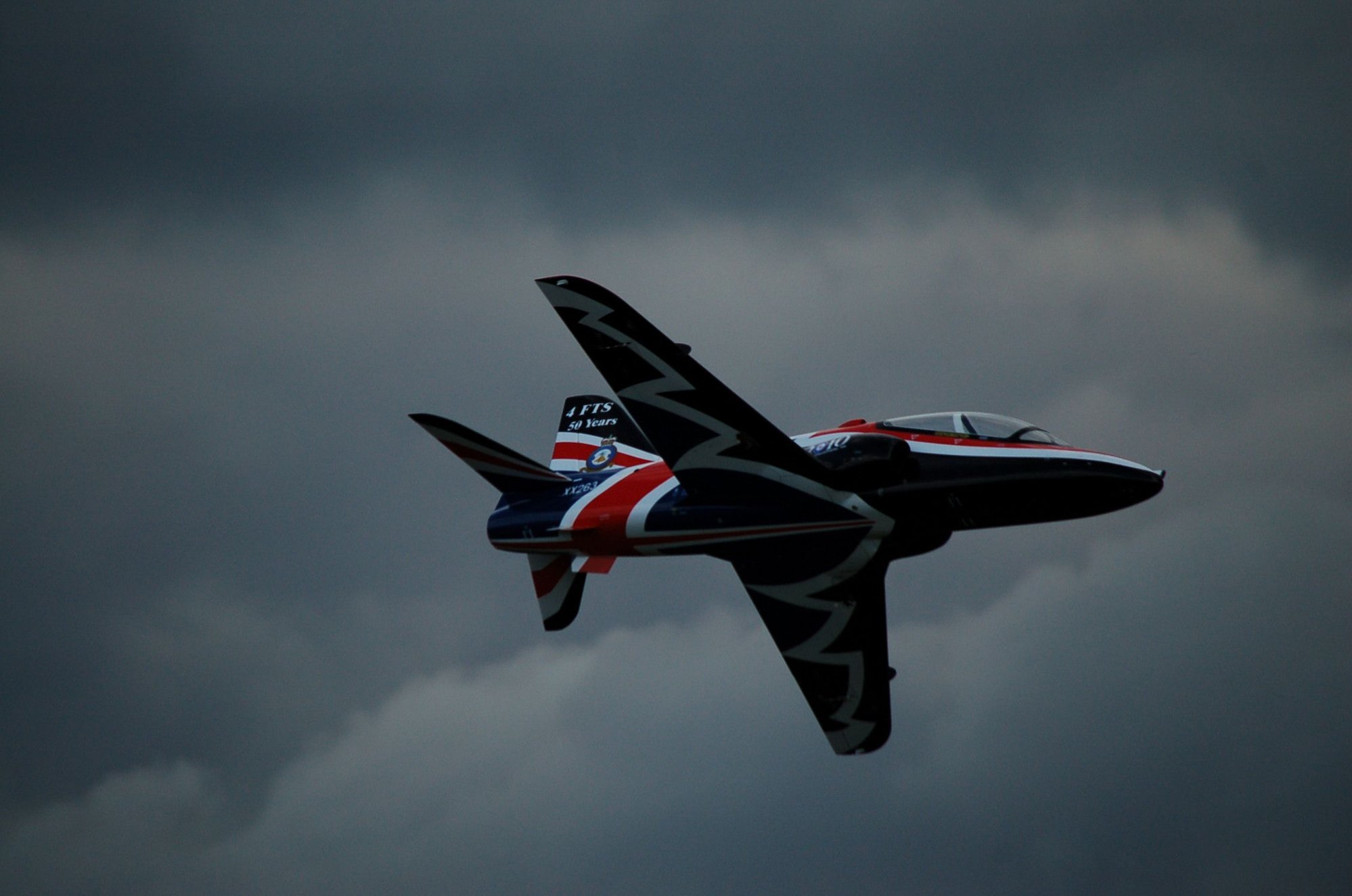

Another CARF Hawk weekend at our JMA event. I've spent 2019 fighting the bad balance brigade, you would not believe the number of people flying nose heavy models...and really not getting the best from their craft. This weekend there were two Hawk's flying and just watching the way they flew I could see they were noseheavy. So I set about moving batteries and adding lead to the tail to get them right.
Both these models are 140 powered.
Dave Wilshere is online now

Second to that! I wasn't very impressed about my first flights because of forward CG. Hawk wanted to loop with power and it just didn't go straight at all. I hate that.
Move CG back and maybe reduce elevator movement for your taste and it'll go straight with every throttle setting, continue climbing or stay in line on dive. One handed knife-edge. Throttle only for controlling speed and pure surfaces with almost no coupling on every other direction!
I'm not big fan of air brakes and retracts anymore because of maintenance but now we have good option for those. Too bad Electrons are not drop in fit to my knowledge. Does anyone have installation pics about Electrons in main wheels? I might even upgrade to electrics. Also considering assymmetric elevator travel to get more of it on negative G manouvers.
/Jyri

Love the 2010 scheme! Maybe because I have one? Funny how at most events I see that scheme on a lot of planes but I'm the only one with a Hawk!
Maybe people are afraid to get the CG too far back? I have found the Hawk to be pretty sensitive to small changes once you get into the "perfect CG" range.
I have do have a small throttle to elevator mix, down elevator above 1/2 throttle. On my Hawk if I was doing a flyby at low power and pushed up the throttle the nose would come up before the airspeed increased. This indicated a thrust line related effect. Dave addressed that by blocking the turbine mount and I had done that. So a small elevator correction keeps the nose from coming up on acceleration or dropping on deceleration my jet.
With a BVM 1/6 F-16, SM Cougar, and the CARF Hawk in my hangar, all propelled by JC Cheetah's, if I really want to throw down some aggressive flying the Hawk is my go to! Knife edge could not be better and it snaps like a pattern plane. I agree the elevator is less powerful in outside maneuvers, not sure I want to "press to test" by increasing travel though.
I recently went through a worrisome stretch when I could not source gear parts for the original Airtech gear. So it might be wise for anyone planning on flying their Hawk into the future to grab a set of main gear springs and tires while they are still available. It may not apply so much to grass flyers but here in California I fly off rough old runways and the surface eats tires, plus a hard landing or bounce will stretch the springs. If you notice your Hawk is sitting wing on the ground the only solution is a new spring, or a set of new springs.
