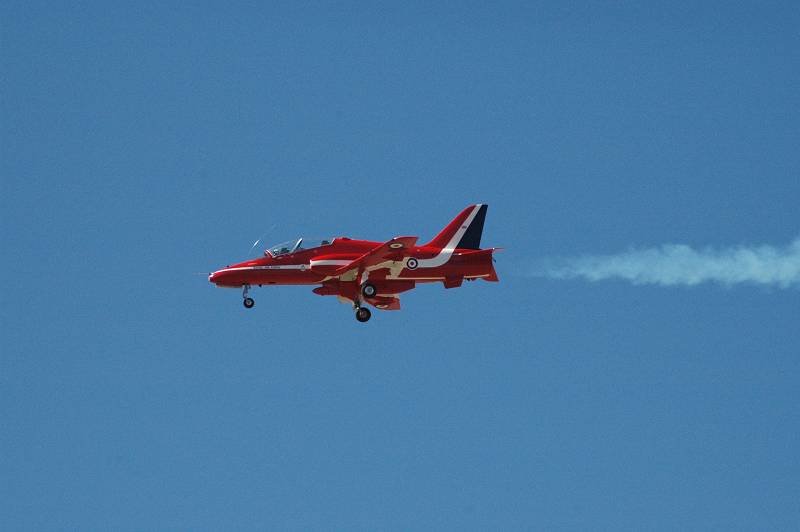

We did quite an extensive article in RCJI about 18 months ago on gyro theory and practice, its all there !
Here a picture of a gyro in action!
