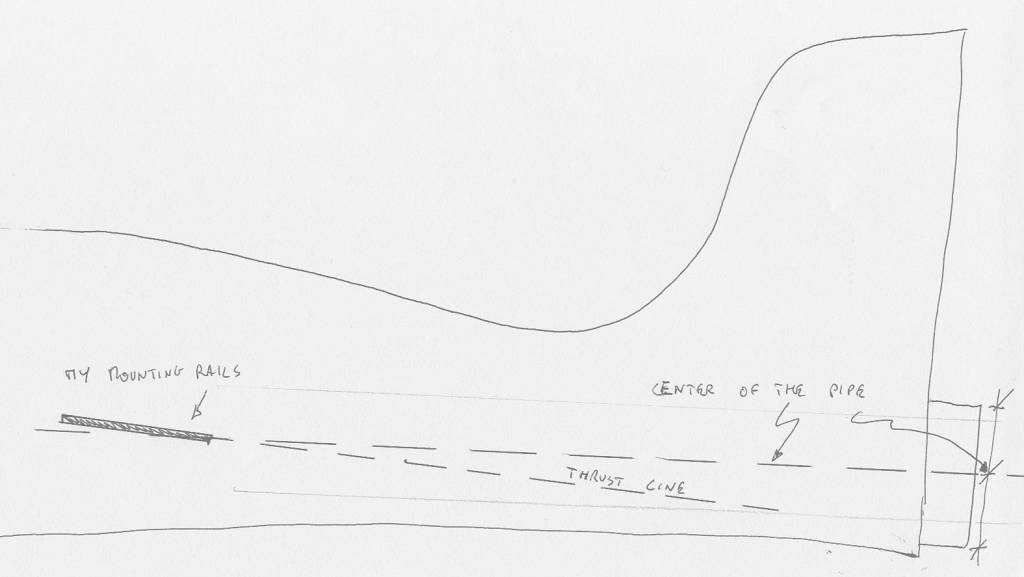

@Alessandro,
don't use those shims. Keep the turbine in parallel with the mounting rails, and align it with the pipe only.
I've talked with a lot of people about this, some with lots of viper experience
The intake seems to be off-center, thrustline with the rails and pipe in one line is ok and inline.

Besides the problem of the thrust line another problem could be the heating of the tube. With the incidence of my mounting rails of the turbine the bottom of the tube will be much more hot the top and we are speaking about many degrees... am I becoming paranoid? [&:]
Alessandro

Mount the turbine to the rails as they are supplied. Then line the tube up to the turbine ( Straight ) All is fine. The heat is distributed evenly down the pipe ( Dont worry this is no fry eagle pipe ) There is no pitch change with power. I know it looks strange but all of the Vipers are like this and all work perfectly.
Regards Al

I've done a scheme... terrible!
A

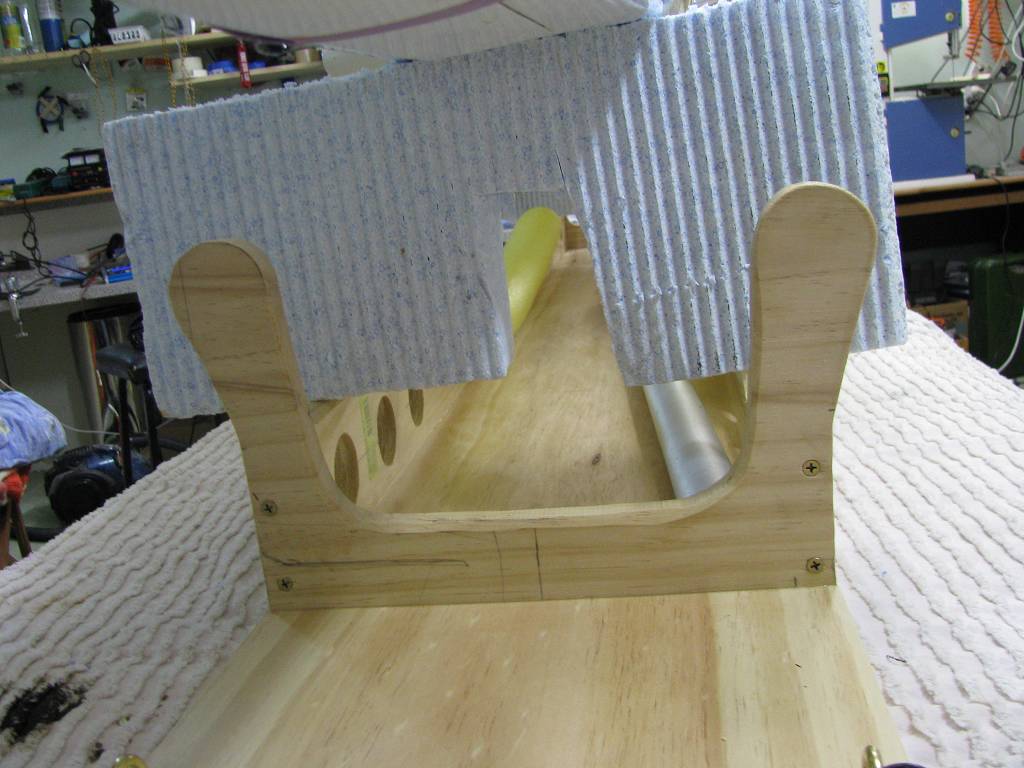

Would you be good enough to post the dimensions of your carrier and templates of the front and rear fuselage cradles? Looks great!
Shall post some shots of the craddle and try and explain
BOTTOM PLANK 2.4 MTS LONG X290 MM WIDE
BOTH FRONT AND BACK SUPPORTS 290MM WIDE 190MM H
MIDDLE SUPPORT 1800 X 90 LONG
I hope the shot will help you will have to allow for what ever tube you use apart from cutting templets and posting them by post this is the best I can do
REGARDS
JOHN

Just a heads up chaps, if you do make a craddle don't leave your presious airframe on it for a long period of time, the paint will fade from UV exposure, but not under the straps, even under the bottom supports there will eventually be a colour difference, just thought I would mention it.
Mike

with a friend of mine that is building another Viper we measured the difference of degree between wing and engine mount... 4 degrees!!!
Of course I swear I believe you (!!) about the strange absense of pitch change with power but what about the total power? Don't you think we can lose some of it?
Alessandro

Alessandro
mine also looked strange when i put a straight line on the rails, as it does hit the bottom of the rear of the fuz. However i checked Ali's model which has the same angle of the rails, but the turbine lines up perfectly when bolted in place. I bolted mine onto the rails with the bypass and it also works out fine. Weird i know, i wasn't sure if it was an optical illusion to start with lol
Duncan

you are right, it seems in line, but you will agree with me that cannot...
I think we will find an answer here http://www.youtube.com/watch?v=NzlG28B-R8Y
Alessandro

I measured also the thrust line and i have got also the same problem as before. ( I think it is alessandro )
I think i will change the front ( of the mounting rail ) so the thrust line will stay almost the same as Ali says. ( with no pitch difference )
and after the turbine and thrustpipe are straight.

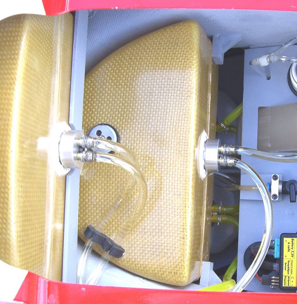

#722
RE: Another Skymaster Viper
SM Viperjets experts!
Guys I am about to start working on the fuse as I already finished all moving surfaces.
To my surprise the main large Kevlar tank doesn't fit at the bottom of the fuselage..... at the time I try to push the tank back to be under the intake bypass…. doesn’t fit….. it hits the intake.... it needs shim about 3 mm to able to fit. I am about to cut the tank in half at the seam…. remove the 3 mm and re glue the 2 pieces…. I know I can do a good job but what a pain.
Question? have any of you guys had that same problem…. or I am the only un lucky?
I am also considering moving that main tank on top of the bypass…… but I am concerned with having so much weight on top….. due to fuel.
By the way I measured the capacity of both Kevlar tanks and they are huge…. Bottom=92 onz and Upper 56onz…. total of 148 onz!
Any recommendations would be quite appreciated,
Gonzalo
Northern California
Gonzalo

#723
Join Date: May 2004
Location: Weert, NETHERLANDS
Posts: 359
Gonzalo,
in my viper SM glued some mounts for the air-tubes at the back of the fuse-bottom - my tank would not slide all the way back. Could this be your problem as well? I removed the airlines and re-located them - tank fits perfectly now..
Good luck!
Hans
Good luck!
Hans
#724
My Feedback: (39)
I know of a builder who found his intakes were not glued in straight so had to do the same thing and put his tank on top of the intakes instead of under.
To make the best of this he just located his smoke tanks under the intake instead.
Check the picture, you can just see the front of the smoke tanks.
PaulD
PaulD
#725
Thanks Hans and Paul for the info!
I am not planning so far to put smoke.... so I'm still on the side to cut the tank and redo the work.... is very little what I need to remove.... I am a little hesitant to have all that weight hi in the fuse...... unless I do most of my flight inverted
I still curious how many had that issue.
Regards,
Gonzalo
Regards,
Gonzalo
