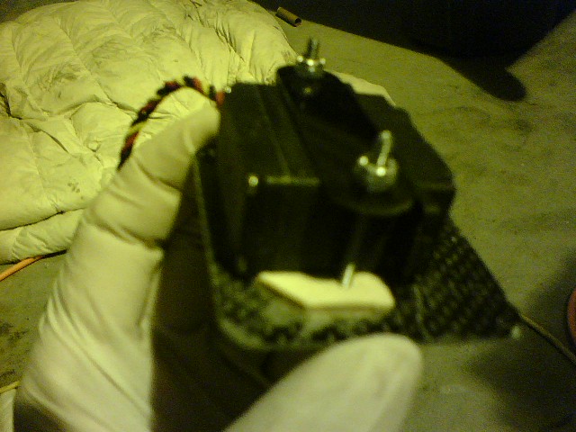

I am just going to go through sics picture from the first page so you guys have a better idea of the parts in that pic.
-Top rows servo covers/mounts. I think you know where all these go.
-Next two rows flap hinges
-next row down from left to right
2 aileron horns
2 elevator horns
4 flap horns
2 rudder horns (I only see one here sic. I hope you have 2 of these)
6 servo straps
-last row servo retainers
Here is a bad picture of the servo mounted to the servo cover. I will try and take some better pictures today of this setup and the control horns.
