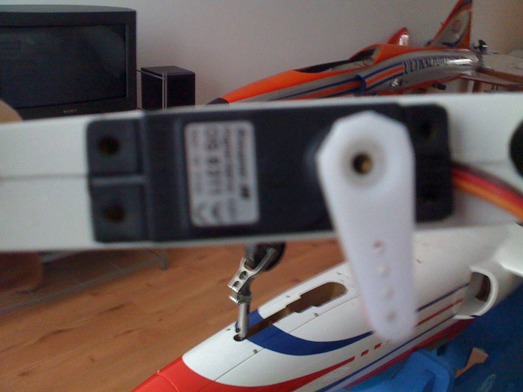

Damn, also no long piano fingers, guess I ask my girlfriend to install the flap servo.

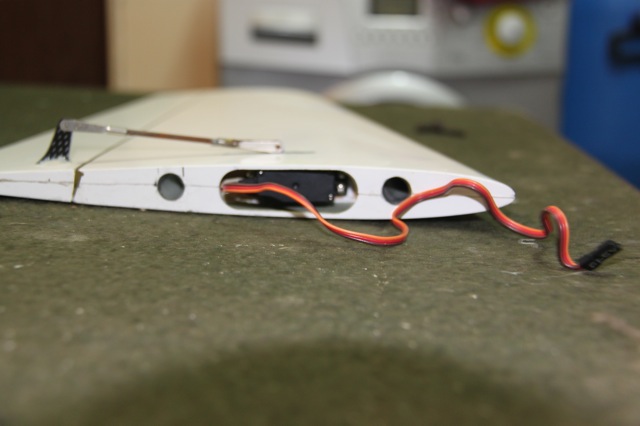

Its not that bad as Xantos made it sound. I drilled the holes for the flap servo with a pinvice, no motor tool i had would go in there. A little patience is required with a sharp drill.
Chaitanya.
Chaitanya.

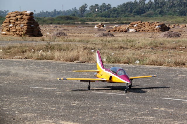

We've flown the Viper with a P80 and found it a little underpowered, lacked in the verticals changed over to a P120 and it flies great .
Also we fly at avg temp of 35 deg C so we do loose some thrust.

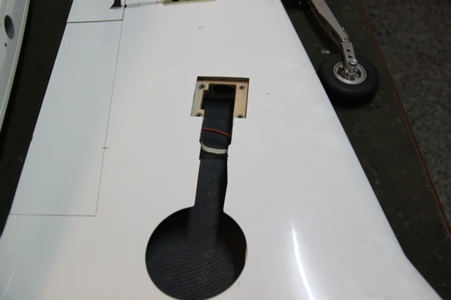

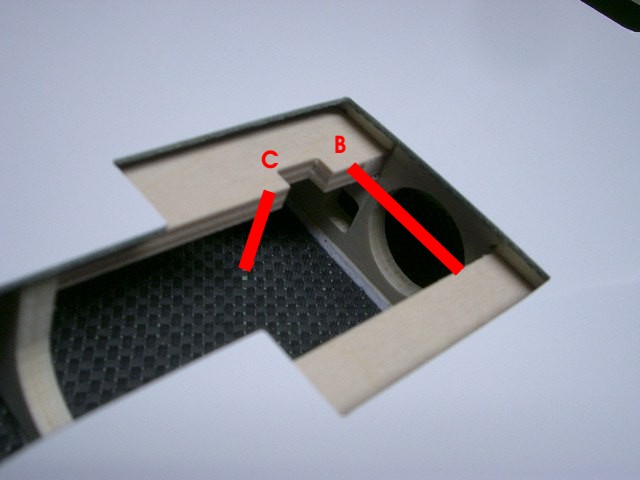

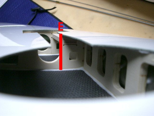

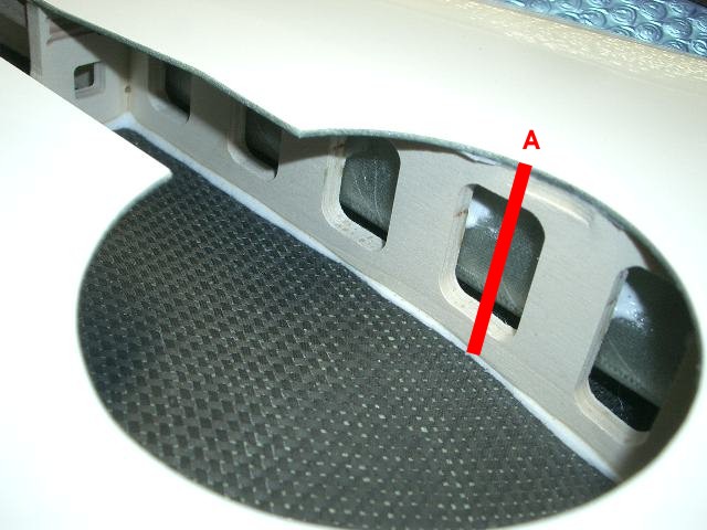

now please Didier if you can tell me some information for the wing place for retract ,
tell me the measurements from attach pictures A-B-C-D-E in mm.

Here are the measurement you asked for:
The letter code is the code in your pictures.
A= 45mm
A1= 35mm (This is the other side from A, trailing edge side)
B= 31mm
C= 34mm
D= 215mm
D1= 260mm (This is the total length from edge to edge)
E= 44mm
F= 90mm (This is the diameter of the wheel hole in the wing

Jet-1a wont fit without shimming the retract
Behotec will do the job , but needs a inforcement carbon plate to make sure the screws will have enough place to secure.
since both Jet-1a and behotec are relative small.
Pro-lynx will also fit , the oleo,s are pretty long but not impossible.
Still to make a set we need the model here to make sure we got it right.

Thank you Didier for the measurement
( i think my Jet-1A retract its ok with some extra work . )

It is possible to install a standard servo in to the horizontal stab. (JR8411)
Very minor adjusment with a dremel needed.
Only it will be twice the weight compared to the JR3421.
Still did not decide. I'm very interrested if this will give me C.G. problems because I also will install a heavier turbine (P-120SE)

Hi Didier,
uploading some pics for you
I dont think the 8411 will fit as the tailplane half is designed such that a 3421 servo is screwed on from the bottom and only the top of the servo and arm exit on the other side of the rib on which it is mounted
Ive uploaded some pics of the flap servo install and the retract install
Xantos

I'm convinced the JR8311/8411 will fit in the stab.
In this picture I just drop in the JR8311 (8411 with nylon gear) in to the stab without doing anything.
Only the opening in the wooden former needs to be enlarged.
Ayway, I go for this option and replace the alumium stab tubes with carbon ones to compensate the servo weight difference.
