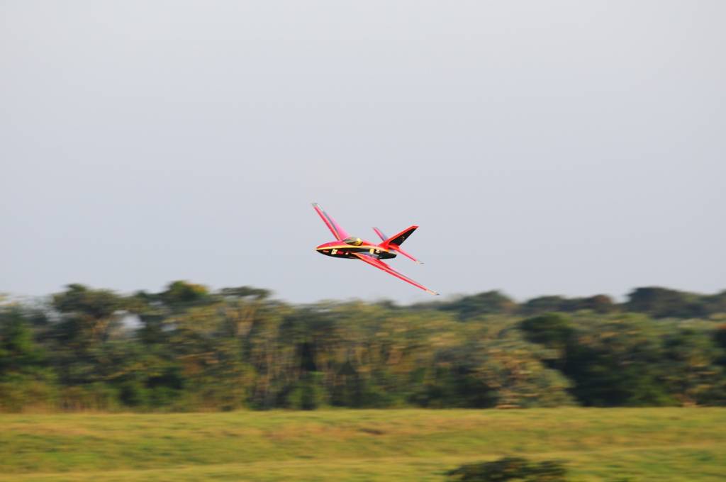

Well....here it is...the "truth and facts" on our attempt at the Jet Model Speed Record; however, it is no longer an attempt. We (as a team) have made it official!
On Sunday, January 17, 2010 I did some of the most intense, adrenaline pumping R/C flying that I have ever done in my life to date. The end result was priceless!
First, I'd like to thank all involved, especially my great friend, Mr. Axel Hache from Santo Domingo, D.R. With his support and the help of many other people, we accomplished our goal! It is not longer a rumor..... a new Guinness World Record has been set! "For the fastest radio controlled, conventionally configured, turbine model aircraft in the world! After many flights, the end results came to an average speed of 337 mph (up & downwind). The maximum speed achieved was 345.23 mph (downwind)".
I wanted to share this with everyone since there have been rumors of an attempt on the model jet speed record. Some wanted to stop it, but most wanted it to happen, and it did, so thank you for the support!

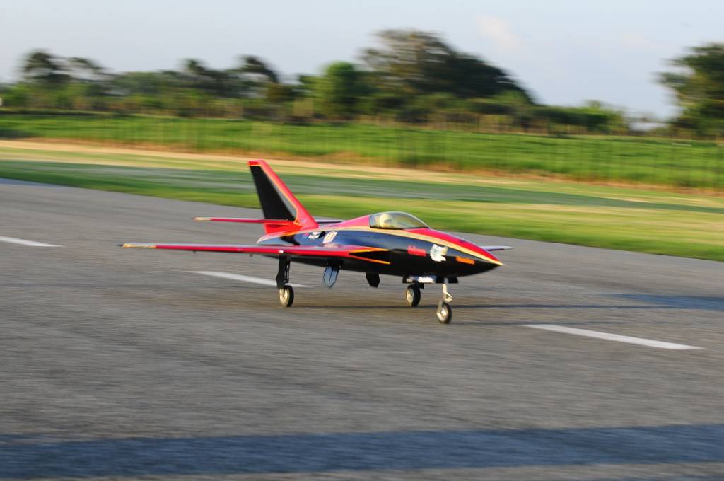

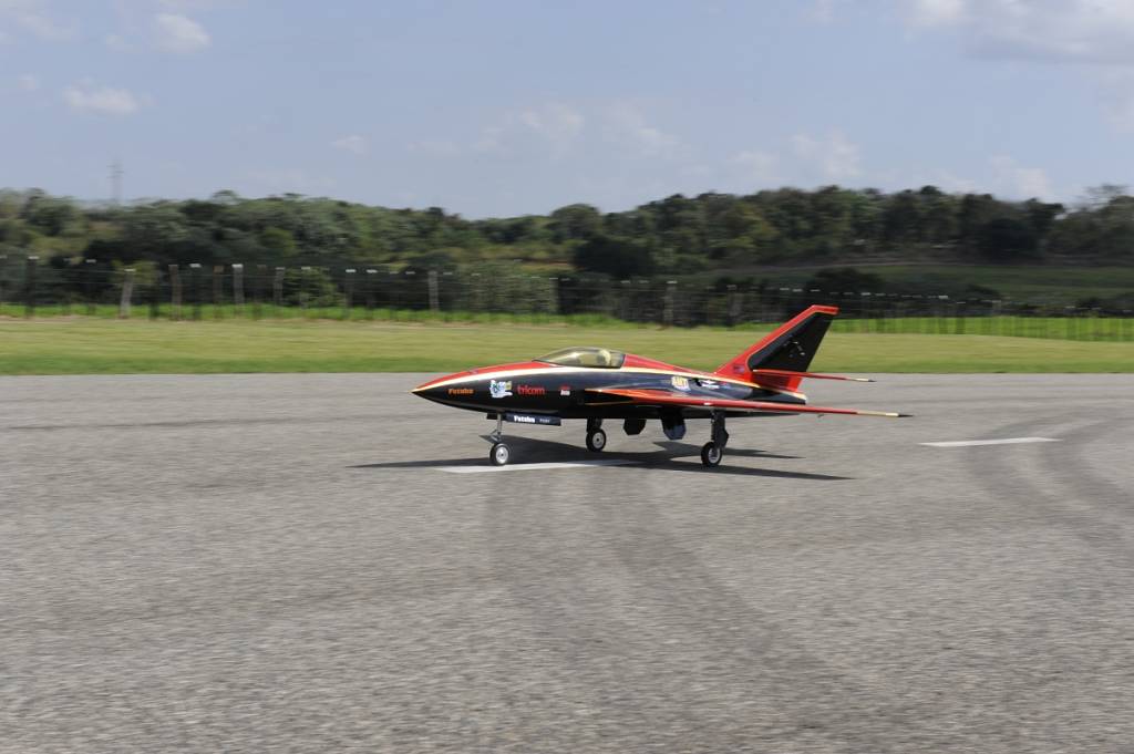

Airframe:
It was now time to contact Tom Cook of Jet Model Products. The Firebird is easily the cleanest, fastest model (that is considered a model - i.e. landing gear, rudder, etc) and after a few minutes, Tom was excited and wanted to work with us through the whole process.

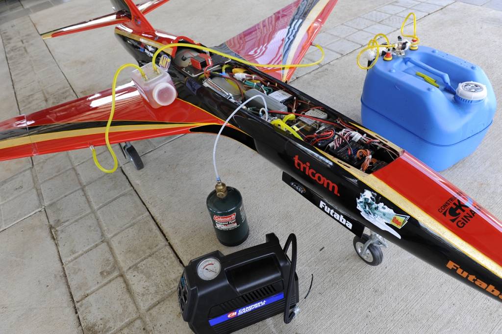

Turbine:
Next up was AMT Netherlands. An Olympus HP was in order, so a call to Bennie about the project peaked his interest as well and he was looking forward to seeing us be successful. The motor was tested thoroughly by Bennie and sent over, and for those wondering, no, a Titan will not fit.
Electronics:
Futaba's new 9157 servos (425 oz/in, 30.6 kg) were only a few months old at the time we began the project, so after discussing it with Frank Noll, we agreed that they would hold up to the speeds we were hoping to attain (in fact they were perfect!) Together with the Futaba metal servo arms and the JMP stock linkage setup as per the manual, no flutter or slop were present at any time during any flight. The 2.4ghz Faast system has been bulletproof for me since day one and really allowed me the extreme distance necessary to make the runs I envisioned.
Power system:
Battery power came from Duralite's Lithium Manganese packs which kept our servos ready with power for the stresses of 300+mph flight. The Lithium Manganese packs have a great "C" rating which under the heavy flight loads, high servo drain, delivered without hesitation. We understood that a good, reliable, redundant system was necessary - space was tight, so Emmerich from Powerbox said the Evolution would be just right. We met up again at Jet Power and he was very excited and wanted to know how the project was coming along.
Building:
Well, anyone that knows Axel or I realizes that we did not build this model, and with good reason, so we let the experts handle this build. A local (Orlando) team of skilled craftsman constructed the Firebird and had constant communication with Tom throughout the process. I would stop by weekly to see how it was progressing and made sure the fits were all extremely tight. A few minor adjustments were made to my liking mainly from input I gathered from other Firebird owners/fliers. Time started to come to a crunch and the paint work suffered multiple delays, as with any project on a deadline. Finally the paint process started during the worst possible time - our coldest week in 20 years here in Florida. The paint booth was at a balmy 15°F which did not help the clear coat. Thank goodness for sandpaper and a buffer!

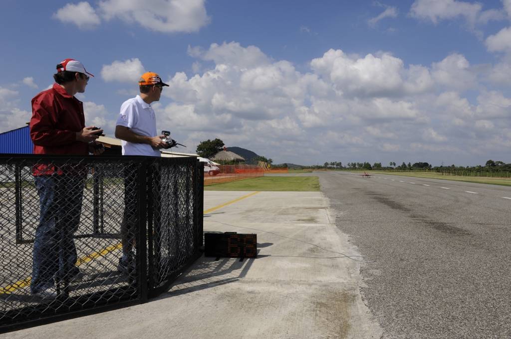

The Flights:
I can say with confidence now that this type of flying is not for most... or should not even be attempted by most. It was truly intense. A smooth flier is necessary when you are hitting these types of speeds with any model aircraft. The slightest yank and the model would easily be re-kitted. The flights lasted roughly 4 minutes and when coming around to land, the adrenaline was pumping so much that a simple landing seemed almost challenging. Axel managed a few passes as well via the buddy box towards the end of each flight. It was no doubt exciting and thrilling, basically "living on the edge" is the best way to describe it.

Airframe:
Turbine:
Electronics:
Power system:

The Flights:
