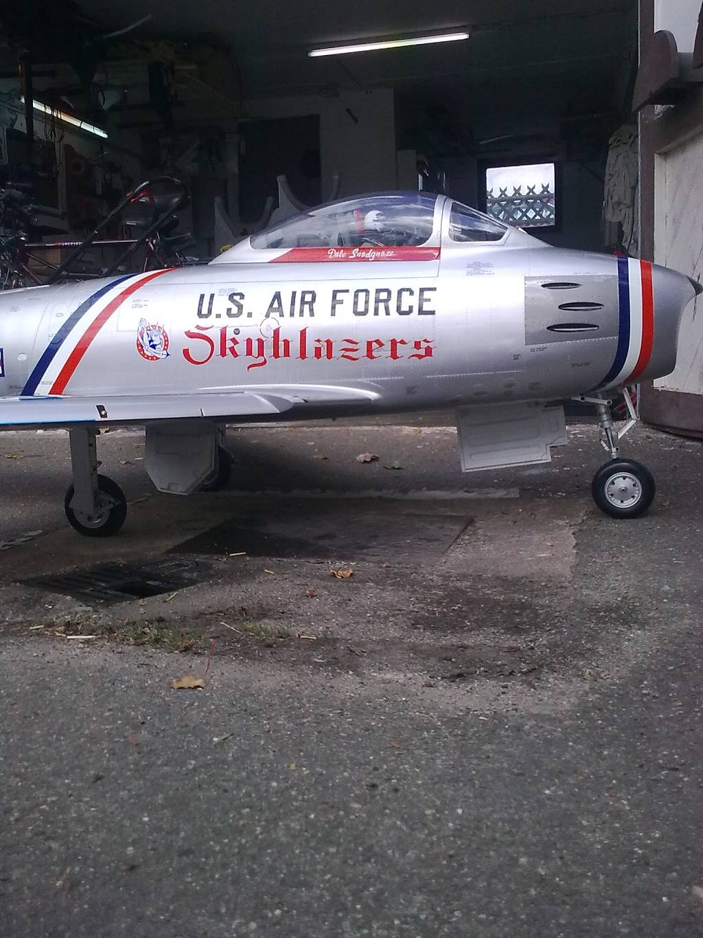

We need to extend the nose gear about a half inch in order to get the plane slightly positive incidence on the ground.
Brian

yes, but now already slightly positive incidence on the ground,,, i don't think need extend the nose gear ....
Thank you for your suggested!!

Mine does seem to have a little negative AOA. I'm glad the main strut pressure came up. I did not even realize it was ajustable.

The main wheels of that Skyblazer scheme are sitting in a hole....that's why it has the positive AOA....putting more air in the mains will make it worse in terms of a negative AOA, not better....we'll get ours dialed in and working.....no worries....

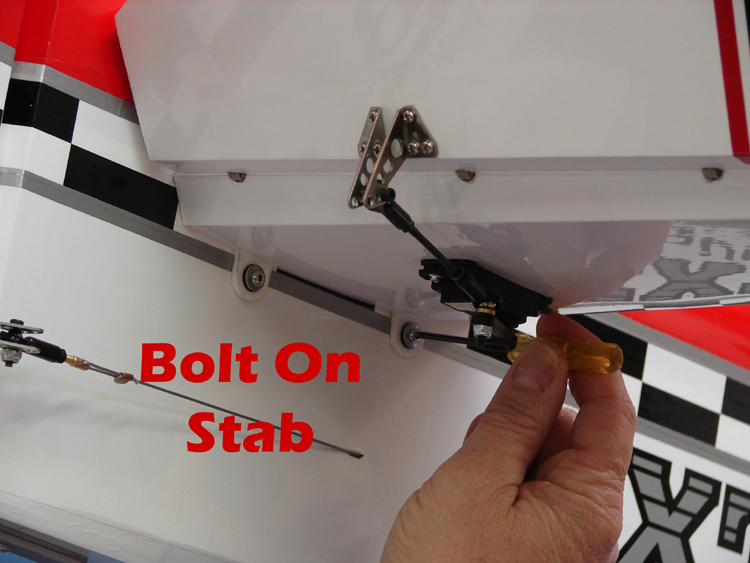

BTW, how did you guys attach your stabs to the fuselage? You can either glue them or attach with the 2mm screw thru the carbon rod on the stab. When I use a 2mm screw I have a gap between the fuse and stab and it also wiggles up and down. On the other hand if you glue it in place then you cannot remove the rudder for service. Not a fan of the design at this point, too many problems in this area of the plane...

Gary, I embedded a piece of 1/8 ply laminated with .015" poly ply in the root of the stab that stuck down about 3/8"....I glued it so it's flush with the side of the fuselage on the underside of the stab, then drilled it and sunk a 4-40 blind nut inside the fuse....now pulling the stab takes about 30 seconds...

Gary, this is what I did (pic in previous post)....only used a single tab, made it smaller, and of course used a button head bolt to make it pretty...
