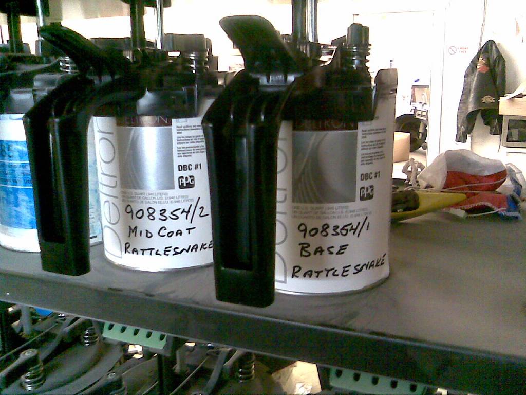

    Picture 3. Here is the color I am using for the overall bottom of the jet. It is a Pearl white tri-coat. The base is basically just a bright white, and the mid coat is a clear carrier with a gold pearl in it.

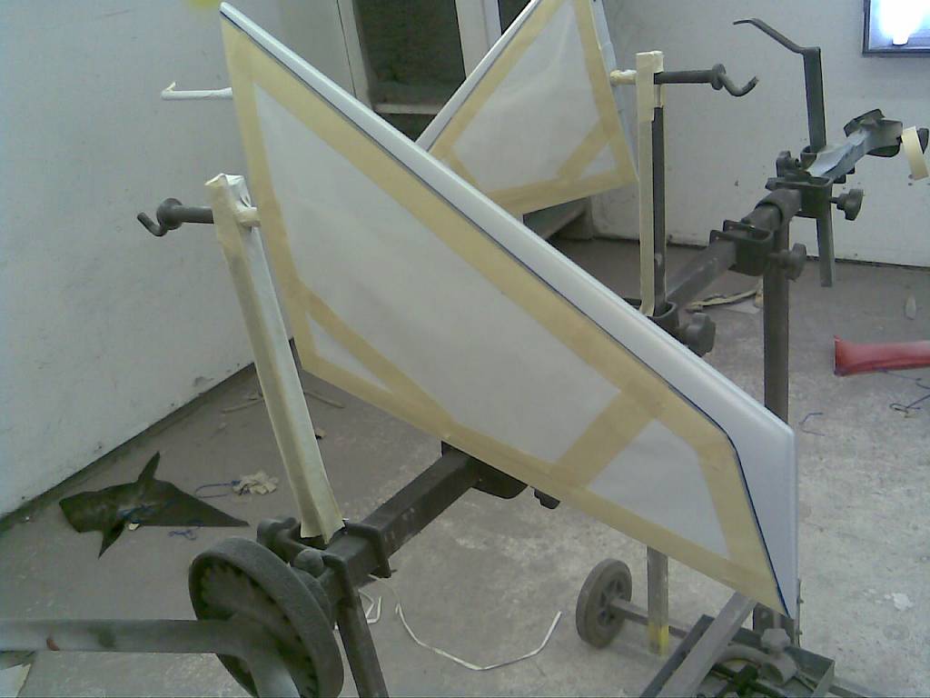

    Picture 4. The stabs which were sanded as per the first post here, were simply mounted on a paint stand so that they could be sprayed. I masked off the 1/4" rod that connects the 2 stab halves before spraying.

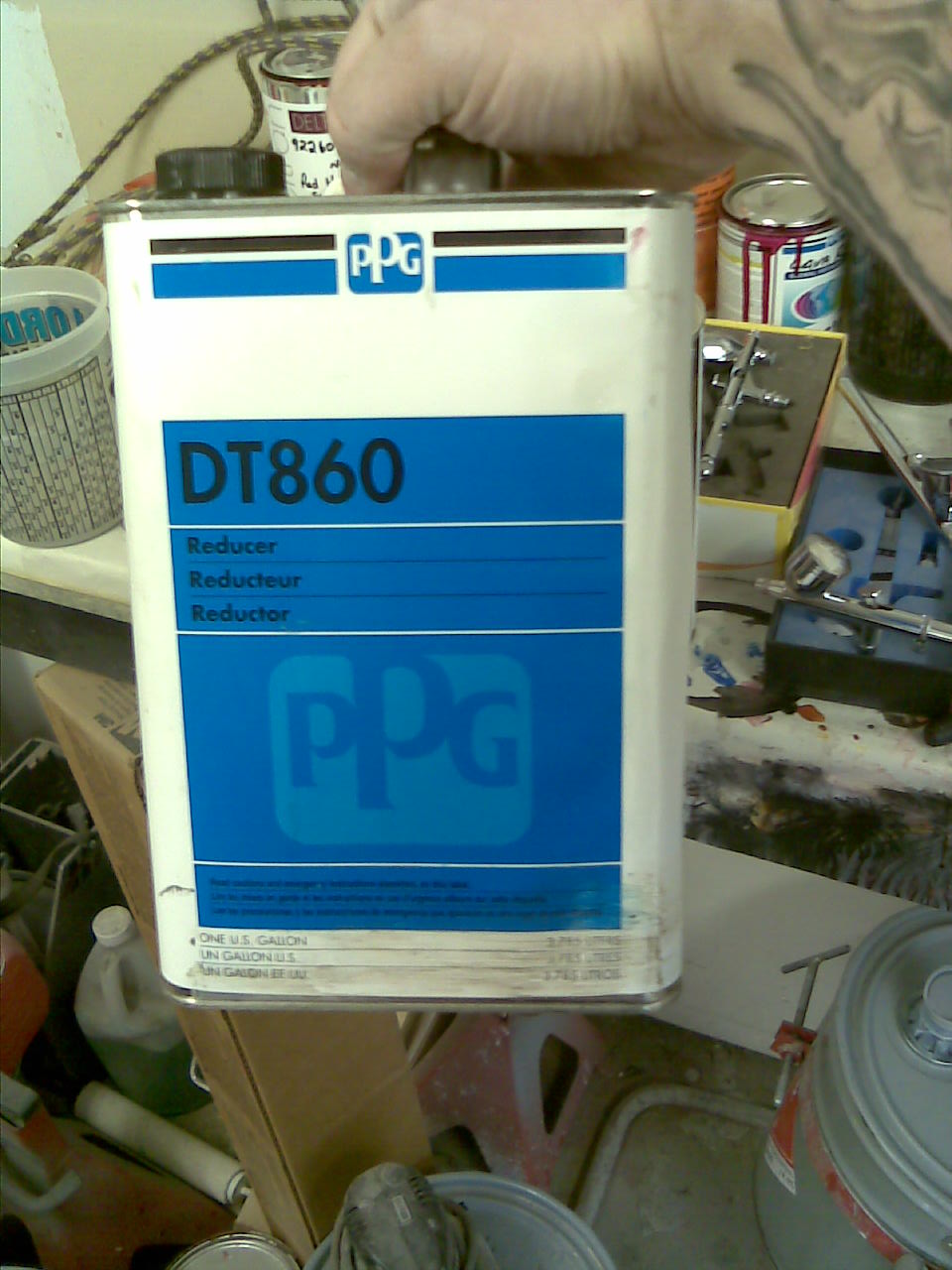

    Picture 5. Almost forgot, here is the reducer I am using with the paint. The paint and reducer mixes 1:1. I know there are guys here that like to paint their jets with over reduced paint, but it is pointless, you will only use more coats for even coverage and you end up with poor adhesion and a much better chance of runs.

    Step 5. Wait 15 minutes in between coats. I applied the mid coat (pearl) in the same method used for the base coat but only required one coat for the pearl effect I wanted.
    Picture 7. Ok, so now I'm a bit of a jerk because I forgot to take a picture of the stab bottoms in the white. However, here is a picture of the bottom of the stab masked out. I used 1/8" 3M blue fine line tape for the initial tape line and used 3M masking paper and tape to fill in the area I don't want paint to get on. I waited 1 hour between spraying the last pearl coat on the white and masking.
    Picture 8. Here is the main color I used on the top of the stabs. Another Tri-coat paint. This one has a prismatic pearl in it though. This particular color costs almost $2000 a gallon!!!!!
    Step 6. After wiping down the stab again (finger oils from masking will cause fish eyes) I spray first my base coat in the same method described above, and then my mid coat. I also sprayed my bypass cover with this color as well.
    Step 7. After removing the masking (which I do while the paint is still wet, you will get a crisper line this way) I mixed my clear. I used PPG 2001 clear with DU5 Hardener.

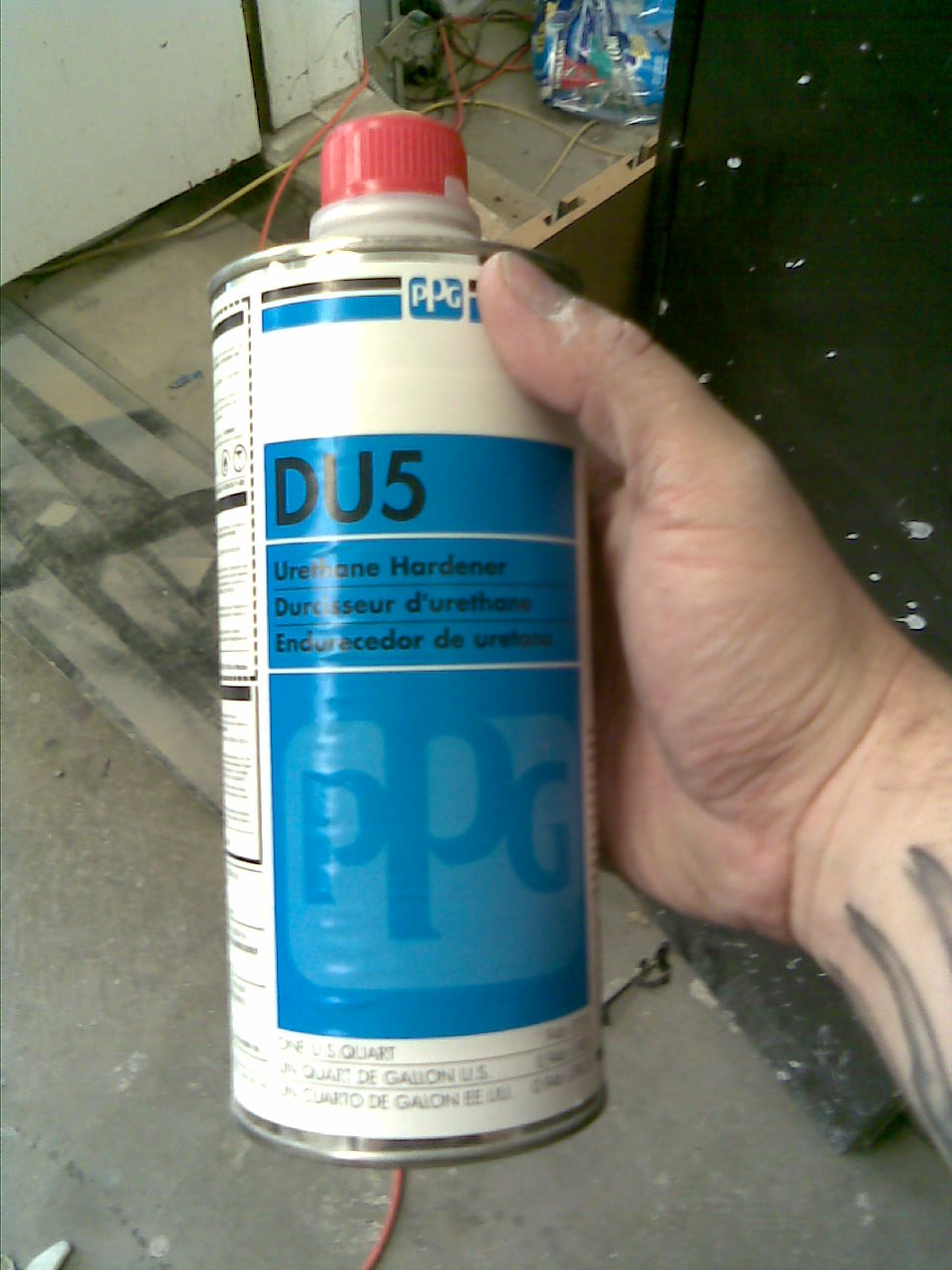

    Picture 9. Clear
    Picture 10. Hardener
    Step 8. Mix the clear together in a 3:1:1 ratio. I do NOT reduce my clear anymore than recommended by manufacture. Doing this will reduce gloss, reduce adhesion, make it far easier to get runs, and will likely "solvent pop" (where it looks like you have millions of micro sized holes in the clear leaving a hazy look) If you spray your clear properly, after wet sanding and polishing you will have gained very little weight.

    Hey Jeremy - what's the deal with those black handle doohickeys on your paint cans in this pic
    [img]{akamaiimageforum}/upfiles/52999/Xw77528.jpg[/img] ?
    Looks like some kind of combo handle/pump, or something like that ?
  23. #23
    LGM Graphix's Avatar
    Join Date
    Apr 2003
    Abbotsford, BC, CANADA
    5,071
    Gallery
    My Gallery
    Models
    My Models
    Ratings
    My Feedback
    RE: Painting the JMP Firebird, a tutorial
    Hi Gordon,
    Those are lids for my paint mixing machine, they replace the metal lids and then I can just put them into the mixing station and turn it on. For the extreme pearled paints like the rattlesnake I'll let them mix for a good 20 minutes before I paint. They have a trigger on them so that to pour I just tip, pull the trigger, and the paint comes out.
    Jeremy
