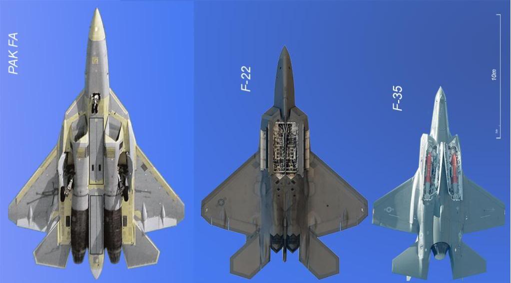

Biggest RCS problem that airplane is going to have is head-on looking into the intakes. The engine compressor blades are going to show up like the side of a barn! There's a reason those are shielded from direct view on the F-22 and F-35.
