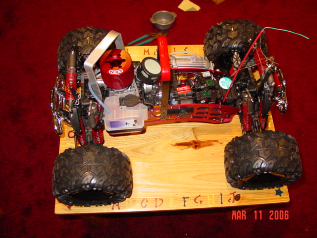

in the cen forum someone had a batt problem and the failsafe didnt work. i would recommend putting a throttle return spring on. i put one on mine the other day for just such an emergency.its for if in the event that you loose the batt, the throttle return spring will overpower the servo and return the engine to idle.i used a spare that came with the savage but you can make your own. the home depot in the lawnmower sec or inthe hardware sec have springs just cut them to size.

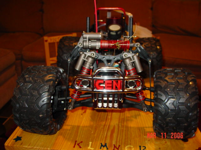

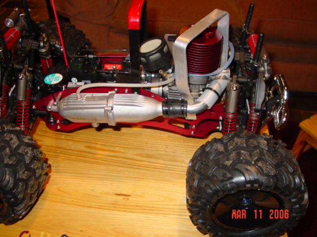

yea your right, the 4 pack is weak and i had 2300 mah in the truck. i'm going to order some 3800 sub c and make them fit even if i need to make my own pack. well here is the carnage of my truck, o wait there isnt any lol. this a great day breakin went well, bashing went great, and nothing broke. the steering servo i'm using is the stock one, it has 144 oz/in of tork and works great.

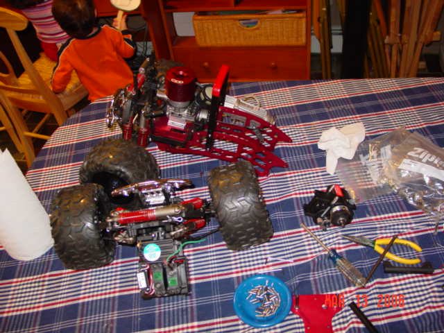

ok,this was my own fault. i was too lazy to check all the allen screws on the truck to see if they all had loctite.well all of this for that one allen on the front driveshaft. well it could of been worse, it just stoped in its tracks when i was putting it in reverse. i thought i blew the tranny but its only the little grub screw. since i have it all apart i might as well go through the whole truck the right way and not half my *****,lol.

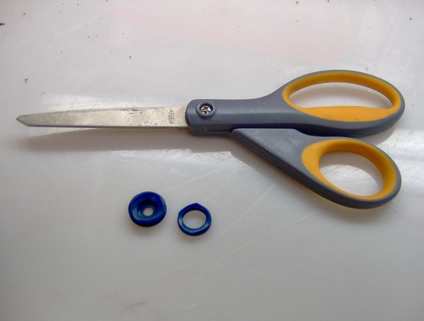

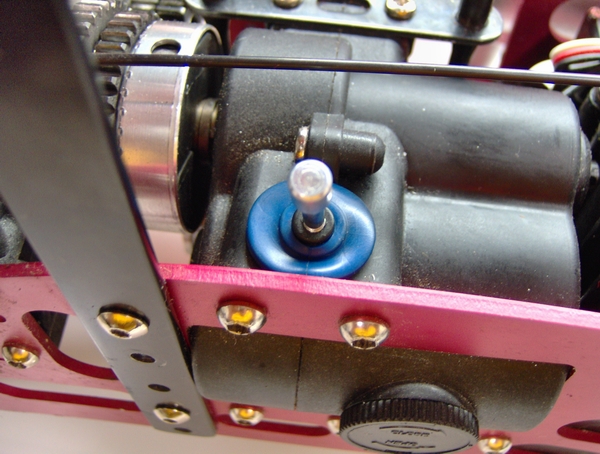

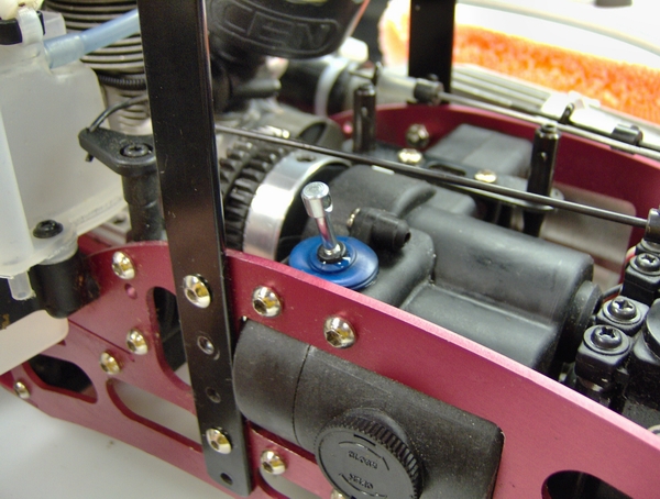

Just a quick shifter dust boot fix.
Pic1 - This is a traxxas 2.5 carb dust boot.
Pic2 - With a pair of scissors cut off lower part by stretching boot out.
Pic3 - Use the one with the small opening.
Pic4 - Shifter shown without dust boot.
Pic5 - Applied several very small dabs of super glue and pushed onto shifter seating lower part.
Pic6 - Put small amount of glue on top to hold it on, doesn't need much since it is a tight fit.
[link]http://www2.towerhobbies.com/cgi-bin/wti0001p?&I=LXDGA6&P=7[/link]
Part would look much better on the blue Nemesis, but is effective on either one. There might be one that would work in a different color, I just had the traxxas one laying around.

Looks really nice michelob78, and it is a very smart idea.

Look in the picture above showing the shifter dust boot..... behind the shifter in the picture is the 2nd gear clutch assembly. I am sure it covers this in instructions.... at least my gen le did. Here is a link to a genesis .pdf that shows how to adjust it exactly.
[link]http://www.cenracing.com/cars/genesis/genesis_2nd
_and_3rd_speed_tuning_instructions.pdf[/link]
