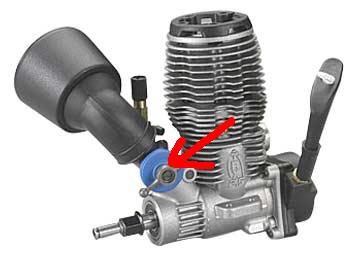

hi
i just got my revo this week
it is very good
but how can i make wheely with revo?
can you tell me plz

The screw where the throttle links hook up turn that clock-wise.
Just look at the pic.

errr thats a pretty reckless suggestion.
for starters, have you broken it in?
only thing you can safely do to help it wheelie is to tighten the slipper. (and you then risk drivetrain damage, but a little bit should be ok, dont go crazy with it though)
but an engine continues to increase in power up through the 1st gallon of fuel.
Might I suggest you not destroy your car trying to tune enough power for wheelies. they mean very little, and are actually negative to the cars performance. they look pretty the first 5 times, than you get tired of flipping it back over and having such a touchy truck. they will come eventually, and when they do you'll wish they didnt.

tune it for good performance.
lock the slipper for wheelies.
dont confuse the 2. you could put a novarossi 8 port in it, and if the slipper isnt tight enough still not wheelie. or you could put a .15 whatever in it, and lock the slipper, probably manage to get the front up.
these trucks have oodles of traction. and PLENTY of power.
as was said, read the manual, and for your engines sake, dont keep leaning it out till you get wheelies.
