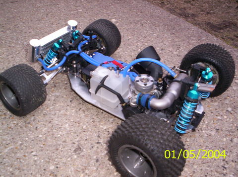

Well to explain a few things im running an airplane fuel pump to help force enough fuel when the turbo hits boost. And the turbo's exhaust compressor is ported large and smooth for full flow and yet enough to spin the wheel at a sufficiant rpm to make power. Had a problem at first, not enough blades on the exhaust wheel, so it didnt hit boost till the end of the motors rpm's. So i added 2 more blades and that cured that problem. And yea your half right about the boost blowing right through the motor and out the exhaust when the pistons down but when it comes back up i snag at least an estimated 45% out of a 100% plus the insane amounts of fuel im dumping at the same time create the extra hp i was hoping to get out of the project. And the reason for the liquid cooling is because i figured that since i was going to ram some air into this motor that i might get a rapid change in head temps so i stopped that problem dead in its tracks with the liquid cooled idea. And after all said and done didnt even notice the measly amount of so called weight that i added to my truck.

and where would you find a turbo small enough to fit to a nitro engine... unless you used some small electric fan or something

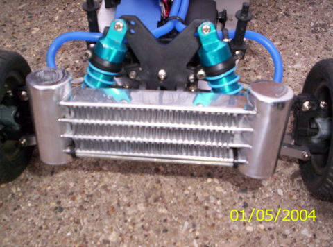

Impressive looking job. Did you do all of the machining yourself? If so, very nice.
Are you really comfortable with the radiator out front? Doesn't it make your ride front heavy and aren't you concerned with what will happen to it if you run into something. Also, how do you pump the water through the cooling head?
Regardless of that its still sweet.

ive actually smashed the radiator several time before and it takes it well. as to weight, didnt even notice it at all. The machining of the turbo was done by a friend of mine at a machine shop around the corner from my house. And my buddy oh so violent jay built and fabbed my chassie and front shocktower brace out of aircraft aluminum. I use two Perry fuel pumps for an airplane, one to pump the antifreeze through the head and radiator, and one to pump the fuel to the engine for the turbo. thanx for the comment.

i would love for you to tell me how you changed the engine timing so that the exhaust port is closed when the fuel intake is open so that pressure or "boost" can be built as rc engines dont have valves

This is the biggest load of bull I have ever heard... You can't put forced induction on our nitro engines. It is impossible. This is because the exhaust port closes after the intake ports. If you look at the sleeve, you will see that the top of the exhaust port is higher than any other intake ports. Therefore when the piston is reaching the top of the stroke, pressure gained, if any at all, by your so called "turbocharger" would be forced out of the exhaust port. Therefore forced induction does not work on our nitro engines, not even the slightest amount.
Also, by having all of this blowby, you are not only waisting tons of fuel, but you are also eliminating the natural forced induction created by a tuned pipe. A tuned pipe creates backpressure. This is when the exhaust gases reach the end of the pipe and reverberate back to the engine. When an engine is running, some of the fresh air and fuel mixture is expelled out of the exhaust port. What the backpressure does however, is push this air and fuel back into the combustion chamber. Since all of the other ports excluding the exhaust are closed, this creates a natural forced induction. Have you ever wondered why our nitro engines run with much more torque and horsepower with tuned pipes instead of open pipes? This is also why tuned pipes can also be considered "low end" or "high end" pipes. This is mostly due to the shape and length of the pipe which causes the backpressure to be most efficient at different RPM ranges.
And since your "turbocharger" doesn't work and merely heats up your engine, I bet you will go much faster by sticking a nice tuned pipe on it and going back to air cooled.

That "puny radiator" is about the same size as the heating cores in small cars. Think those do crap??

Can we at least see a better pic of the Turbo installed on the car.
