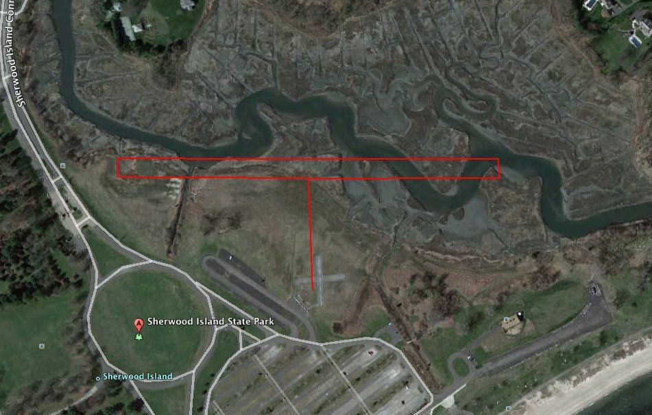

In particular you can see this field which is only 20 minutes from my house. I don't want to practice at 150m and then have everyone slam me for flying too small at contests.

I'm glad Joe brought this topic up. It prompted me to look at my own field (Pitt Town, Sydney) to see where 150m actually is. I’m pretty confident that we are flying within the 150-175 band and possibly even closer in.

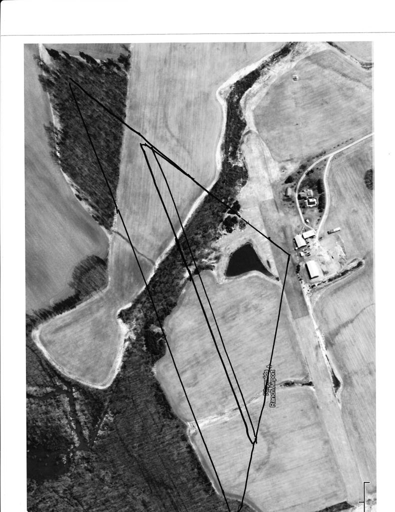

I have used Google Earth for the same thing as it has a built in ruler. I have been at this field out at the center marker while an F3A pilot flew and gave a raised arm to the caller whenever he flew beyond me. Very interesting experience.

Looking at the Fredricksburg photo above I'm thinking a couple things about last fall.
1) I think we were flying past the house on the left and turning in the middle of the far left field which would be at least 200 meters.
2) some folks were approaching the road and that's about 250.
Like I said I've been badly mistaken before when I got fixated on a topic, but boy it seems to be my experience that everyone I know is flying outside 175 meters. Now I'm curious to know how fast we really fly 'cuz I've heard it said we're doing about 70-80 and that's 30 to 35 meters per second which should allow a mere 15 seconds from end to end for the official box, and THAT seems REALLY tiny. Does anyone have GPS data on their speed with a 2M plane?
Joe

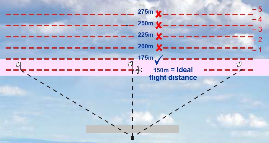

See already caught a mistake in the above photo. It showed 150 and 200 not 150 and 175 but I fixed it now
