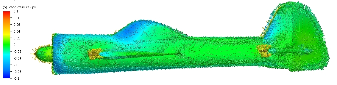

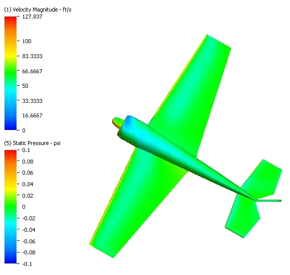

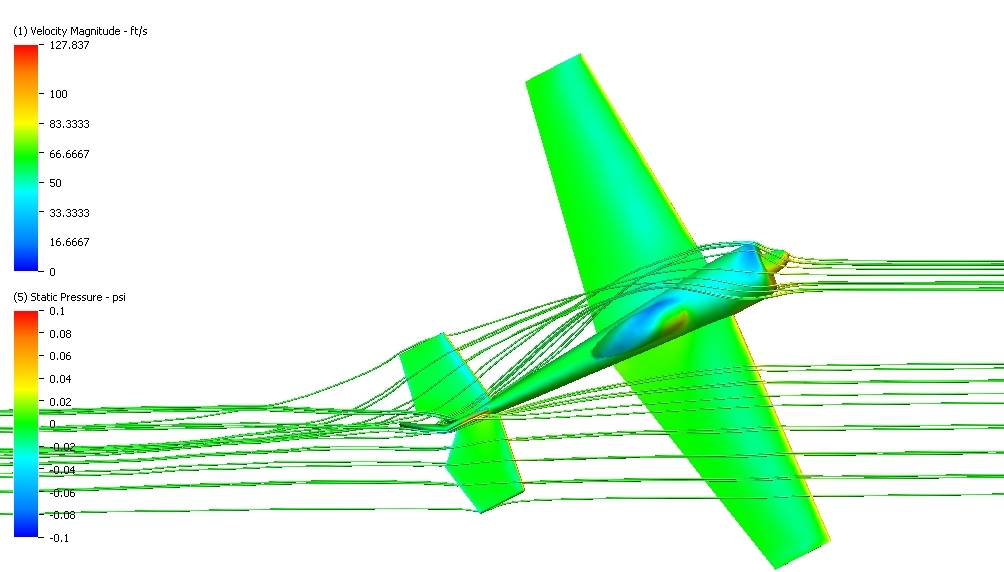

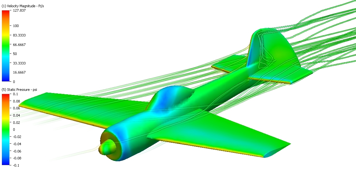

Interesting tests, Alex. Keep it up!
Talking about the Corsair photo
I can assure you that P-factor, gyro-P and torque are all at play in straight & level flight at all speeds. Any tri-gear (nosedragger) prop plane, single or multi-engine, Cessna 150 to P-63 to King Air 350 twin turboprop, will turn hard left if right rudder is not applied at takeoff. The Cessna 421 I fly will not stay on the runway if full power is rapidly applied, even with full right rudder, or if powered up with brakes on, and then released. For that reason, we slowly add power for 5-8 seconds while rolling to give the rudder more authority after 40 knots or so. Same thing in descents, we must use left rudder to correct for P-factor with the nose low.
The Corsair was one of the fighters that was powerful enough to roll over on the ground if power was abruptly applied, and this killed more than one Naval/Marine aviator.
You are correct to point out the rudder.
However 'p-factor and gyroscopic precession' are NOT in play. So the point you make re the rudder is even more valid re 'SSS'.
The p-factor and gyroscopic precession only come into play during pitch and or yaw changes.
The torque is in play but that is transferring into the deck via the UC.

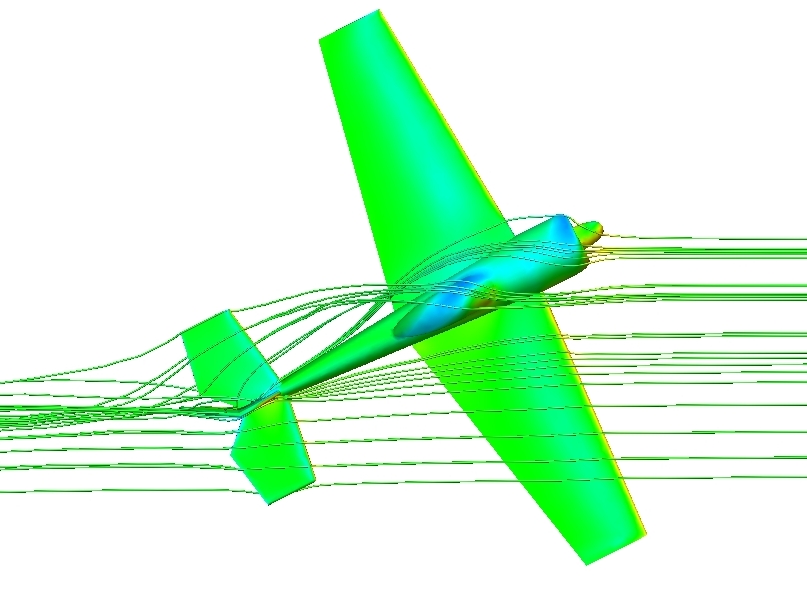

There are a lot of things at play that cause a plane to want right thrust:
-spiraling air stream
-torque
-gyroscopic effect
-p-factor
The contra planes combat almost the whole list.
The props with less area at the hub would have less P-factor effect, since the portion of the prop with the highest pitch is eliminated.

Great job, Alex and mythrandir!!!
Hopefully, your data will be used in the next generation of pattern ship.

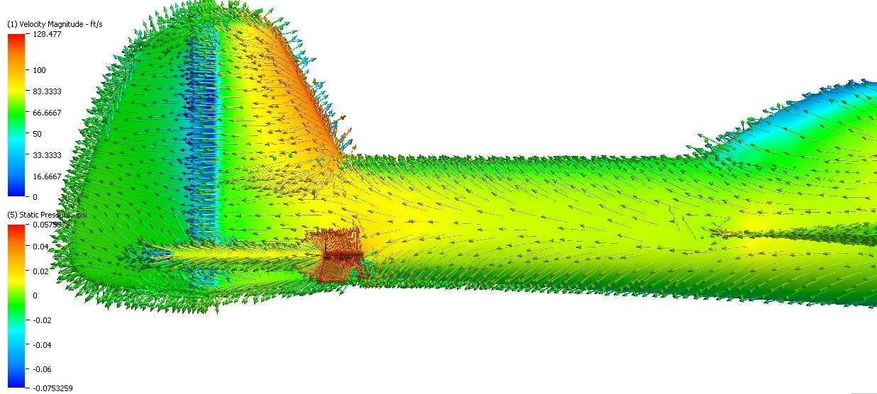

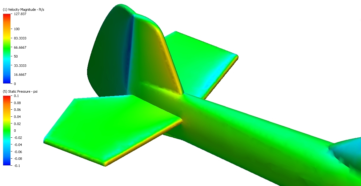

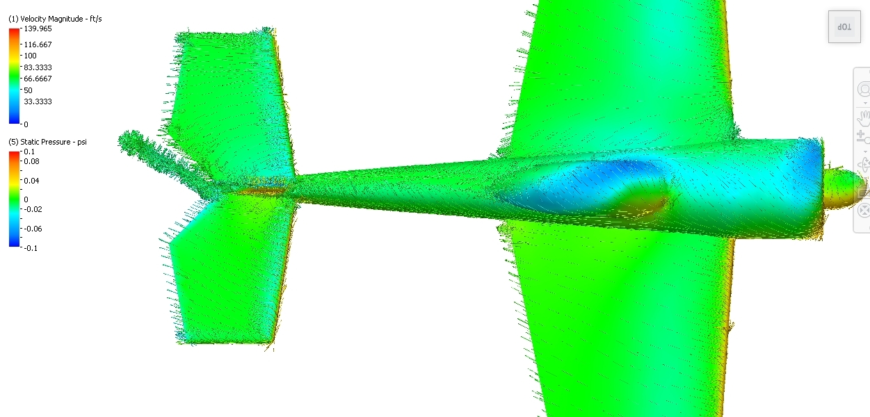

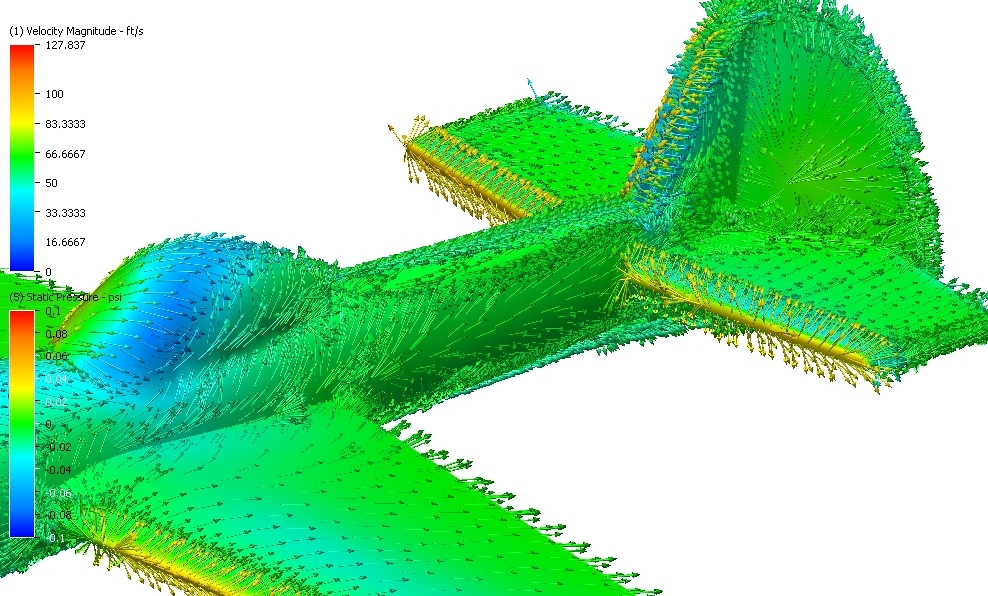

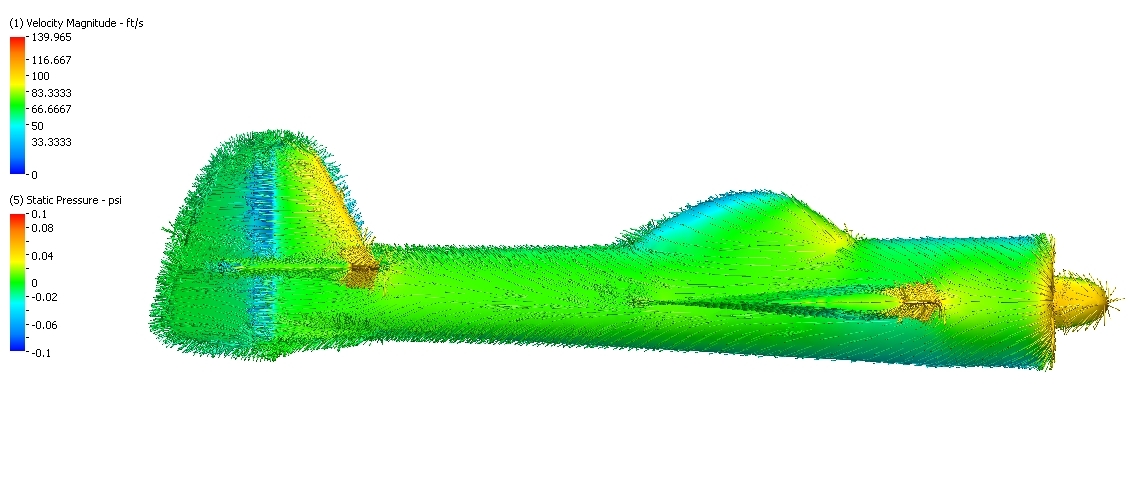

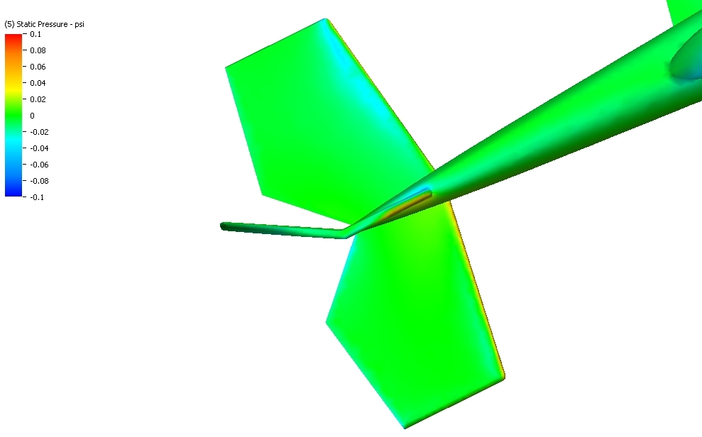

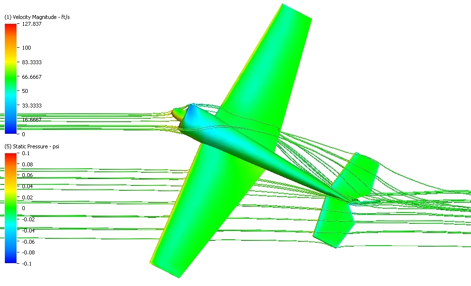

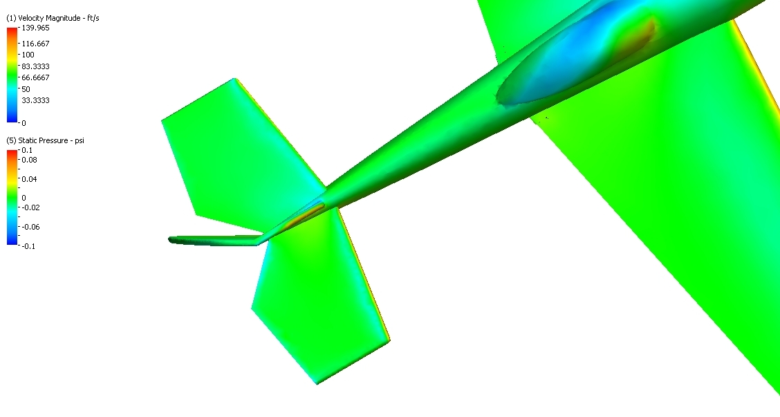

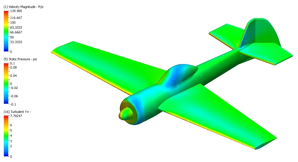

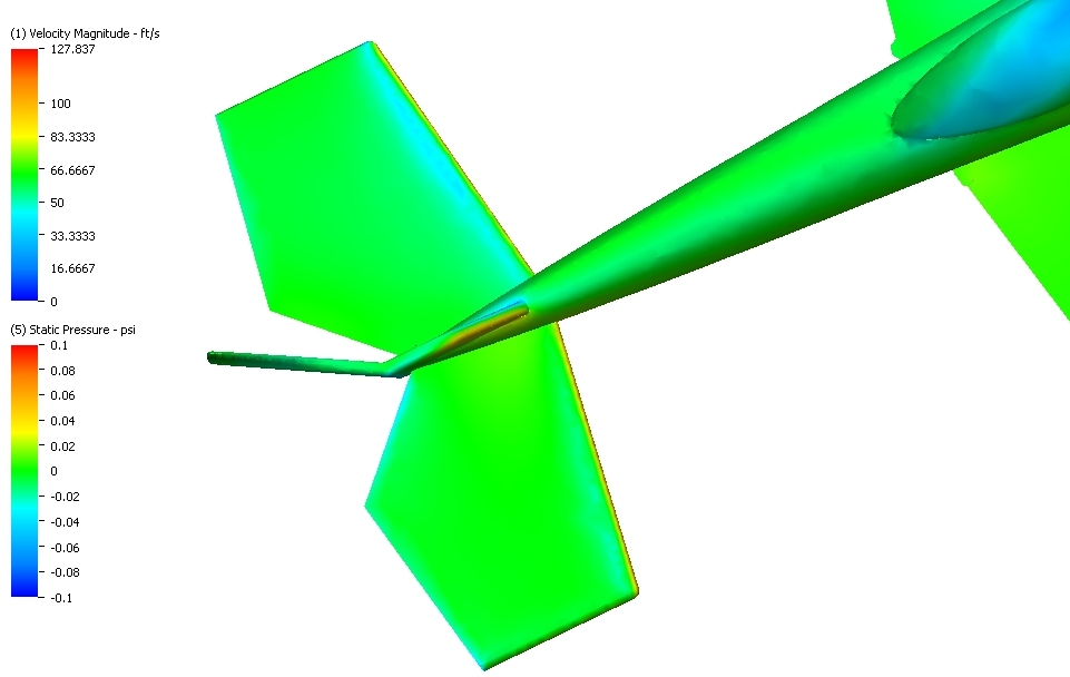

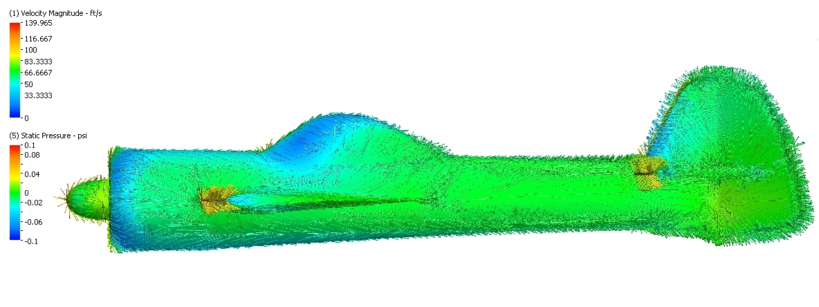

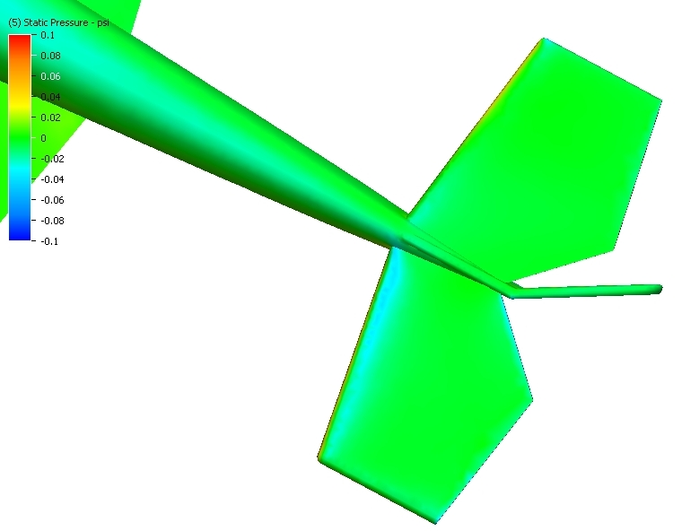

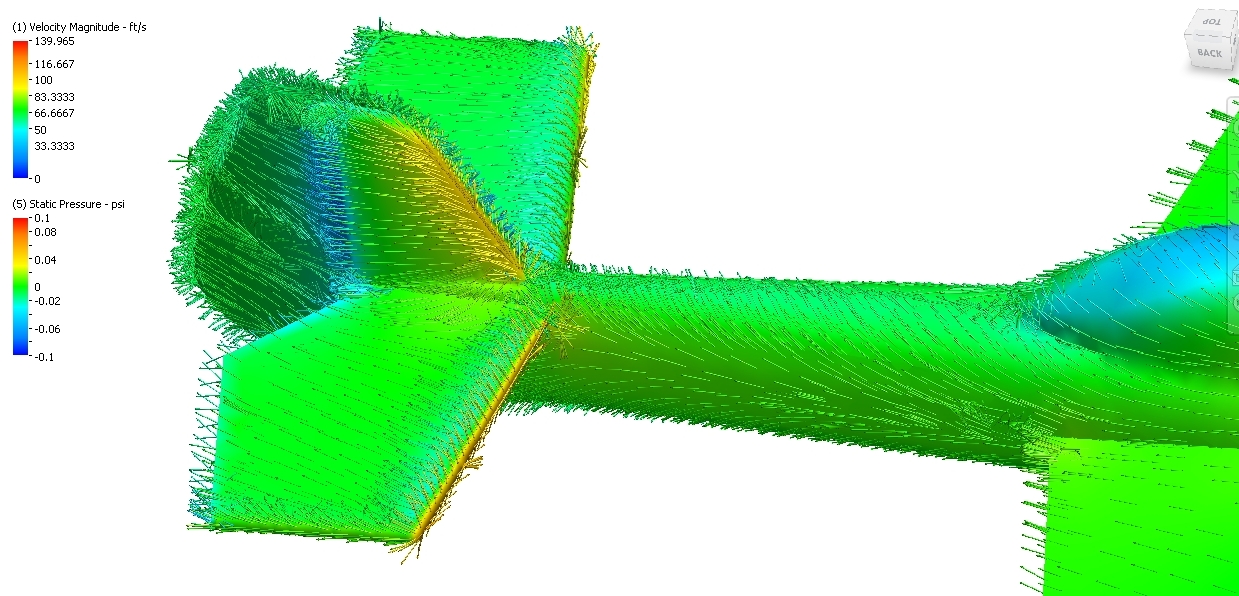

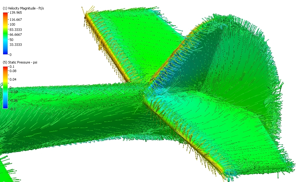

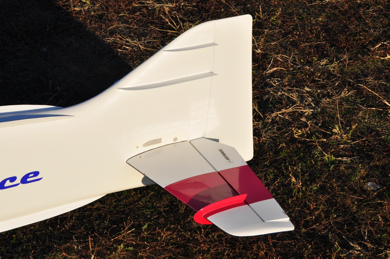

This weekend i made more progress with the setup on my plane and eliminated the proverse roll coupling i mentioned earlier.
I always felt that the stab was placed too high on my Radiance prototype, forcing me to use high incidence (+1.1 deg) on the wing to counter the pull to canopy on the vertical uplines. This was fixed on the kit version, but it remained unchanged on my prototype for 3 years. With the competition season now over, i had plenty of time to work on the plane so i moved the stab 30mm lower and changed the wing incidence to +0.7deg, as Bryan recommended. This improved many aspects: the upline pull to canopy disappeared, knife edge roll coupling was gone too, downline mix slightly reduced.
Just to test the improvements in KE performance brought by the fuselage strakes and fin fences, i went through the first few P13 maneuvers (half clover leaf, stall turn, roll combination, half square loop, triangle and split S), all performed in knife edge position. The corners seemed to be as tight as when performed in normal position and i never used full rudder throw. Of course, the maneuvers didn't look as smooth and precise because it's quite unusual for me to perform them on KE, but there's enough rudder power and fuselage lift to go through the maneuvers, no doubt about that.

Hemm , have nerver Think about The. Stab position up ore Down from. O Line.. Will have so Much effect ón The hole plane .. Hemm om only a roooookie.. Lol.. My bibe goes Nice ón NE. But have a llitel Roll cupling ón NE i Think wings move 15* ón 150m . Have all thought too little v shape in wing. Have do i find The Rights spot fore The stab. Maby i Will try a new place ón my next kitt,, .
#109
I don't think that changing the stab position affected the roll coupling, but it allowed me to use lower wing incidence.
I tried +0.7 deg. incidence on the wing before, but with the stab in the initial position the plane pulled to the canopy on the vertical uplines, so i had to use more wing incidence (+1.1 deg.) to counter this tendency.
Moving the stab lower eliminated the pull to canopy on the uplines, so i was able to follow Bryan's advice and reduce the wing incidence to +0.7 deg. I think it's the change in wing incidence that fixed the roll coupling, moving the stab probably had very little to do with it and only affected the vertical uplines.
#110
Hi Torben,

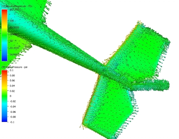

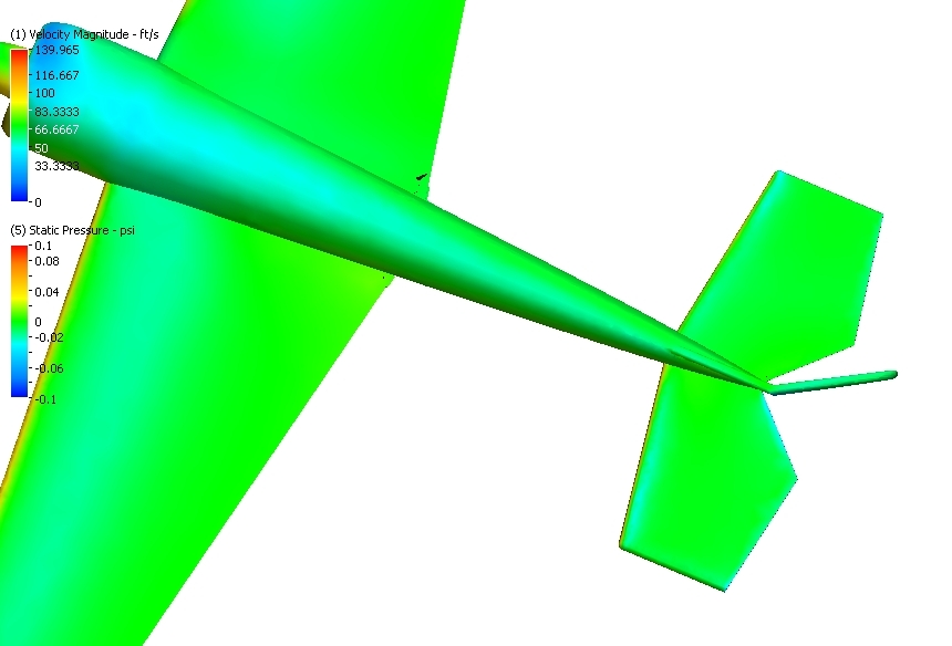

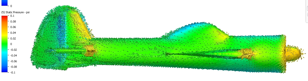

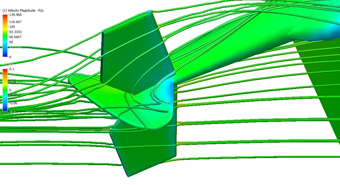

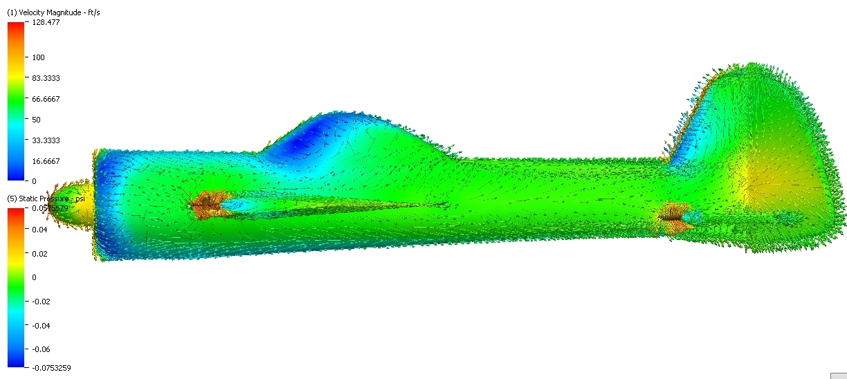

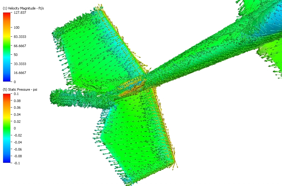

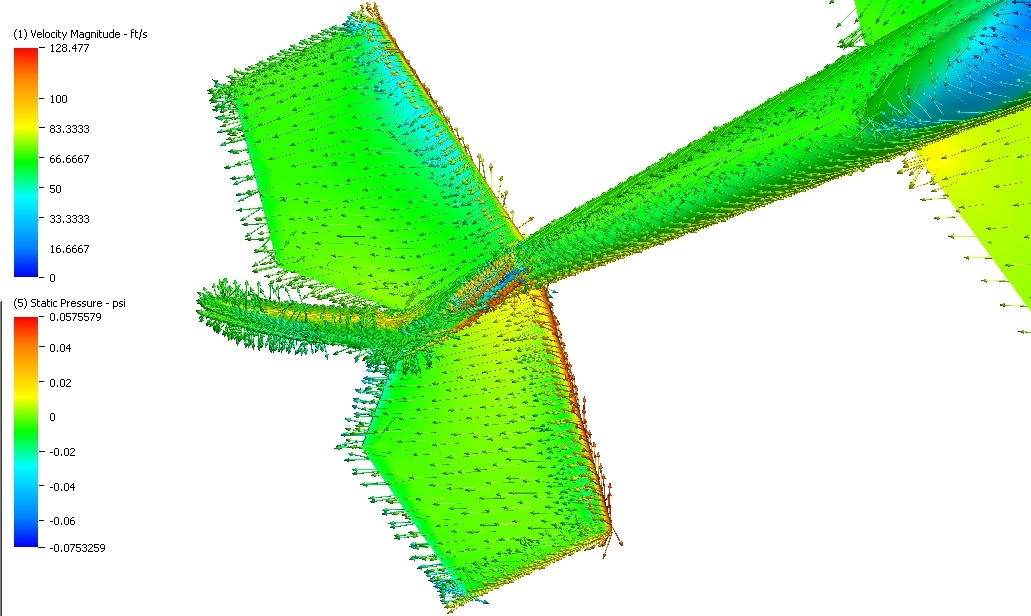

When i tested the model in the spring with 0.7deg wing incidence and stab in the initial position, i noticed it pulled to the canopy on the vertical uplines. It took 2% of down elevator at full throttle to keep the upline perfectly straight. Increasing wing incidence means you need to add down trim to keep horizontal flight (assuming CG is in the same position). This down trim is also carried on the verticals, eliminating the pull to canopy. I eventually got rid of the mix mentioned above by increasing the wing incidence to 1.1deg; overall the model was flying pretty good so i kept this setup for the rest of the year.
I also experimented with -0.5deg downthrust, but it had little effect on the verticals. The differences were small, but in general i thought that 0 downthrust works slightly better.
I recommend reading Bryan's "Triangulation trimming" article, his methods are well known in the pattern community and work very well.
I certainly didn't expect that repositioning the stab will have such a big influence on the vertical uplines. Based on my previous experience, after moving the stab lower and going back to 0.7 deg wing incidence, i added the same 2% mix (down elevator at full throttle). I went testing and after trimming the model for horizontal flight, i pulled up for a vertical upline. To my surprise, the model pulled to the gear, so i landed, removed the mix and vertical uplines were perfect after that. Maybe placing the stab lower, in the area influenced by the wing downwash has something to do with it.
The proverse roll coupling experienced after adding the longer fuselage strakes also disappeared so i'm back to 0 mix now. Downlines also improved slightly, requiring 1% less mix. As mentioned earlier, the uplines are 0 mix too, so the only mix i need now is for left rudder knife edge. That's because i have the rudder servo in the tail and i couldn't move the CG as far forward as i wanted, but i plan to move the servo in the cockpit area (behind the wing tube) over the winter.
Anyway, there are many pattern designs out there, some similar in appearance, others significantly different. I'm aware others may have different results, but that's my experience with this model.

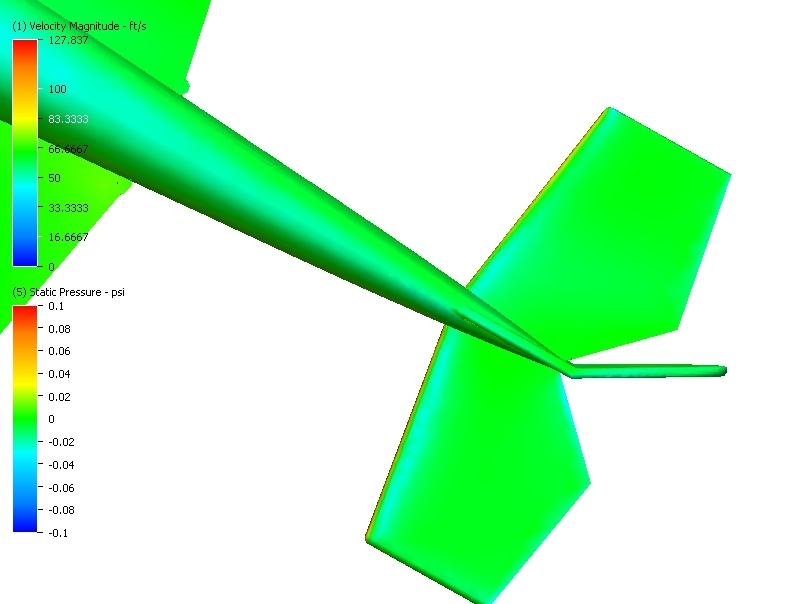

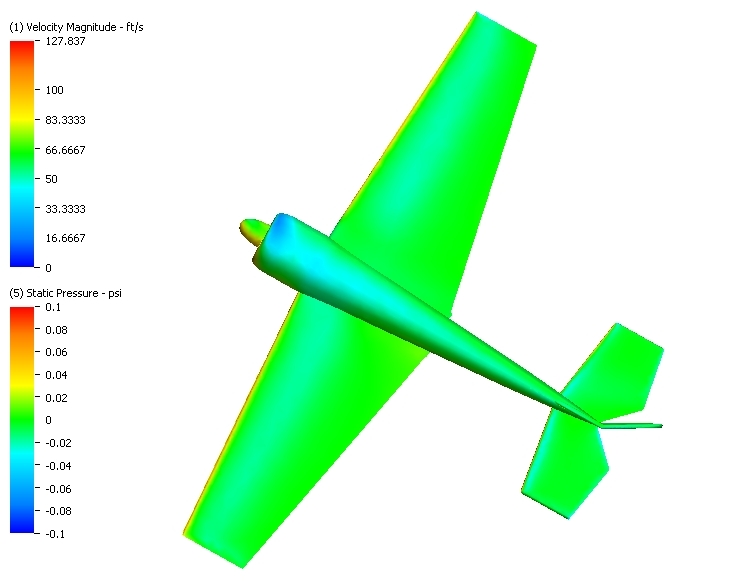

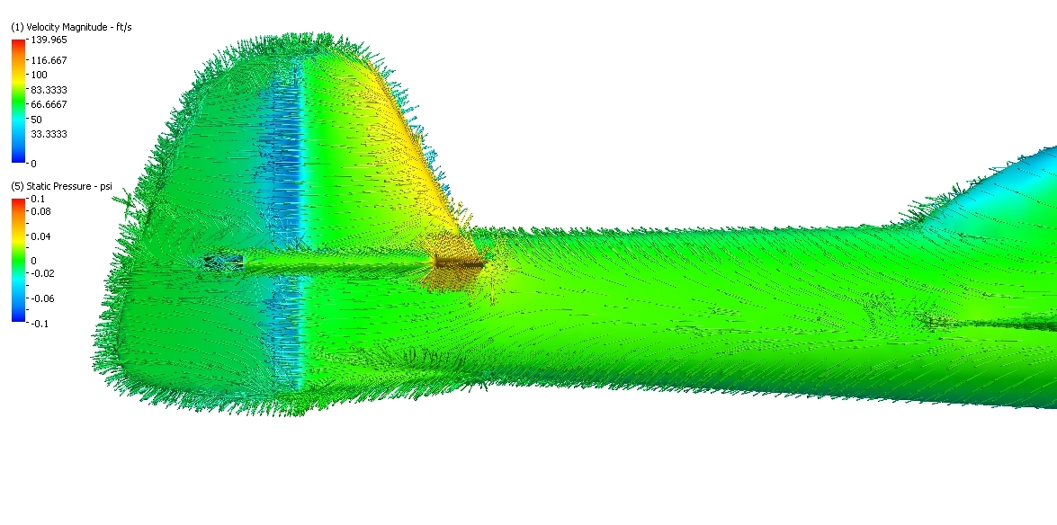

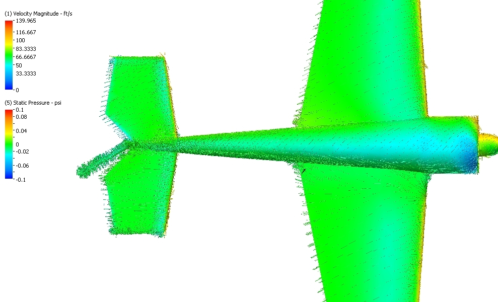

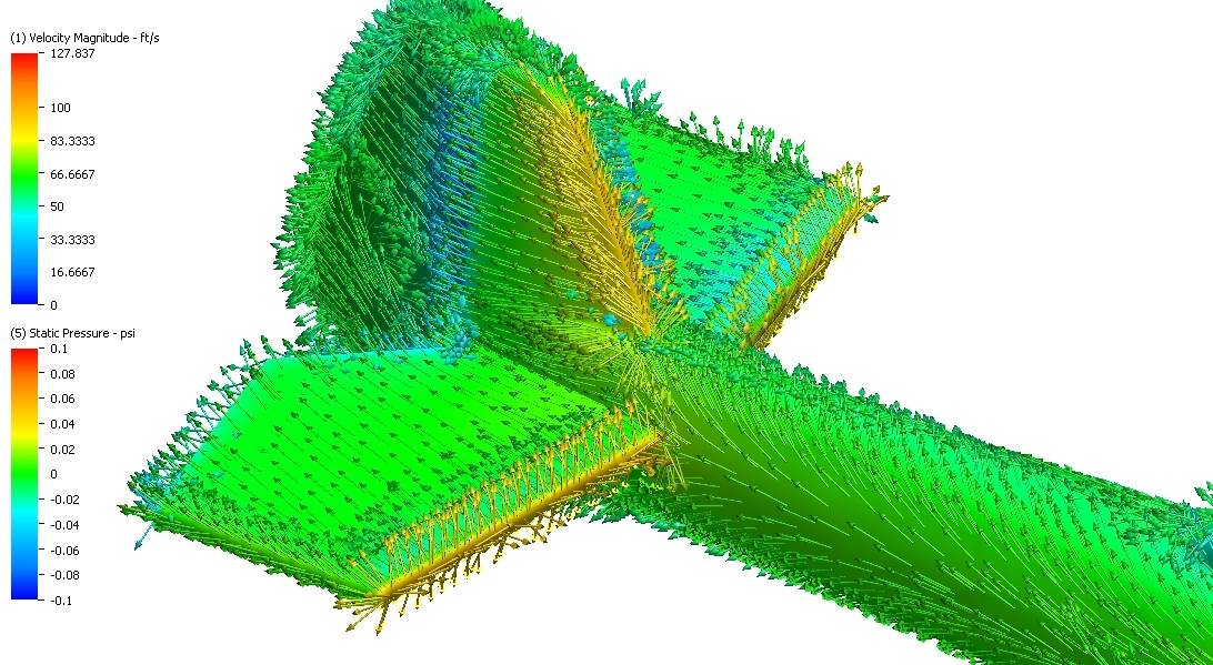

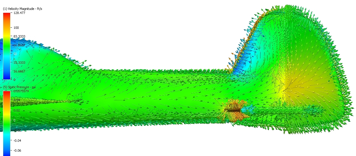

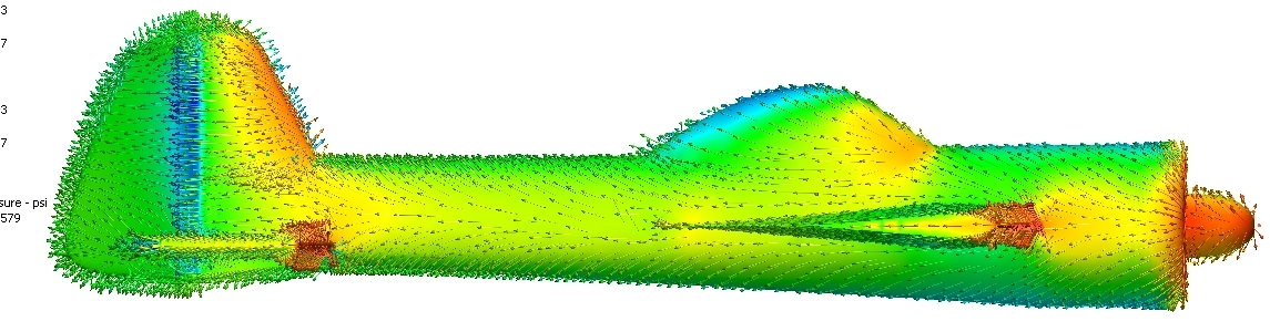

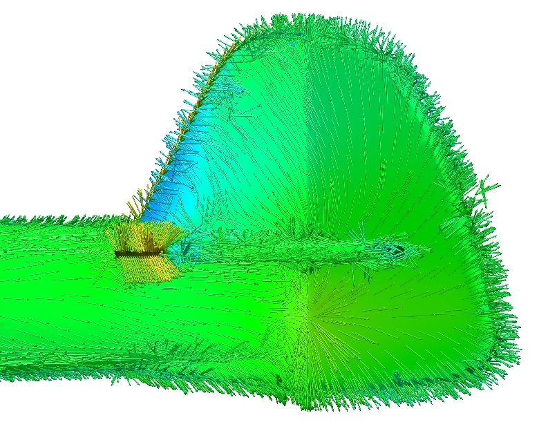

in a vertical upline... the downwash ought to be very close to 0 (Zero)
though there is a wake.....
IMHO, CG is not the best way to deal with Yaw-Pitch coupling....
Moving the CG fwd will result in a Hz Tail or decalage trim to compensate... this
will prolly have negative impacts elsewhere.. such as the upline you just fixed....
I have also speculated that adding additional vertical area to the underside of the fuselage (Subfin)
could influence the yaw-pitch coupling.... Perhaps that will be a future investigation of the simulation
I am doing as shown below???

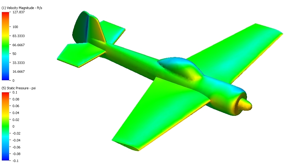

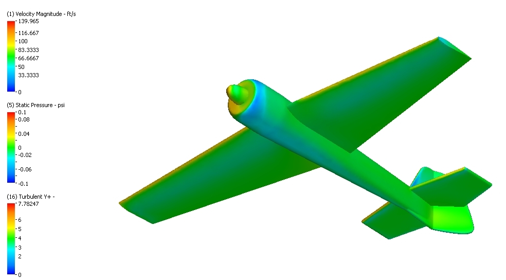

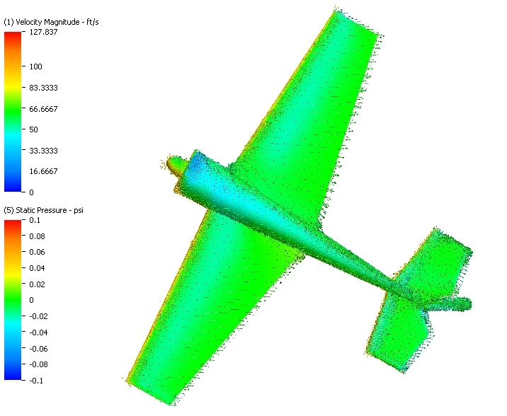

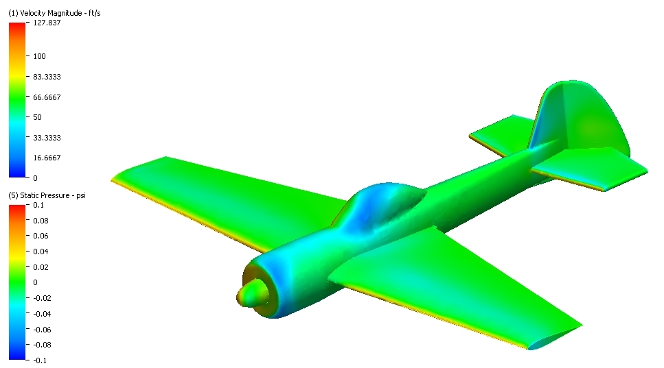

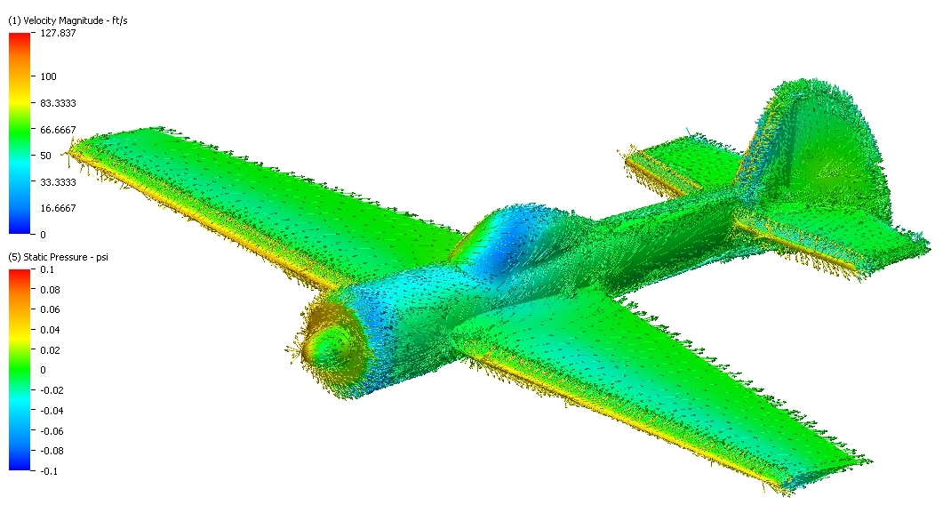

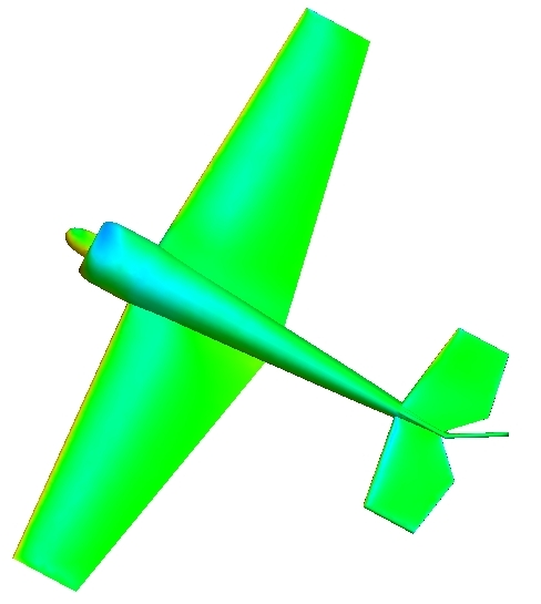

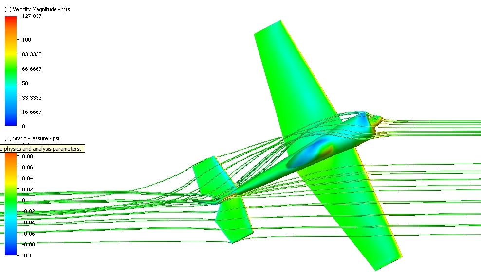

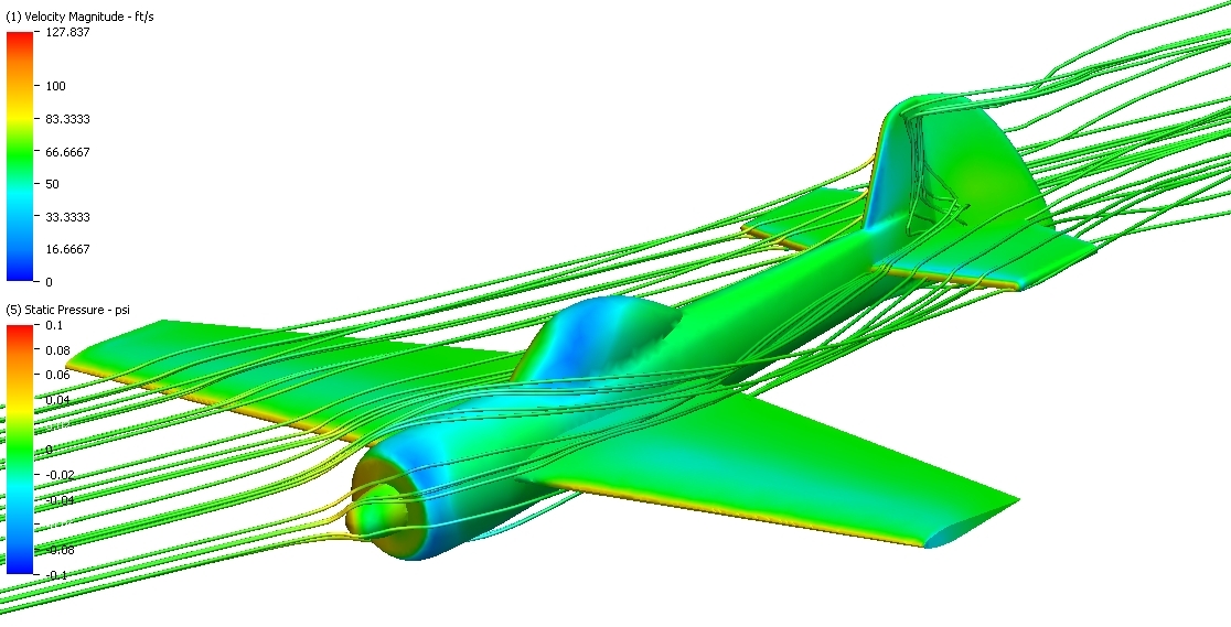

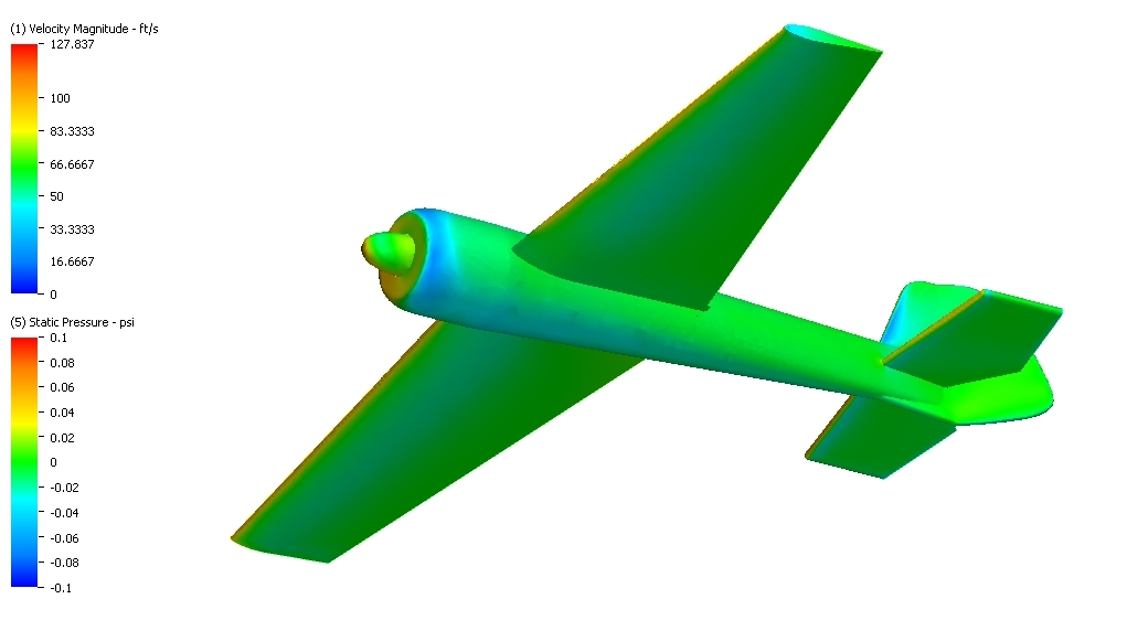

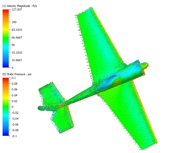

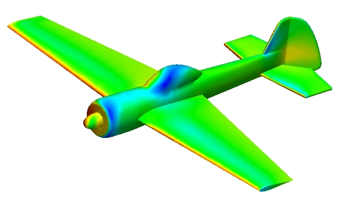

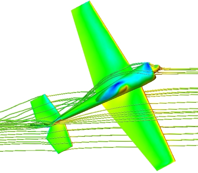

at the risk of bogarting this thread, I am going to post the results of a little CFD study I am doing in my spare time.....
I will first run the same model at 30 degrees beta with the horiz-stab in 3 positions.... "Low", "High" and "Centered"
Hope to discover any stab position impacts on yaw-pitch coupling....
Initially.. there are no thrust forces. For simplicity and to isolate the stab location effects, I have decided to not include
the thrust nor the spiral slipstream from the prop. Perhaps later I will add this boudary condition....
So the first set of images is of a popular scale aerobatic plane called a Yak 55. This virtual "Model" has a 78" wing
so similar in size to our pattern planes. I have located the stab in the low position
for this first run. Included are several images showing the pressure distribution and the surface vectors on the plane.
Though the vectors (Tufts) are interesting to look at, nothing is immediately revealed by these vectors.
The resulting Nose-Up-Pitch is revealed by interrogating the pressures on the horizontal tail... and it is here that
a small net force is measured pulling or pitching the plane towards the canopy.
Incidentally... there is also a Adverse Roll induced by this yaw as well...(Rolling moment opposite the rudder direction)
the last two images show the pressures on the top and bottom of the hz tail.... one can just barely see that the lower
side is slightly less pressure than the top side.... the actual measures force is about 5 ounces....
(Blue = low pressure, Red = high pressure)

VERY nice work. It's very interesting that your simulation is confirmed by my experiments: on the low pressure side of the fuselage there's a strong spanwise flow on the vertical tail and on the high pressure side the air is moving around the top and bottom of the fuselage to the low pressure side. Thanks for sharing your results.
Which CFD software did you use? I would be very interested in running such simulations for different configurations (with and without canalizer, fin fences, fuselage strakes) and measure the actual forces involved. I have the 3D models but i'm not a CFD specialist, is it difficult to learn?

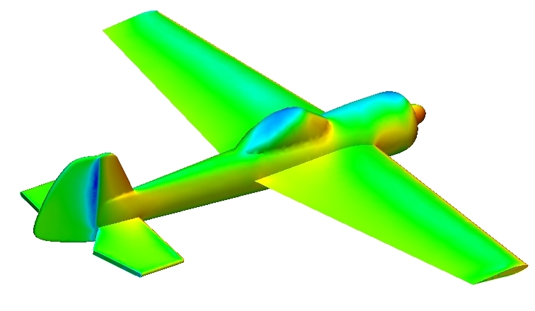

I did another run last nite... same boundary conditions... but with the horizontal stab located at the top of the fuse....
It almost looks like the low pressure on the leading edge og the vertical is superimposing on the top surface of the left stab...
perhaps this low pressure is the dominant Nose-Down pitch force???
the magnitude of the force is about 5 or 6 ounces.... and all of the force comes from the left stab... the pressures on the right
stab are a net zero...
#117
well... here is the third simulation with the stab in a central location.....
the pressure differences net out to zero... this would be where there
are no net pitch forces....
Interesting to note that in all three simulations, the flow over the right stab aligns with the freestreem...
the flow over the left stab has a lot of spanwise flow... towards the root of the stab...
additionally... there is a large spanwise flow on the side of the fin/rudder on the "Suction" side of the fuselage...
In the high stab case, there appears to be some interaction with the low pressure generated at the leading
edge of the fin on the left side.... looks like a small high pressure on the left side of the rudder in the low stab case...
I will need to more closely interrogate these results....
though I can measure pressures on the tail that indicate forces consistant with what I have experienced,
I still can't explain the mechanisms that cause the Yaw-Pitch coupling....

SORRY to Hijack your thread but I have a question for our learned friends.
My OXAI GALACTIK appears to have a small twist build into the stab i.e. right stab has less incidence than the left.
Is this a design feature by CPLR or a manufacturing defect.........just curious .

Hi Mavros,
I don't have a specific answer, but logic would suggest a manufacturing defect. I can see no aerodynamic benefit to asymmetrical stab incidence. How does it fly? Have you trimmed out the airplane satisfactorily? I would predict some pitch trim anomalies especially as speed varies and possibly some roll issues. That airplane has plug-in stabs, I believe, is the stab twisted (actually built crooked) or is there a problem with the stab tube holes?
