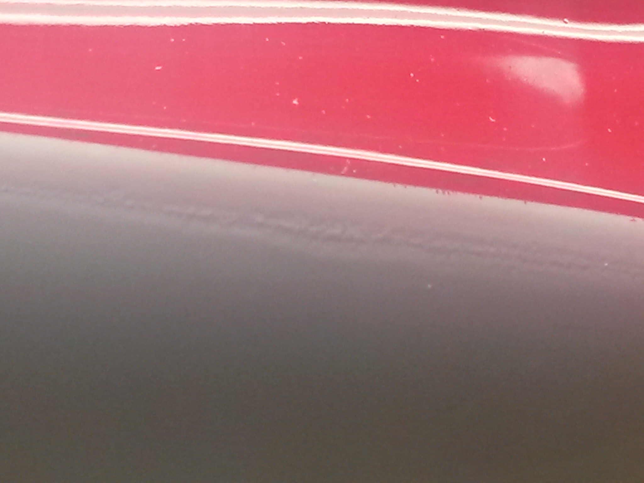

After repairing my pattern plane I got this funny little line in the paint. The color is acrylic from hobby lobby and cleared with automotive urethane. It's funny the mark is on the opposite side of the color change. I have several spots that did this but only on the white. Maybe a total of 12 to 14 inches of this phenomenon. The tape is 3M Fineline.
I don't mean to hijack your thread but thought this would be the best place to get an opinion

Not sure that I am the best answer but here is my experience.
I am curious, is the paint you used the Testor's Acrylic airbrush paint in the squarish bottles? like this? https://www.amazon.com/Testors-Airbr...airbrush+paint
If so, I had the same problem on my first paint job. It bled under the mactac vinyl masking leaving some spots like that, only worse. the base paint was the duplicolor white that I got from the auto store. Earlier in this thread I have pics showing what it came out like.

I used craft paint. Anitas I think. Goes on nice.
EDIT: I placed a photo of the exact paint I used as a base color in my previous post.
