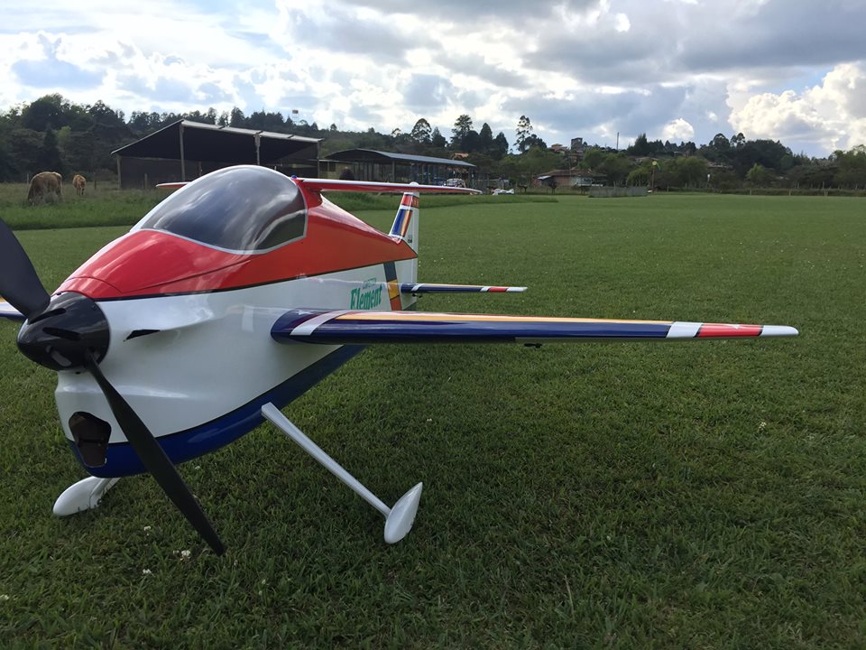

Thanks Dan
This plane is now in stock and a new shipment being produced.ySo far the response from the early buyers has been very positive. I've even had 2 tell me it's the best plane they ever flew. One is a former F3A USA Champion not named Andrew Jesky.
The design is available in two schemes.
http://www.f3aunlimited.com/aj-element
and the Essence scheme we have one left:
http://www.f3aunlimited.com/element-essence
I appreciate the call out for this new plane.'

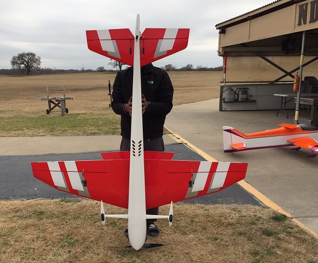

This is the other scheme we have the Essence/ Element. Nick Johnson sent these to us.
Nick, AC Glenn, and Parker Ferguson all received their planes on a Tuesday 2 weeks ago and had them in the air by Saturday. Built 3 planes together in 3 days. That's impressive!!!!.
http://www.f3aunlimited.com/element-essence?___SID=U
Thanks Mike Mueller
