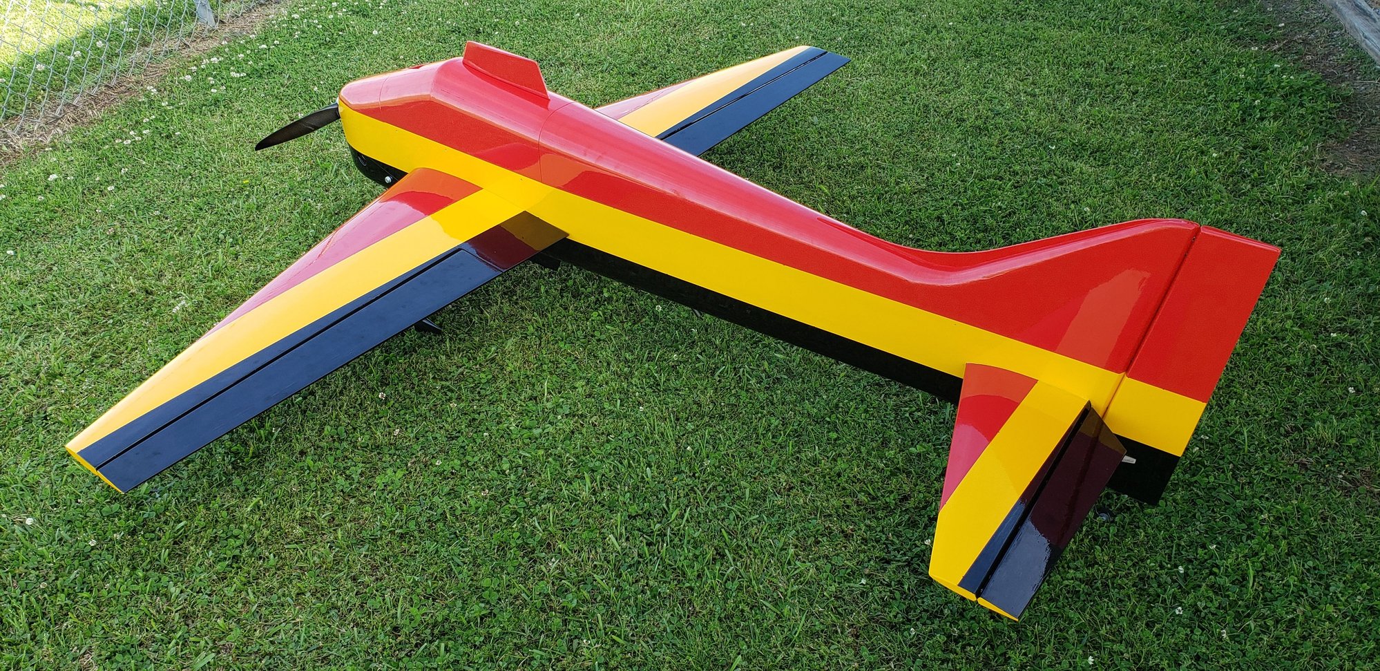

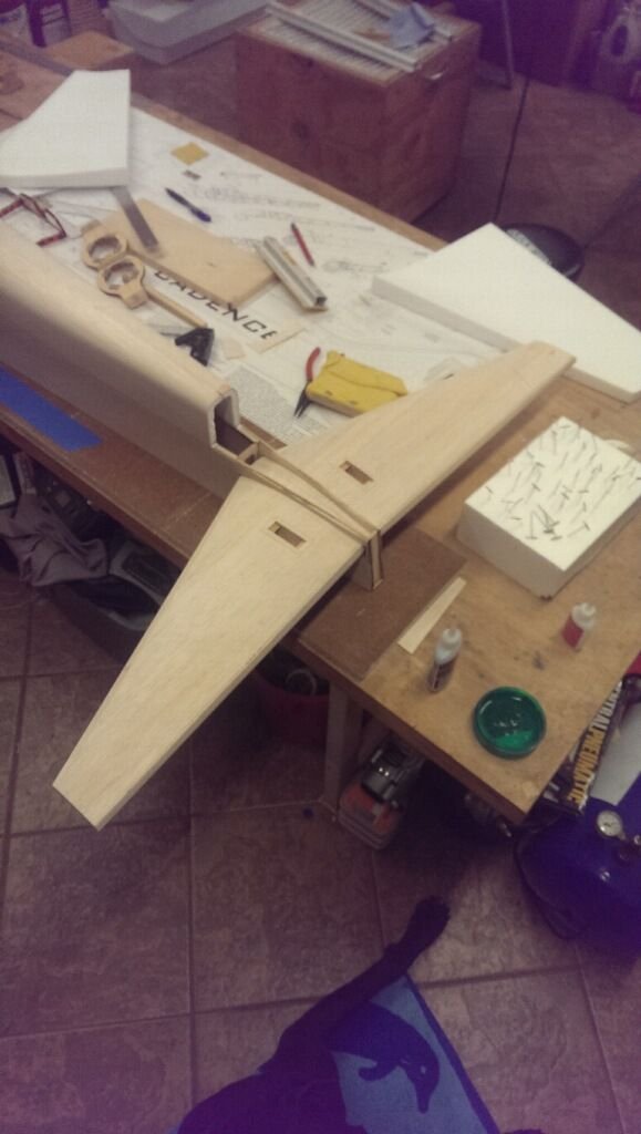

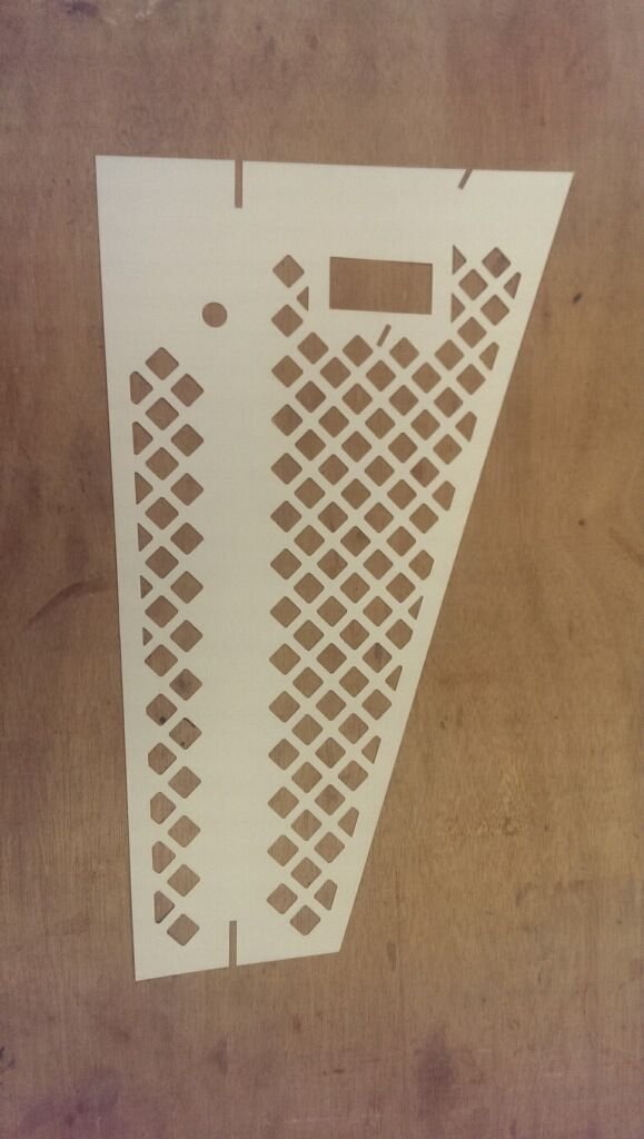

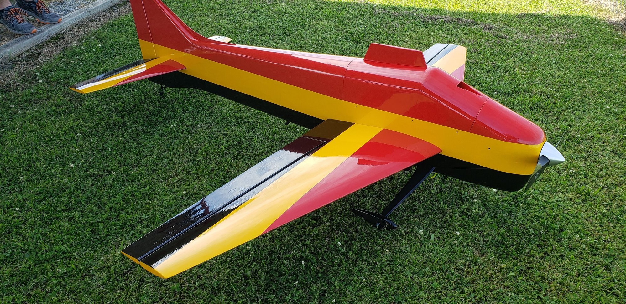

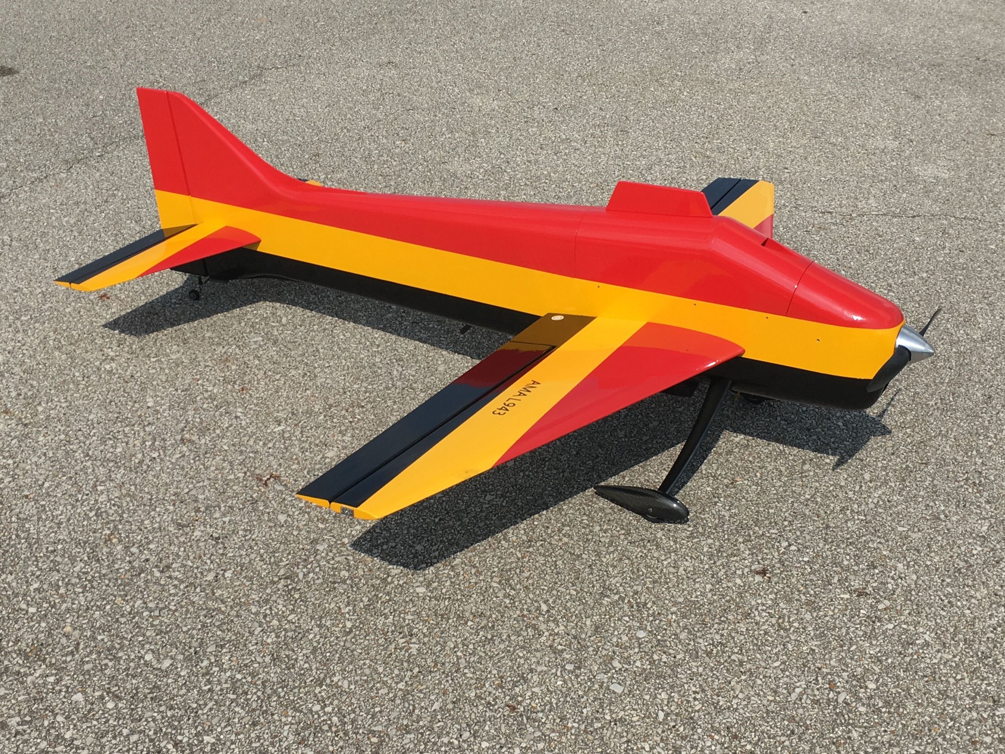

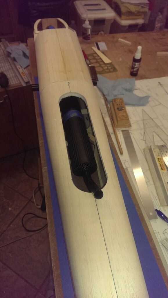

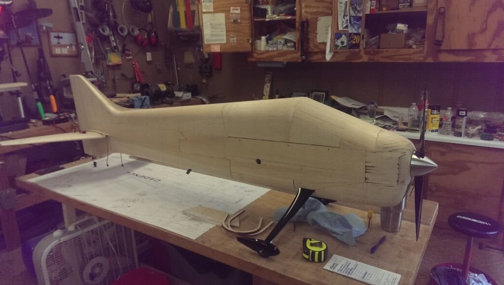

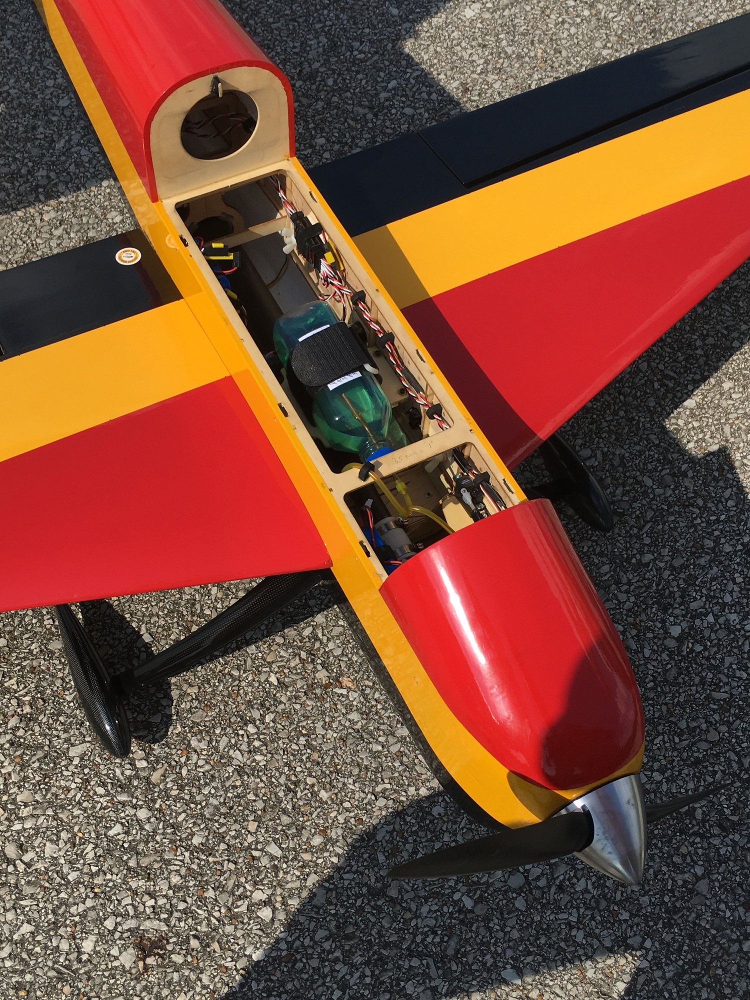

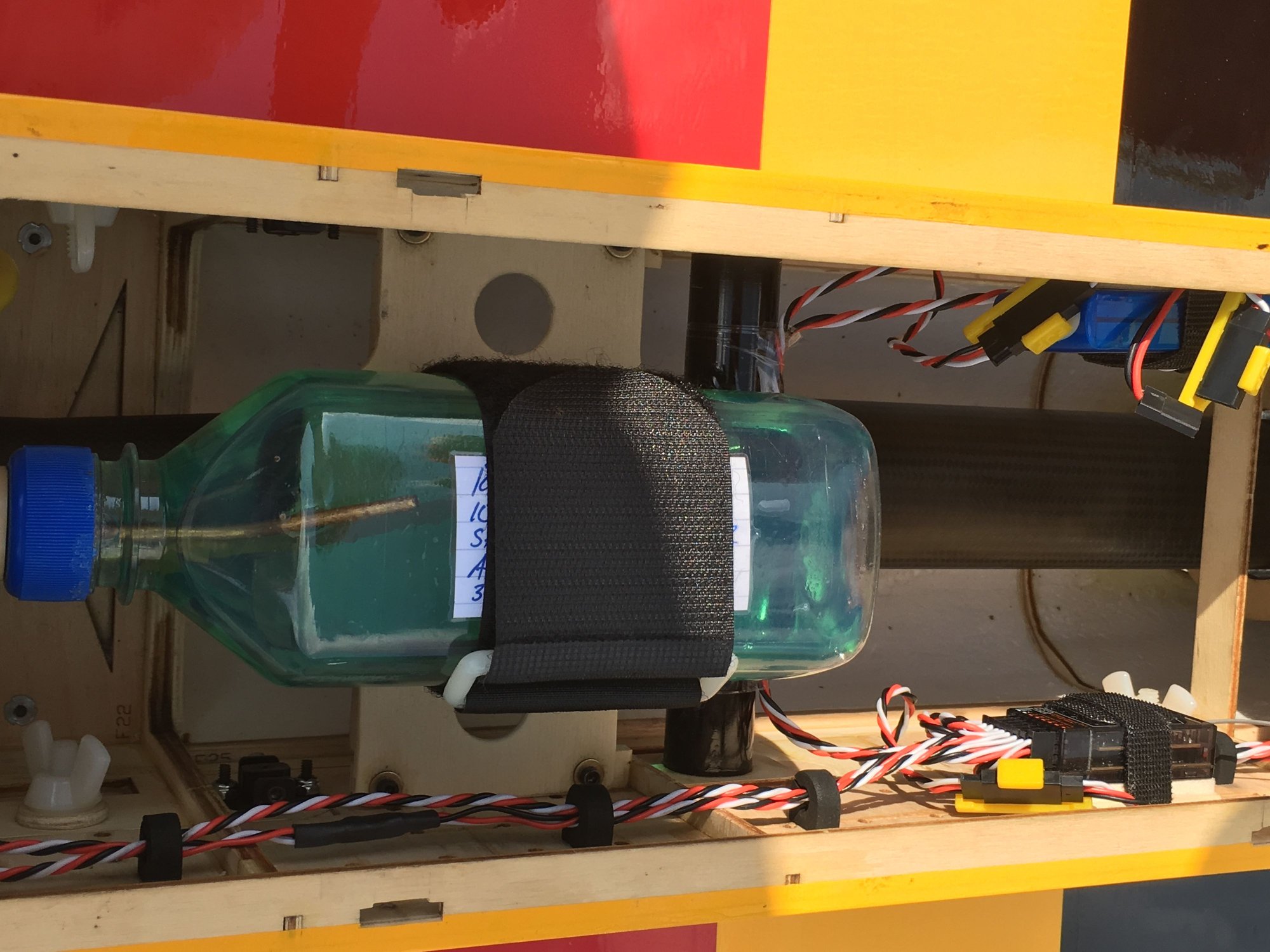

Just thought I would post the rough details of a nicely completed gas powered Cadence by Ryan Gonsoulin. Ryan did a masterful job on the build. He flys pretty well too. He had to move the landing gear plate down to allow the pipe assembly to go over the plate and stay inside the belly of the fuse. He cored all the foam and finished with monokote. The finish weight is 4620g. He found a hatori header and made a MTK style coupler from the header to his header extension pipe. So far, this has held up really well. He added an air inlet at the front of the canopy to make sure heat from the pipe was encouraged to go out the rear exit. That has worked very well. Prop is a falcon 20x10 but he plans to do some experimenting with APCs. Performance is excellent and noise is acceptable now that some cushion has been added to the chin cowl and canopy rails. Weight is 10lbs7oz (incl. 2oz of lead on the tail).
-Mark
Old 05-21-2019, 02:46 PM
flywilly
My Feedback: (121)
Join Date: Feb 2002
Location: glen allen, VA,
Posts: 2,264
Received 30 Likes on 29 Posts
Very nice workmanship! Is the engine soft mounted? What RPM is he getting out of that set-up?
Thanks!
Old 05-21-2019, 03:55 PM
flyintexan
flyintexan's Avatar
Join Date: Apr 2003
Location: tomball, TX
Posts: 1,207
Received 2 Likes on 1 Post
Motor is semi soft mounted..bolts from standoffs go thru rubber grommets designed to swell when tightened through the firewall. Plane is using 125mah per masters on rx pack so control surfaces are not seeing terrible vibration really. With 20x10 falcon and break in 1st gallon we saw 7250rpm. Getting on pipe is only needed in uplines and then its still not wide open. This prop is a little noisy so apc tests will be interesting. Ryan is planning to go to the US Nats so we are trying to hide noise as much as possible to make it as appealing as possible to the judges. Ryan is a very talented pilot and quickly learning all the nuances of pattern via help of D6 guys like Don Ramsey and Bryan Hebert. The plane is extremely close in trim and yes, it has the same ke horsepower that my own electric Cadence does. Im really pleased that someone local to me built a gas version as I drew the plans to allow gas, glow, and electric.
BTW, a full cadence kit will be raffled or auctioned at the US Nats.
-Mark
