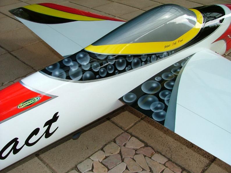

I have recently finished an Impact and it fly's great . . still have more trimming to do (I guess this is really an ongoing thing ).
It is the plain white / red version and was originally built (by someone else) for Electric. I converted it to glow, did some modifications and repainted it. It has OS140RX / Aeroslave CF pipe / Bolly gear and spats / JR and weighs 4.75kg (just under 10 1/2lbs).
Currently it is carrying a little down trim on the elevators which bothers me. I am playing with the wing adjusters, thust, and CG at the moment and it is getting better BUT if I built another, I would fit stab adjusters for sure. I am still considering performing some "surgery" and fitting them even now.
Anyhow . . great flying plane, for sure ! !

Very nice looking plane, Jeff! It looks like you did the same thing to the rudder that I did and plan to do on the second I'm building. Did you build your own rudder? 10 1/2 lbs! I hope to get the second one down there... On the first one my CG seemed in a good spot -- right behind the wing tube (suspended on fishing line through holes in the tube donuts) wings off and canopy on. I notice the foam "crutch" is absent -- that could save some weight but with a YS in front I might lose the tail. Good job -- it looks great. What paint did you use?
Tom

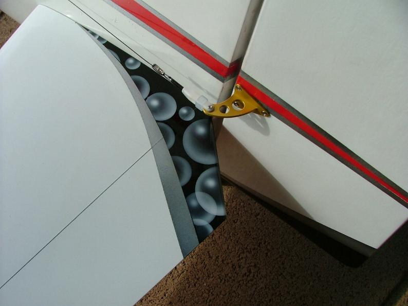

I have been flying my model for close to 3 years and it is still going strong with DZ160 power. When I test flew my model it trimmed out with a little down elevator and it felt very floaty in the wind. In my previous posts I mentioned the incidence changes I made as a result which I feel improved the model. The modele is quite sensitive to CG changes, I found the best compromise for CG was when it balanced on the rear of the tube with wings removed.
In your case I would add the adjusters because if you try to adjust your wing to remove your down trim you are going to screw up your thrust line. The inbuilt down thrust is marginal on this model and it needs a little more. I increased down thrust by adding more positive incidence on the wing and then reseting my stabs to remove any elevator trim. The other benefit to doing this was it raised the tail of the aircraft in level flight which makes the model present better with a more locked in feel. It also reduced my elevator to rudder mix to almost nothing. Couldn't be happier with the changes. Adding stab adjusters is not difficult in this model. The gator units available from Central Hobbies work well, if I recall correctly I remember posting some pictures in the build thread.
Good Luck,
Peter

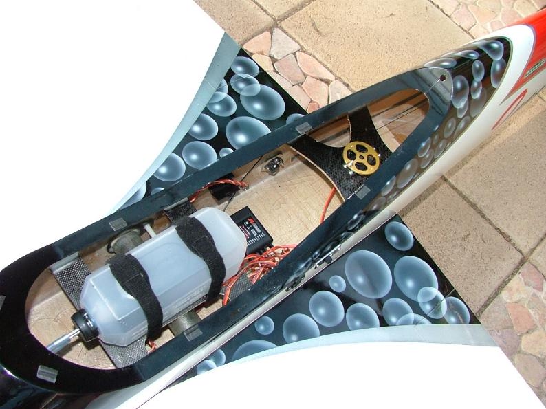

Thanks for the compliments guys . .
Tom,
1. No foam crutch = after I added the 8 strands of Carbon Tow (you can see running from the wing to the tailpost), it was SO noticably stiffer I thought adding anything else was just weight.
2. Yes the rudder is built up . . approx. 1/2 the weight of standard, however it has no counter-balance. I didn't like the standard hinge method and went for the double bevelled / hinged method.
3. Paint = Auto paint and clear is 2 pack - 2 coats . . as used for custom work. I didn't paint it ! a friend is an airbrush teacher and he owed me a favour ;-) I was worried about the weight and told him to "make it LIGHT". Anyway, the left wing had 17gms of paint added and the right 19gms . . not too bad (painted the tops only, and left the bottom plain red).
PeterP
Mine still has just a hint of down trim . . . and it was windy today (first comp of the year. Typical) and was a bit "floaty". Got another promo point though (85.5%. Percent required this year = 80%). One more point and I go to F3A . . hmmmmm . . might have to "throw" the next comp. I DON'T want to go to the Masters as an F3A newby []. PS. you should get a group of guys down to Shepparton this year . . It would be GREAT to see you there .
I think I will added the stab adjusters, like you say. Then I could put it back on the "board" and try your set-up. I need to get it a little more locked-in. It's not bad, but I know it could be better. Mine now balances on the rear of the tube (wings removed).
I have noticed how sensitive it is to thrust changes too. Just a little side thrust change made a lot of difference today.
I'll try to look through the build threads and see if I can find your stab adjuster post . . would be a help.
Cheers, JB
