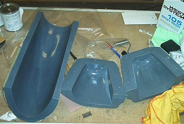

Last I knew Gator lost contact with their supplier for these and the supplier has the molds. I haven't had any luck getting them through Rodney either. (Rodney doesn't make them, someone else does.)
I may try to make them myself. It will be a learning experience!

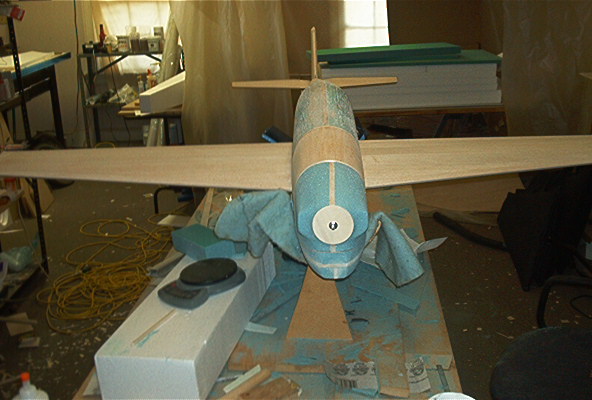

It's really not that hard Dave. It's time consuming and can get expensive. But not hard. I'm sure there's a cheap way of doing a one-off mold, but I just ain't wired like that. So when I make a mold, it's production level. And that gets expensive. I start out simple, but the A&P in me takes over and I just go nuts.
Get some polyurethane foam. Make a balsa backing and then just glue on the foam in a stack until it's bigger than the part. Then just sand it to rough shape. Apply resin and glass, and finish like normal. Paint it and wax the heck out of it. Then follow the instructions [link=http://www.cstsales.com/HTFiberglassMold.htm]here[/link] and it'll work out.
Here's a couple of quick snaps of my latest to give you an idea. If you have specific questions, ask in the composite forum here and guys like Mike James will hook you up.
-Mike

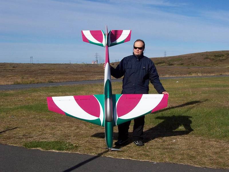

RE: Typhoon 2000 (TEMPEST) modifications thread
Here are some pictures of my Tempest and Mike thank you so much for sharing your design. The new wing works so well, it just seems to do everything well, it is real joy to fly.
The plane weights 4.360 kg and could be made lighter with a carbon pipe and wing tube, but I don't think it is necessary since the MVVS turns a 17x12 prop 8000rpm on 5% fuel and vertical performance is very good.
My plane flies with a little elevator trim and does pull slightly to the canopy when in knife edge.
Right now there are two fuel tanks in the plane because I had to use a header tank since the MVVS carb did not work well with a Perry pump.
I plan to get a Perry carb for my engine and if it works well I can get rid of the header tank and the plane should be easier to trim with the tank on the CG

That looks fantastic! And um....cold.....
You say yours pitches to the canopy on knife edge? What's your wing incidence set at? Just curious, most pitch slightly to the belly, and slightly to the canopy on down lines. Nothing that can't be mixed out though, and not as bad as most. I'll be interested in more info after a good deal of flight trimming!
