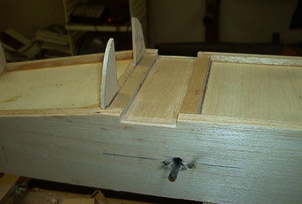

Okay, away we go!
First up, I am going to demonstrate the fixed gear conversion for the Typhoon 2000, included in the tempest mods. If you follow the drawings for the mods, these pictures will make better sense. If you're building a T2K and just want a fixed gear, this is for you too.
You begin by incorporating a 1/4" piece of aircraft ply into the structure just behind F2. This piece should be about 3" from front to rear, and stretch all teh way to the fuselage sides, under the doublers for the front wing adjusters. You will have to extend the wing adjuster doublers to about 3 1/4", with a small lip at the rear to capture the block. The main block should rest completely from side to side, butted against F2, under the doublers and resting on top of the 1/4" stringers. See attached pics.
(cont)

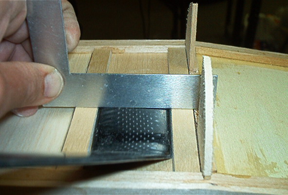

I use a Bolly F3A large gear. Cut it in half at the mounting flange.
Next, fabricate 2 spacer blocks that run between the stringers. These should be just over 1/2" wide, and about 3/16 thick. Put them in place, and sand them until you can lay a straight edge across the block with the gear in place, and the straight edge just barely clears the gear. By barely, I mean you couldn't get a credit card under there. When properly sanded for this clearance, glue in place with epoxy, taking care to rake the extra out from the corners as it squeezes out from under the spacer blocks. If it hardens, it will interfere with the gear. As you place the blocks, use the gear itself to help you locate the spacer blocks from front to rear. You want about a credit card's worth of clearance so it will slide in and out easily.
After the epoxy sets well, relieve the wood at the point where the gear will be inserted. Just use a small sanding drum, then a squared sanding stick to clean the corners.
(cont)

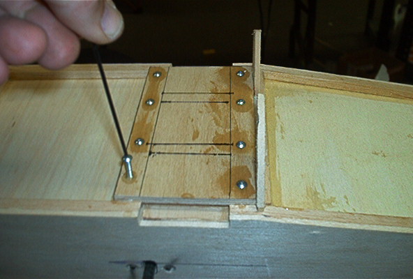

Now fabricate a bottom plate out of 3/16" aircraft ply. You can use 1/4" if you wish, but I have found 3/16 to be more than sufficient. Just don't make the mistake of using lite ply, or it's gonna suck to be you on your first landing.
Use epoxy and glue this piece on, and use a weight to make sure you have total contact. If you have gaps, it might seperate later.

After everything has cured, draw the outline of the inside edge of the spacer block. Also mark the location of the INSIDE edge of the pipe tunnel. Lastly, place your gear halves on top of the block and mark the edges of your gear block. You'll notice how close the pipe tunnel edge and the edge of the gear are: you'll have to dead center it with a drill later.
Now drill through the entire block at the center location of the spacer blocks, 4 across the front and 4 across the rear with a 3/32" drill. Be mindful of where your edges and pipe tunnel are, you don't want a head in the way! These are your pins, you will use #4x3/4" button head sheet metal screws. Install these screws with 2 hour epoxy (or just slow cure) but be sure and wipe off the excess epoxy. The points will barely protrude from the other side, but who cares, you can grind them flush if you wish.

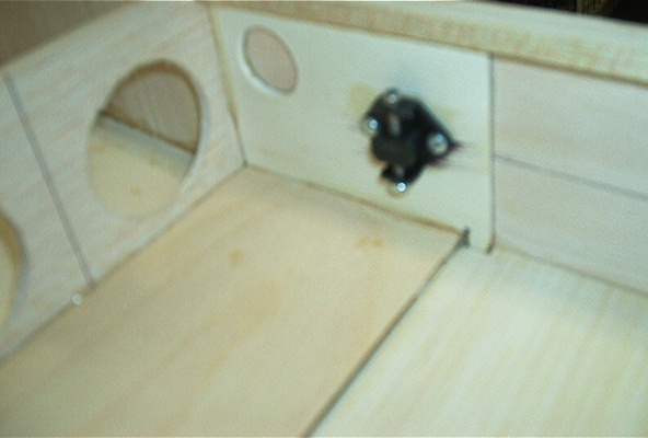

Now install your gear. Place it so the top edge is just inside of the fuse side. Drill a hole for a 4-40 machine screw to pass through in the center of the area we marked. Just use one screw, it's only a locator pin and doesn't really bear any stress. Drop the screw through to hold the gear in place.
Now drill and tap 6/32 threads at 2 locations which will be under the fuse bottom, outboard of the pipe tunnel. Be careful they are far enough away from the sides that you can get the head of the screw on from the other side. Just drill and tap the wood, gear and all. DO NOT try and put blind nuts here. If you do, you're gonna hate life come final assembly. Just tap the block, add a couple drops of thin CA, and re-tap. Trust me, it's plenty.
Screw it all together and flip the fuse over. Now just epoxy in some triangle stock to the doublers and F2, and voila....one gear block from hell. Now remove the screws and gear, as teh actual screws will be installed from the top during final assembly.
If you manage to break one, be sure and tell me how you did it. I have literally seen one go in full throttle, disintegrate the plane, and the gear block was still in one piece with the gear. The rest of the plane was powder.
