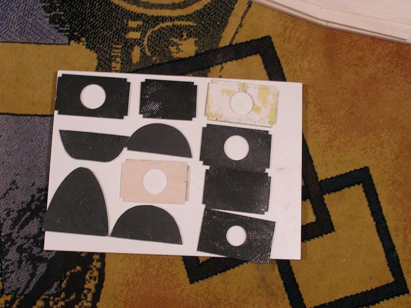

Hi
I attached carbon fiber cloth to the balsawood then put some resin on followed by some peel ply to give it a really smooth surface and nice and shiny as well as being strong. The carbon fiber clothes comes in blue red yelloe and black. I have almost finishe one set in black and the other in blue.
Troy

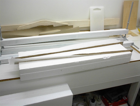

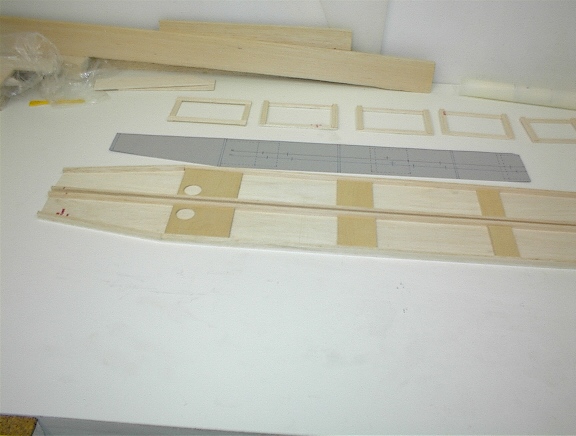

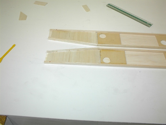

Mike, here are the first construction pictures of the Tempest.
I would like to try to build this one light, so I have been spending quite some time trying out brown paper for covering. The results being promising I really want to have a go at it.
On my Typhoon, there wasn't much left of the formers after all the lightening holes I had to make so I just used build up formers for this one.

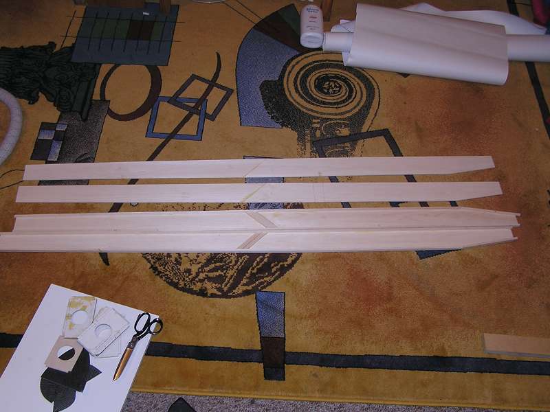

Hi Everyone
I have nearly finished cutting out all the pieces for my tempest. I have cut out 2 full sets of everything and are almost ready to start construction. I arent as quick as some of you other guys. Can anyone tell me what sort of fuse jig they use or have built. I went to order one from gatorrc but shipping is way to much to Australia. I hope to have half the fuse complete by the end of the week. I had the wing ribs cnc by a friend they came out really good and it only cost me a slab of beer, couldnt go wrong.

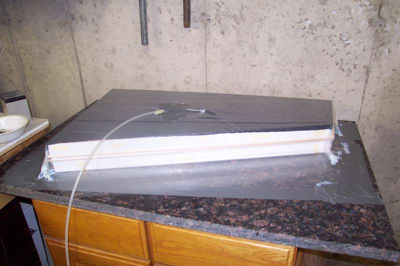

Hi Mike,
When it comes time to sheeting all that foam, consider clamping the cores under a vacuum. It sure beats stacking weights!
Scott

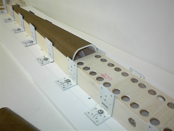

I have finished adding the floor into the fuselage.
Trying to save some weight, I drilled lightening holes into it.
Sig
Sig

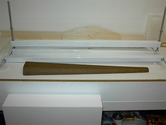

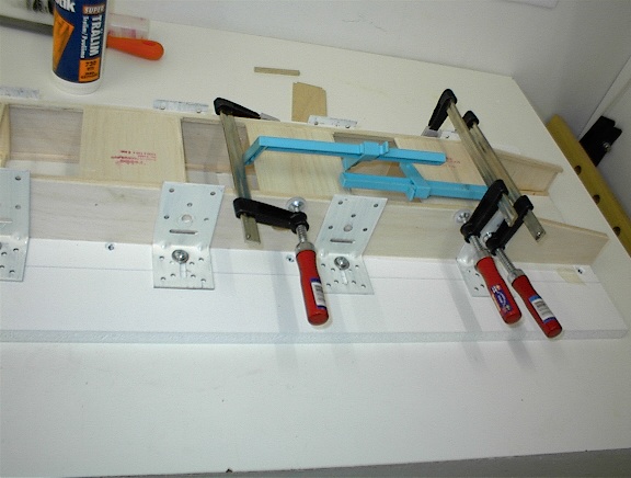

The bottom and the top of the fuselage will be foam, sheeted with brown paper and light fiber glass cloth in few places to add more strength.
I used wax paper in the off cuts and that gives a nice finish. Simple clamps makes it very easy to press the skin on.
Sig

The weight of the finished piece is 27 gr.
That is:
paper 8gr
foam 14gr
epoxy 5gr
It is surprisingly strong so it will be interesting to see how much the fuselage will weight and more importantly, if it will be strong enough !

Great photos SigK. What kind of brown paper do you use? The kind we pack things? Like the Kraft (r) type? I´ll try to make the same with my design. I´d try to add a couple of foam bulkheads just to stiffen the structure a little bit since I tend to grab my planes at the top....

I like your thoughts on removing weight from the structure via the use of lightening holes, considering you'll still need to build the pipe tunnel, a few additional holes on the fuse floor would be benifical ?

Wladimir,
I use covering paper for painters, it's a recycled paper, stronger than the typical wrapping paper. It comes in different weights, but I am using paper from 85 gr/m2 to 136 gr/m2. I tried every kind of paper I could lay my hands on and choose this one because it was the strongest and also when I cover it with plastic film the foam doesn't show through.
Schpankme
Yes I would like to make it lighter, but this is the floor of the pipe tunnel. If I cut more holes I don't know if the paper would isolate the heat from the pipe.
Sig
