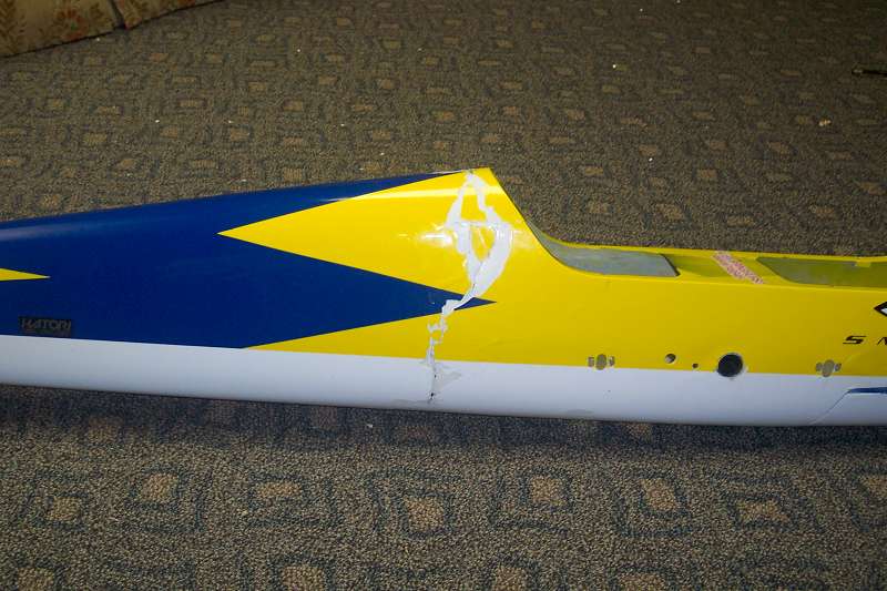

Does anybody have any experience repairing fiberglass fuses that have broken in half? Also, can anybody tell me why my YS 110 would progressively be getting worse and worse fuel milage, to the point that I ony got maybe 6 minutes max of flying at half throttle with a 16 oz tank before it ran out of fuel and this happened? It wasn't rich at all, just a little smoke. I'm running 30% CP hmm......

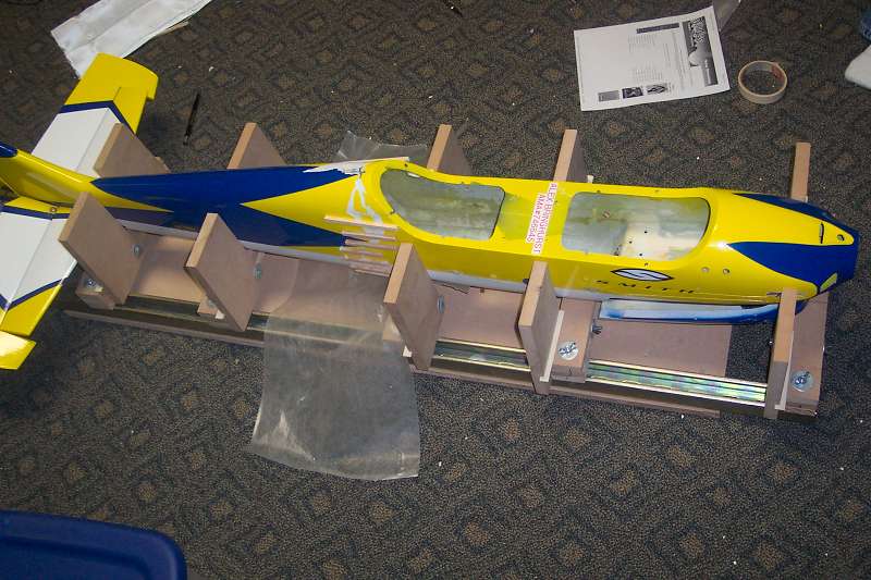

My 2c worth is to take your time and do it bit by bit. Photos below may give you some ideas:
- Thin CA is good to help tack bits together and help lock up minor cracks etc.
- Then fuse jig and balsa sticks on the outside to get it all locked up and straight. If you can't borrow a jig they aren't hard to make.
- Then glass cloth and/or other strengthening on the inside to lock it hold it all together.
- Lots of sanding and filling parties -- using either laminating epoxy and micro-balloons, or polyester car filler (I have used both without issue -- but tend to use epoxy for big filling - verging on structural - and polyester for minor holes). Then a filling primer and paint.
Sounds easy -- just takes time. Hope this gives some ideas.

I decided to hang onto the fuse since it will be a while before CA models could get me another. I also thought it would be a fun challenge to see if it could be fixed. So, I took David's advice and have proceeded to work on it. First I took all the old stuff out of it, all except the wing tube section and firewall. I'm going to make all new wood parts for it. These pictures show it after I cleaned all the edges with solvent and sanded the inside of the fuse so that the fiberglass would adhere better.

After all the edges were clean, I proceeded to put the puzzle back together. This took two people and some thin CA. Luckily, the break was quite clean and so it was easy to see where the two halves should line up. The pictures show it after all of it had been CA'd. It was actually very strong like that. I could hold it by one end and move it around and the other end didn't even budge. So that was encouraging. Then I put it in a fuse jig and made sure it was straight, and it was very close. I got so excited fixing it that I forgot to take any pictures of it. Anywho, once it was all straight in the jig, I then used sticks of balsa which were CA'd the the outside of the fuse. This didn't keep it in line so much as it helped to pull the few dents out to the right contour. Then, I used 6 oz fiberglass cloth on the inside. Should be able to work on it some more either today or tomorrow.

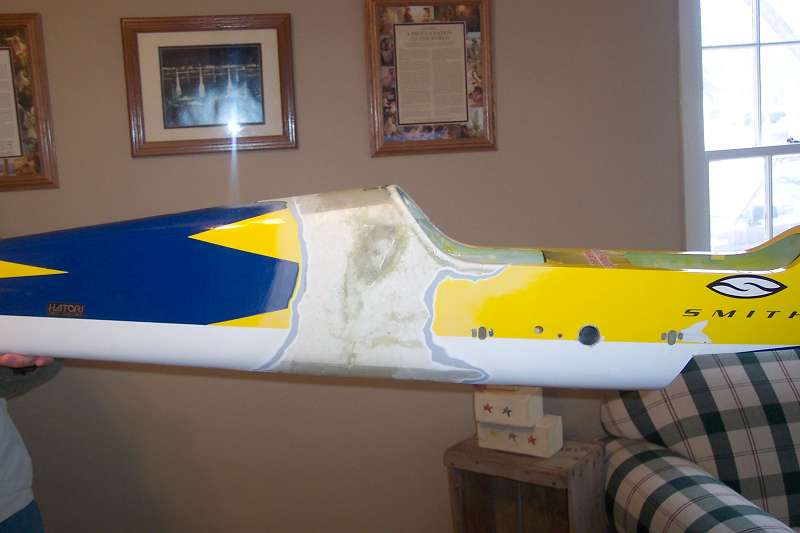

Here's a picture of it all braced and fiberglassed on the inside. Dave, how heavy of glass did you use on the exterior? I was thinking of using 2 oz, does that sound about right? Or if anyone else has any suggestions, I'm open. Until then, the sanding shall begin!
The answer to the stab question is yes and no. It has an indention in the fuse where you are suppose to cut out for the stab but it is still solid with the fuse. So, you could easily just cut the slot thinner for a thinner horizontal stab and fill the void with some light filler. I would think a Zafiro with thinner wings would be pretty cool.

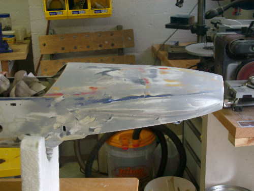

Awesome job. You have done a very nice job of cleaning it up and getting it back together. Hang in there and it will soon be as good as new! If your experience was the same as mine you start with great trepidation (and a view that it still may be a basket job!) but clean it up slowly, begin to tack it together bit by bit, and after an hour or so it begins to look like a plane -- and soon you wonder why you almost thought about not repairing it!!
On the Hydeaway, I didn't put cloth on the outside. Once I had the cloth on the inside I dug around with the tip of a knife on the outside to remove any loose (or potentially loose) chips in the original gel coat, and gouged out a few of the hairline cracks I had (on the nose impact there were quite a few of those). Then I filled it with laminating epoxy and micro-balloons -- and taped some heavier plastic document folders over it to force it into a reasonably smooth layer. I figured that would get into the gaps/holes and didn't leave me with the problem of having to sand down a outer cloth layer. The sanding on the sides of the fuse where yours broke will be a little harder to get smooth without sanding through the gel coat in place -- unfortunately only a big sanding block, a mix of 120 to 240 papers, and much patience will get you through that!!
And then I tested the repair. Crash 1 was radio going into failsafe on downwind for landing and it cruised into the ground on low throttle doing the damage you see in the three shots of the nose repair! 25 flights after I repaired it it had a mid air at a comp. that ripped off the right wing and sent it spiralling into a (dry) swamp. This time it broke right through the wing tube area -- but the nose I had prevoiusly repaired came out almost in tact!! (and this is the repair I was doing in the fuse jig photo above).

Well, it's done... almost. The fuse is back from the paint booth and I think it turned out pretty good. I have to go about putting all the radio gear back in and then it should be as good as new. It's very hard to tell where it broke. For people that never saw it before, they will never be able to tell where the break was. I'm confident that it will fly just fine. Thanks to Dave for all the advice on how to fix it. I'll post a reply after it flies again. Juat gotta wait for decent weather now.
