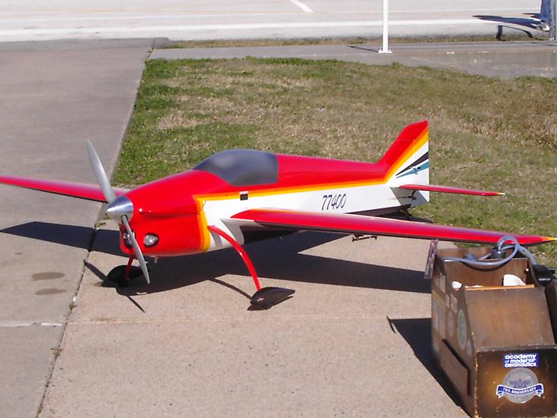

Flew the OTOP for the first time today. It was kind of hard to do any real trimming because
the wind was blowing in gusts up to 30 mph but it flew straight and level with no elevator or
aileron trim, a pleasant surprise. The only adjustment I made was to tame down the aileron
throws because the ailerons are VERY effective and needed way less than what I started with.
I have the CG right behind the wing tube and will probably move it forward just a bit but I'll
wait to get a few more flights before I decide about that, it just seems a little elevator sensitive
with the small amount of elevator travel it has. The YS 1.40 pulls it easily at no more than 1/4
throttle and even on long vertical pulls it doesn't need full throttle even running very rich. I only
got in two flights but I think it's going to be a good one.
tommy s

Finally got around to weighing the OTOP today. I made no attempt to lighten the
airframe although there are many places to do so. I added servo mounts to the wings
with triangle braces inside so the servos could be mounted outside instead of inside
the wings, fuel tank position braces inside the fuselage, added a 2 oz header tank, and
various pieces added to strengthen the fuselage in different places. The fuselage itself
can be trimmed considerably at each opening if needed as the flange that overhangs each
opening is about 3/4". Even with all this it comes out to 10lbs-13ozs. Each wing half weighs
an identical 17.91 ozs with servos, linkage, extension, paint and vinyl graphics-ready to fly.
I can see enough places to lighten the airplane that if needed I believe it can be made to
come out at 10 lbs or slightly under. This should be a good candidate for E-Power.
We'll find out soon, there will be an electric OTOP flying here in Houston in a couple of weeks.
tommy s

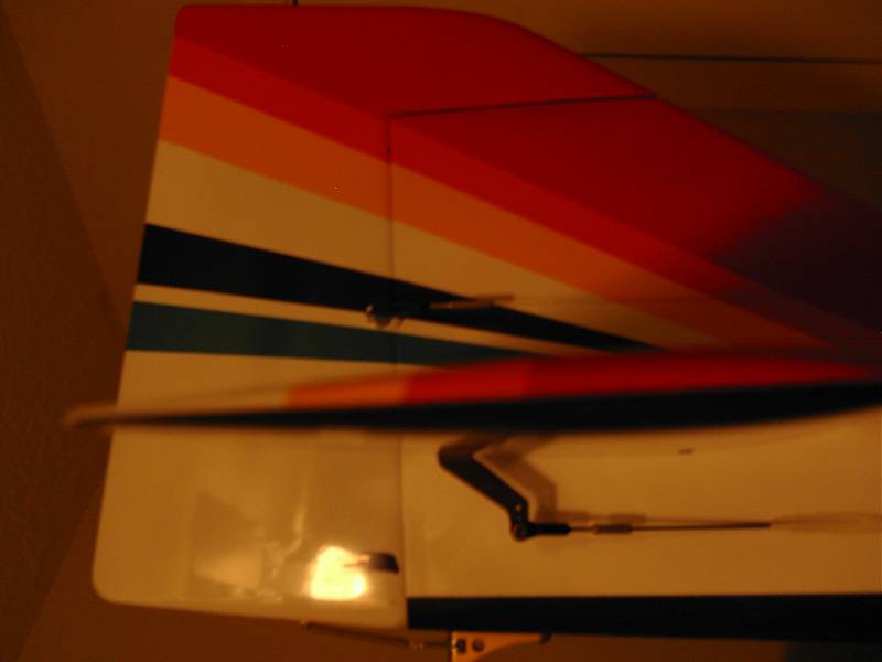

The control horns are flat phenolic pieces that are the same as in the Impact. They are
epoxied into slots that are pre cut in the control surfaces. They slant forward to pivot
over the hinge line. On mine I replaced the stock rudder horns with MK aluminum
horns because I moved the attachment point from the bottom of the rudder to near the
middle and the MK horns made that move a lot easier, just drilled one hole. Now the
pull-pull cables are a straight shot from the rudder servo to the rudder. If you use the
stock set up the rudder servo is near the middle of the fuselage and the rudder horn is
near the bottom so the cables are at an angle. I prefer the straight mounting.
tommy s

The OTOP and the IMPACT both have internally mounted aileron servos which in my
opinion are a pain in the butt to install or remove for maintenance. Most of the guys
around her, myself included, cut holes to externally mount the servos just like we've
always done on other airplanes. After I cut out for the servos I added small lite ply
strips across the ends of the cutout underneath the wing sheeting so the servo is flush
with the surface of the wing then added small triangle braces from the new mounting strips
to the original mounts inside the wing. The servo can be removed in less than a minute
if needed and the standaed length linkage makes full use of the servos resolution unlike
the original long horns. Makes life a whole lot easier all the way around and the modification
only takes around 30 minutes. If you look at the picture of my OTOP a couple of posts back
you can see the servos under the wings.
tommy s
PS: I also removed the phenolic control horns and replaced them with MK aluminum horns
like the ones OXAI uses. They are much more solid than the original ones which flex way
too much for my liking.
