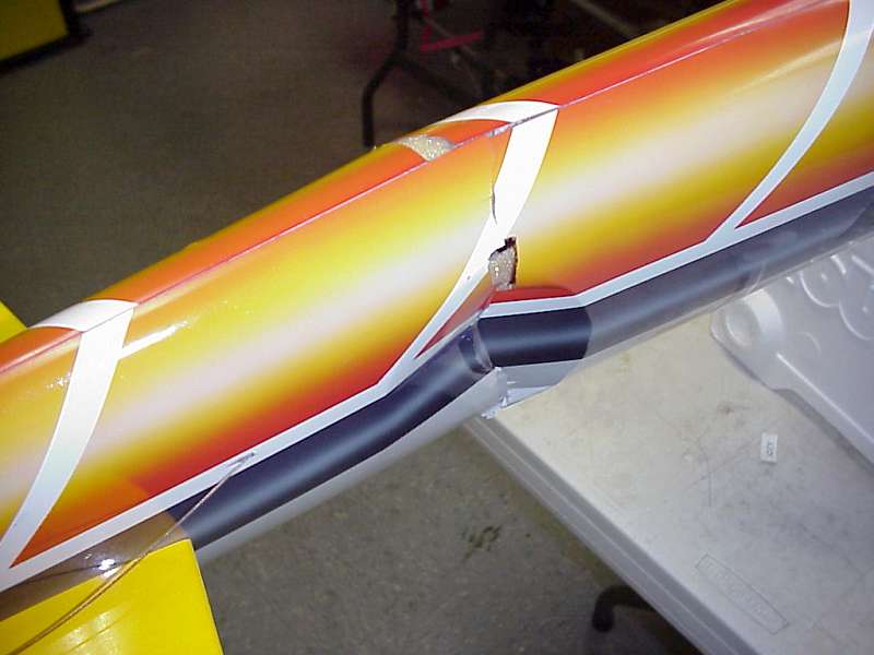

Anyone having problems with this plane. Ours had the tail section of the fuse fail in the first few flights even with the crutch installed as requested by manufacturer. The only thing they would do is send us an updated version for an additional $400. Didn't seem like much of a deal to me, putting good money after bad. Our plane wasn't abused, just flown through typical pattern manuvers, not even any snaps. It failed just ahead of the stab. We're real lucky to have gotten it back on the ground. I'm just wondering if anyone else has had a similar problem. No doudt, I don't recommend the airplane OR the company.

Did you use the factory supplied crutch or did you make your own? How about wing adjusters? Did you use them or did you use the factory method of installing the wings? How about rudder? Did you use the factory rudder with the factory supplied hinges or did you go with different ones?

I was at the flying field when this one came a part, I thought I saw the stab hit the fuse serveral times. The pilot got lucky that it stop fluttering enough in time to land it.

Most of you would be aware that a number of Composite ARF "IMPACT" have failed from suspected rudder flutter.
I raise a couple of questions to this forum;
I know that the purpose of counterbalances are to reduce the loads on servos and linkages in our application but what are the side effects.
Can a rudder counterbalance create undesired torsional stresses on the fuselage?
Can a poorly configured and tensioned pull-pull linkage to the rudder be more susceptible to flutter if the rudder has a counterbalance?
What other types of forces are at play with counterbalances?
I am just trying to find a reason for the relatively high failure rates against this design.

RE: Composite ARF Impact problems?
Someone has suggested that it is a rudder weight issue.
If models are failing with the crutch installed that dispells the theory of the fuse sides buckling.
Would it be possible for everyone who has had a model fail to post the weight of their rudders. That is if there is anything left. Please mention if hinges and horn are still attached.
The weight of my rudder with horn is 65grams - I havent flown it yet but I thought I would post this to get things started.
Hopefully we can get to the bottom of this.
Peter

Mine failed last wednesday. This airplane has logged over 100 flights with no problems. It was one of the early kits built last august it has pull pull rudder and a single elevator servo with Central Hobbies carbon fiber pushrod system for elevator
The seam from the base of the rudder fin to the top and one side of the rudder post came apart there was no seam tape on the internal seam. the airplane was flying straight and level when the failure occured. The fact that flutter initiates these failures may be true but the ultimate reason for the failures is lack of air frame strength which in my opinion is the results of poor design and/or failure to provide adequate support in the tail area which allows the fuselade to oil can when just the right force is applied in the direction that causes the fuselage to kink in or twist to the point of failure.
I havent been able to contact Composite-arf or my sales rep to date they don't answer my post's
For all those who are flying these airplanes I think you have a ticking time bomb unless you have modified the airframe to carry the load which is very difficult to do after the plane is built.

Buddy did yours have the internal formers installed or a crutch.
Were you going fast when it broke? Wing adjusters or the fixed pin for the wing?

No it has no former or ladder frame. I had just rolled out of the bunt manuever wind was about fifteen MPH blowing out. I think the combination of right rudder and up elevator during the roll out provided the stress that resulted in initiating the failure but the actual failure occured in atraight flight when I powered up for the double embelman at the center of the box. This airplane has been flown on a regular basis in four or more contests over a period of eight month's including many practice flights.
I think that the seam in the vertical fin opened up on the left side first due to the absence of seam tape required to strengthen the joint allowing wind forces to enter the opening which initiated the failure. The rudder pull-pull is perfect, absolutely no slop, elevators the same no slop.elevator push rods are supported by a ladder frame which is secured to the top of the stab tube in the rear and several cross members in the fuselage. all of these are still in place leading me to believe that the failure was not a hormonic vibration or flutter but a side force which caused the fuselage to oil can to the left as indicated by the compression ripples on that side versus tension cracks on the right side again leading me to believe that failures are only experianced when the exact forces are combined to reach the critical design limits of the airframe.
I was as in other cases able to land the airplane without further damage and would like to locate someone who has successfully repaired one of these to find out if repairs are possible and how they did it.
Also I would like to hear feed back from those who were able to get a response from Composite-ARF
They state that there are over 350 sold with a few failures, but it looks like there are more than a few, I wonder how many? Seems to me that they should do something to help those who suffered the loss that was due to their inadequate design. I guess we will see what they are made of before this is over.
This is a sweet flying design in every respect and I would like to be able to fix it but havent figured out where or how to start.

repairing the fuselage on an OTOP , which is the same material as the Impact as I understand it.
Maybe he could tell us how he did it. Dauphin never fixed his. The fuse is a write-off.
Cheers
Peter
Hi Gents of the truly lovely pattern world !
I see a lot of mails regarding the Impact and the apparently weak tail section, but I do not see so many descriptions of what linkage that is being used for the rudder. To me, it seems a poor solution to use the suggested pin hinges, that are not supported for the first 10 millimeter going out of the rudder post, since this could cause flutter in the rudder.
I know it won't bring your aeroplane back in good shape but did you use the above solution ?
I am considering to order one Impact myself bacause I think it holds the overall best price/ quality to market right now.
Let me know what you think
Best regards Beetlejuice
Beetlejuice,
I don't think that is the solution my friend. I don't know what everyone else did but
I have personally seen Buddys airplane and it was built by a master builder who did
not install the rudder per the instructions. There is no slop or unsupported hinges on
his airplane.
tommy s
