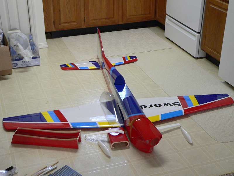

I got a 2M pattern plane called Sword off eBay.
So far, it is doable under 11lb.
Here are the weight of each components.
All the weights are in grams.

Total weight 2909 grams. All including CA type hinges.
Pictures below shows the entire airframe.

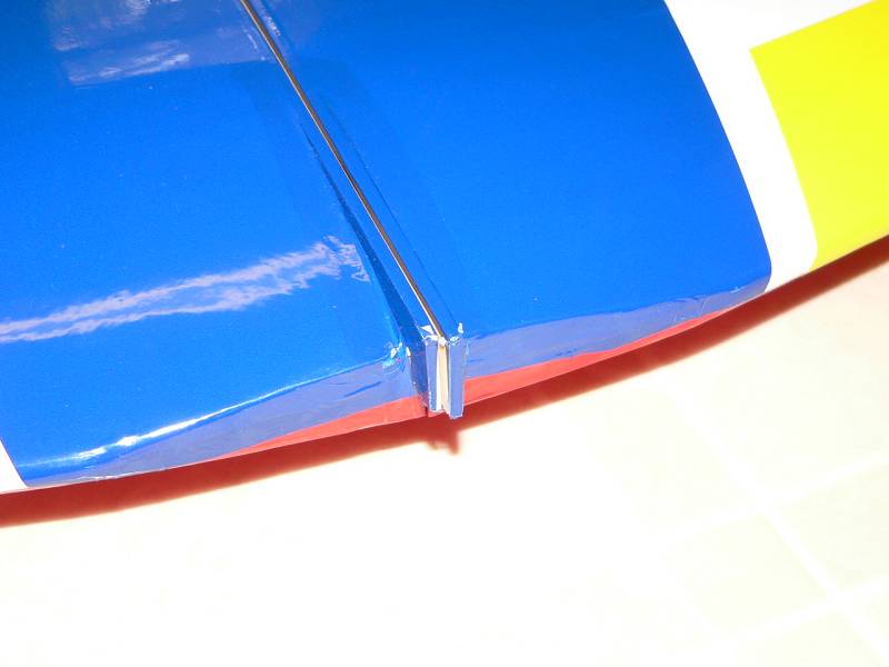

Horizontal stab mounting dowels are not at the same position so the incidences on two horizontal stabs are different.
I will have to check the diameter of the Gator stab tube again, because it did not fit in the stab halves.
I am not sure if GatorRC will sell the adjusters only. I just don't want to use the adjusters out of my Gator stab kit.
My wing halves are curved at leading edges. Not much, but it is visible when you look at the leading edges from side. It's like >>> ~

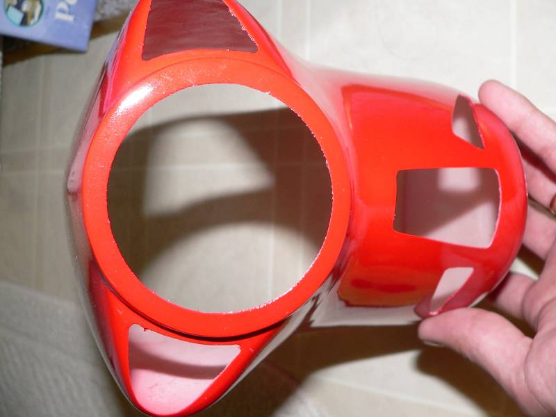

The picture of cowl may show the different curve right above the air inlet holes. The paint chips away really easy, so be careful.
I belive the two holes right next to the header tunnel are for the access of firewall, otherwise the two holes may not be a good idea since I may have to put RX pack behind the firewall.

I just measured the front of the cowl.
Guess what? the cowl is not perfectly round If I measure horizontally, it is around 81.5mm, vertically 79mm.
So, the spinner will be 3" Tru-turn standard with 120 slot. However, I have not measured the length of the fuse yet.
If you are going to use standard spinner like I do to save $$, adjust the engine mounting distance accordingly.
