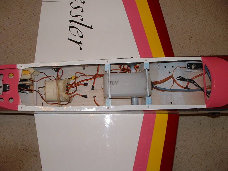

DEPS is basically complete and the elevator servo is installed. Im a little pissed that my support is crooked, but it looked straight when I set it in. It doesnt seem to effect the free travel so Im going to leave it,,, (maybe not if I can cut it loose and reset it I will), I dont want to take a chance on damaging the fuse by pulling it out. .
All I need to do now is setup the ends on the elevators and connect the linkage to the servo arm. I will do that later. ...
Edit: servo arm linkage is now connected and moves very smoothly. I am very pleased.

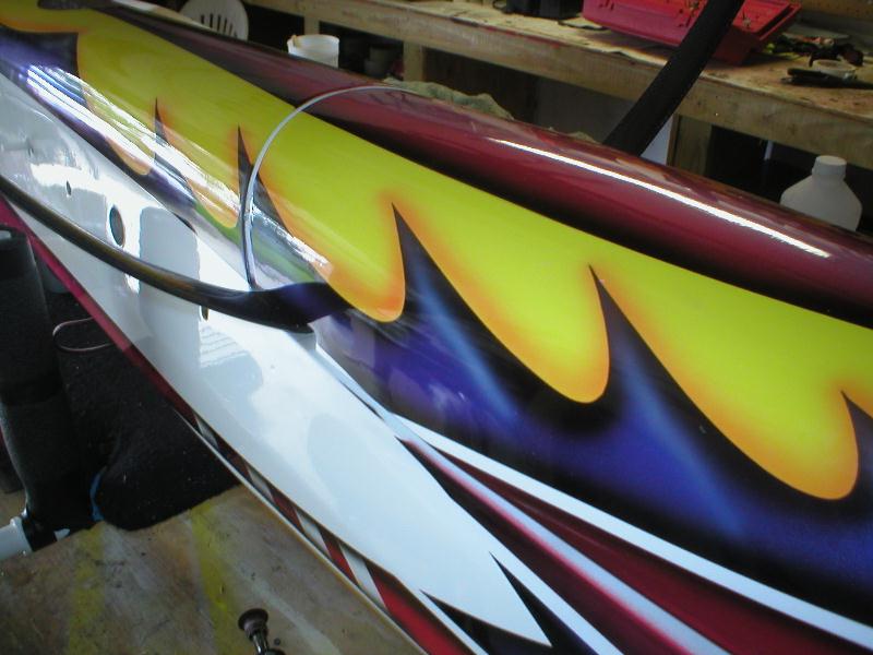

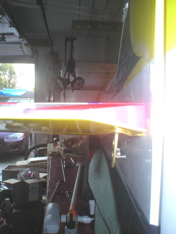

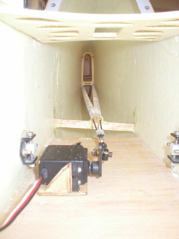

Mike,
Attached is two pictures of my side mount elevator servo. I used 1/4" end grained balsa as a side to side stiffner to reduce the pipe floor flex. This installation was pull-pull cable. My elevator servo mountng bracket broke loose with only one side to side brace. I then put one brace in front and a second behind the servo. This modification cured the pipe floor flex. It would be best if the brace can also tie into the fues side.
Steve
Steve

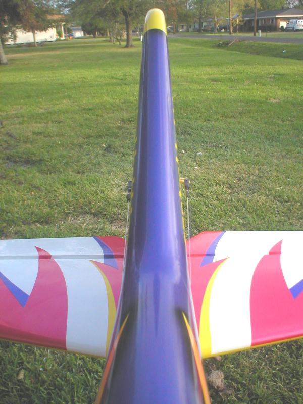

RE: Genesis ARF build, its here.

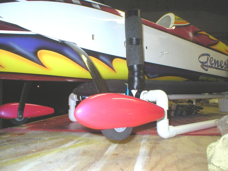

Pull pull is completed. This part was too easy. A little scary.
All I had to do to the fuselage was slightly trim out the exit holes (Which were already marked from the factory[8D]). I used a Central Hobbies pull pull hookup, but I intend to switch the wires with some kevlar.

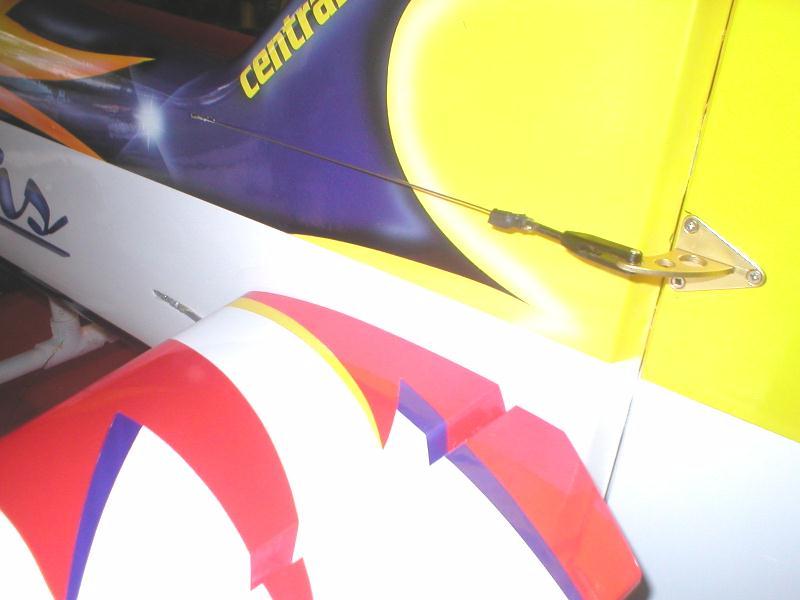

OK I found another flaw but Im not sure if it is significant enough to worry about. The left elevator half is thinner than the left stab at the root. Now out at the tip of the elevator they match up fine. I would estimate that the elevator is about 1/16-3/32 thinner than the stab. It looks like I may have gotten an elevator from a different stabilizer or something. There is no way they were cut out from the exact same stab, I just cant see how unless they sanded the heck out of the elevator. Maybe Im just being too picky, I am trying to get in touch with Chip and see what he thinks. What effects if any may this have on flight???..
As you can see in the picture, the bottom is closer to flush than the top.

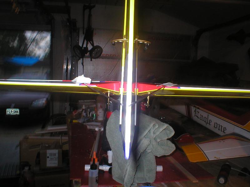

Finally the rear pushrod connectors are dry and the rudder and elevator servos are being driven by the TX in these pics. Pic on left neutral, pic in the middle full up, pic on the right full down... Everything moving in perfect symmetry with zero linkage tweeking.. Apparently the slight variance in thickness isnt going to effect the throw balance,,,,
Todd you were right, when I hooked up the linkage it pulled the twist out.

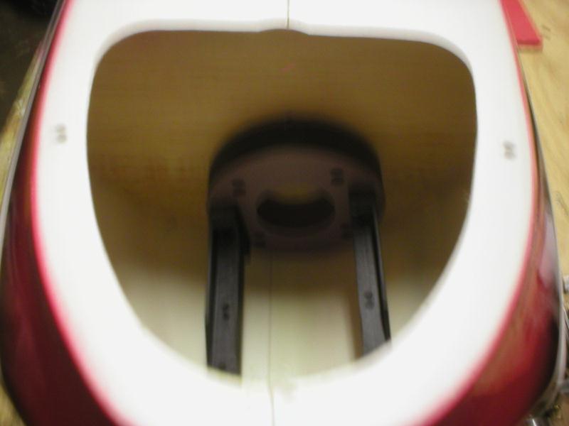

OK working on the engine mount. Theres no doubt that my mount is a little bit thinner than the old Hyde mounts about 3/16-1/4" thinner.
Heres how Im doing this.
1. Cut a wooden ring the same exact size as the nose diameter and as thick as you want the spinner be spaced from the nose.
While the ring is still on the bench, tack the spinner backplate to the wooden ring dead centered.
Tack the ring to the front of the nose with CA so that it fits perfectly centered over the nose.
I do have one problem. If the 160 DZ is the same dimensionally as the 140 sport then I am going to have to shim up behind the mount to get it to fit corectly. Crap. I am going to go and look for some dimensions on the 160 and see how it matches up with the 1.40. If they are identical I am going to proceed. If not Im going to wait until the 160 gets here just to be certain. we will see......

OK, I have the mount in.. If the 1.60DZ is going to be the Exact same distance from the front engine mounting screw to the spinner backplate then I am going to have to shim the backside of the mount about 3/16". Due to the pre drilled holes in the 1.60DZ AR mount there is no way I can redrill the hyde mount to slide the engine forwards. No big deal, I guess a shim whone hurt other than another ounce in the nose...
Here are the pics.
By the way, for you guys that are in the know. As you can see in the pic I am very slightly off about 1/16" off center. Will it hurt to use the nose ring to pull it into the proper position over that small of a distance?
