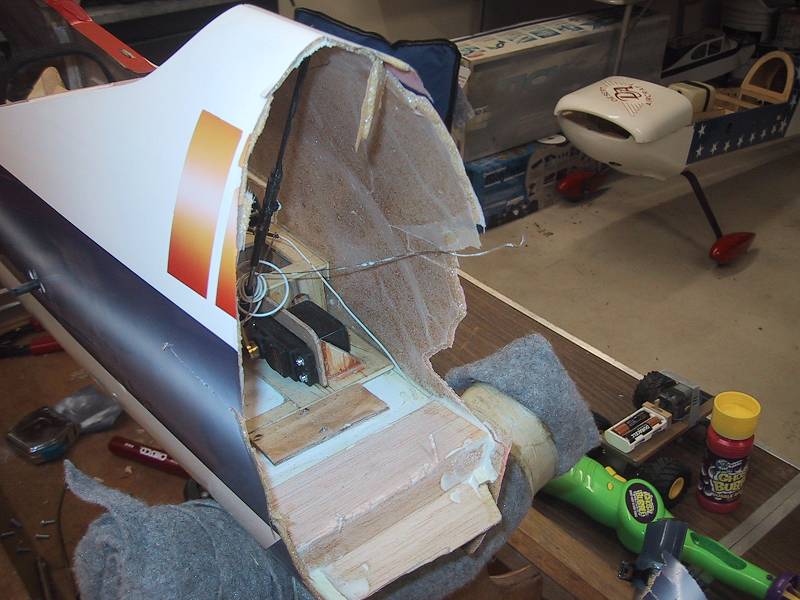

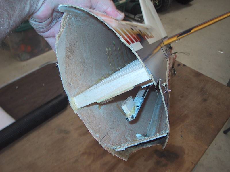

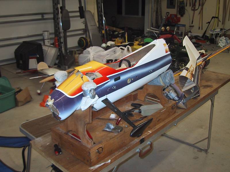

Well it lasted for the summer at least. Went to the flying field today for some much needed practice, on the first flight at the bottom of the outside loop when I started pushing for the way back up the tail started the death dance and before I knew it the tail was flapping in the wind only being draged along by the pull pull cables, I just throttled back and watched it plow in. NO MORE COMPBARFS FOR ME THANK YOU!!!!! This was the second failure I have had with an Impact and don't plan on another! What do you guys think for a replacement, OTOP or BRIO? Any opinions on either? Heres some pics of the corpse. At least it's not the middle of the season.

From the pix, it looks like you have the ladder crutch installed, and it broke from right behind the canopy area?
I know it must be painful for you to talk about it now. But, if you don't mind my asking, did you use the stock rudder, and did you install a former in front of the fin area?
I have just finished mine with all of the modifications. But, if it still breaks right around the canopy area, I'll have to re-think everythiog.

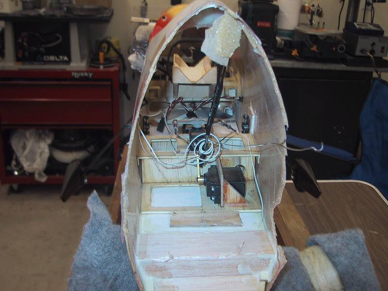

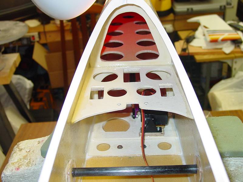

I added a former, at an angle, that matched the canopy line a little. The second that I did that the structure stiffened up remarably. Even before I glued it! There is no way that I can see these things holding-up without some internal, logditudinal support that transfers the forces in an uninterupted manner. My two were flung around the sky with no respect and they are still holding up, (Fingers crosed of course :-))
The former is sandwiched between the long brace to the stab and the servo tray on the same line. On the second one I used 1/16" balsa sheet rear long/brace glued on two rails to save weight

Adrian, yes stock rudder was used but had it hinged with ca hinges and the leading edge was replace with balsa. Rear former in front of fin was installed. This plane had quit a few flights on it and I figured it was going to hold fine with the mods but I guess I was wrong. Think Im ordering a BRIO! Here is a pic of the rear. Good luck with yours, some last and some don't!

I did added a former made out of honeycomb similar to yours right behind the canopy. I've also installed a rear former, and ladder crutch along the fuse. Also, made a new rudder out of light balsa instead of using the stock one. The only thing I didn't do was to install a cross brace along the fin like one of yours.
I actually test flew it once with Derek Koopowitz about a month ago. However, it was late in the afternoon, and I only managed a short flight. All I did was the first three Sportsman manuvers to trim the plane out - straight flight out, half reverse cuban, and straight flight back. Needless to say, Derek was rolling on the ground laughing, and I've been hearing nothing but trash talk from him since. Anyway, now the season is over, I will be spending a lot more time with the plane.

From your pictures it does not look like you have a former at the rear of the canopy installed and it also looks the crutch didn't come all the way up to the rear of the canopy. The failure looks like it occured where the crutch ended...
Mine is just about finished (not painted as of yet) and I've put in all the mods everyone has suggested (crutch, new rudder, former at the rear of the canopy, former at the base of the fin, and the additional brace that Eric H. put in as well) so I'm hoping it will last. Again, this will be an IC (160 DZ) powered - I've seen 1st hand the electric powered one that FokkerPilot has and it flys very, very well.
I've also seen an electric Abbra (Jerry Budd's) and it also flies very, very well. If I had my druthers... I'd go with the Abbra but you'll have a wait for one.

Thanks Mike, John! I will be in Ocala With my Majestic, I think I will take my time and see how some of the new offerings are holding up!
Derek, Im sure yours will fine if set up Like Eric H., I should of carried the cruch up furter but at the time I was more worried about the tail but now I see I just move the stress to the next weakest point. We should not have to do anything to them for and reliable airframe!!! Oh well

Very sorry to hear No. 2 went in with such a catastrophic failure. I remember what it feels like from Flight 19 of my No 1 last year and wouldn't wish it on anyone.
While there aren't many positives, I sense the last couple of failures have eliminated some potential causes and draw us closer to the likely cause. A couple of observations:
-- The failures aren't associated with high stress antics, mine failed pushing through an outside radius into the down line of a triangle, Brians not dissimilar, and same for two others I have talked to people about.
-- The crutch treats the symptom, not the cause. One down in Oz failed at the rear, but was repairable. A crutch was added in the rear and 3/4 of the way up to the back of the canopy, but not all the way. It subsequently failed as Brian's did, ahead of the crutch and behind the canopy opening.
-- The structural materal subscribes to Peter P's egg shell theory. When intact it is fine, when is is compromised a tiny bit it can fail completely. It seems to fail first in compression, which you see in the minor buckling/wrinkling of the surface, and once that happens all strength is gone.
-- Brian has now (expensively) isolated the hinge issue -- even with the exposed Robarts with lever arm embedded in soft balsa construction replaced it has failed.
So my guess is it points to the mass balance issue on some of the stock rudders, and there is a combination of airspeed well within the flight envelope, and perhaps a vibration that kicks it off in IC ones, that starts the death flutter. I don't know a lot about flutter but I assume it is some undamped natural frquency based vibration. The pulsing of the flutter down the fuz finds any weakness and Bang!
The lessons (aside from an aversion to flying Composites!) may well be:
-- Replace the stock rudder ala Eric H and others, and hinge it traditionally.
-- The crutch has to be one structural piece from the stab tubes through to well into the canopy area, with formers to stop any deformation of the oval structure. And as we have seen, that includes tying the crutch tightly to the rear former and through to the servo tray/rear wing brace.
An expensive set of lessons.

Sorry about the model Brian. I think enough is a enough and comp ARF better do something about it.
Doesnt help me at the moment as mine is ready to test fly. I have had a bit of a break from modelling over the last 4-5 months so that I could catch up with other duties.
Anyway I plan to test fly in the next couple of days. I have taken every precaution I can to avoid any problem but when you look at Brian B photos it really makes me wonder. The front of the fuse will probably fall of mine because I have taken care of the rest.
I think the TVCS or whatever it is is just not suitable for this application. It might be fine with their big stuff but those things have a significantly much larger cross sectional area to distribute the load. The electric debate is another interesting situation. I dont know of any electrics which have failed yet. Is it vibration or speed as thte electrics do fly a little slower.
Mine has a DZ160 in it - The worst of both worlds.
Lets hope I dont have to make another post to this thread
