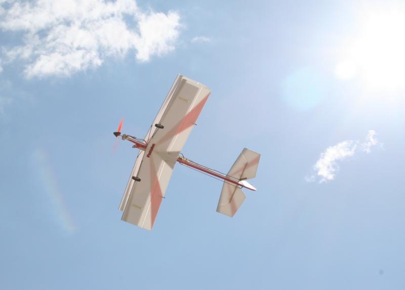

ORIGINAL: 3Don
Futurion F3AI version. Have about 25 flights with it for the moment, plane fly really well. F3P shedule looks like no problem for plane, just need bigger gym and more practice.
Some plane spec's:
Fuselage: 92cm
Wings: 82cm
RTF weight: 158g (with E-tec 2cell 450mah pack)

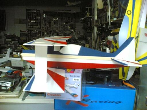

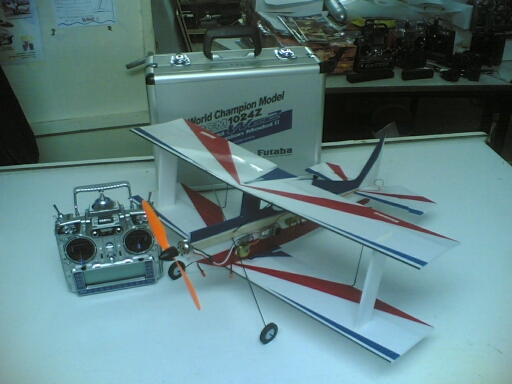

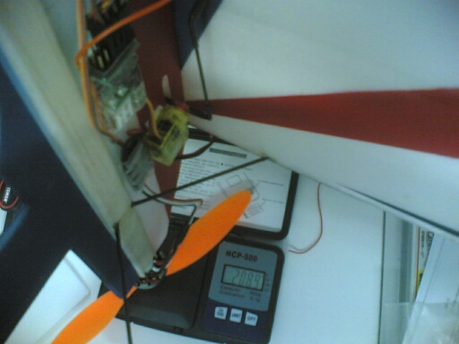

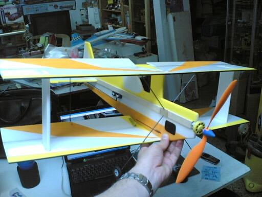

Hello guys, Hi Niko
I see very interested people about indoor foamies.
It's a thrill the whole story, I guess you know it.

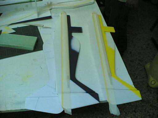

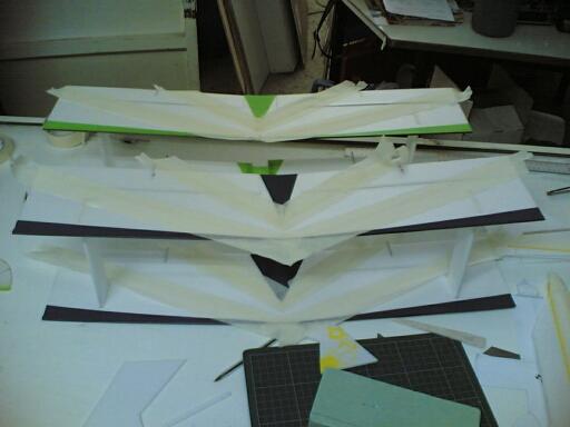

I scratch built a foamy Ultimate through RCM(France) plans issued on March 04.
It flies GREAT . there are no words to testify what this little cheapy thing can perform.
I use almost the same setup as Nikos regarding the power pack.
I use a ThunderPower 3s 730mah, Castle Creations Phoenix 10 ESC, 3 servos 8grms and a chinese(cheap) outrunner capable of close to 500grms thrust. Total weight 210 grms.
The fuselage is 6mm Depron and wings 3mm. Stabilator, Elevators Fin and Rudder 6mm. The wings are reinfroced by 3mm flat carbons on th LE. Fuselage reinforced with 3x1 mm balsa spars on both sides. Push Pull rods 2mm and landing struts 3mm. Prop and wheels typical GWS parkfly. Total cost approximately 20 Euros (+5 Euro for the plans copy).
I also fly Icarus RC Shockfly but the scratch built was the challenge !
I hope you like it !!!!
My next project is going to be a 3D Batix model, www.3dbatix.com/plans (freeplans) !!!!
Nice landings

This Ultimate biplane is quite light it should perform well indoor, well done!! I see some people from the past there, some well known Greek pattern fliers...

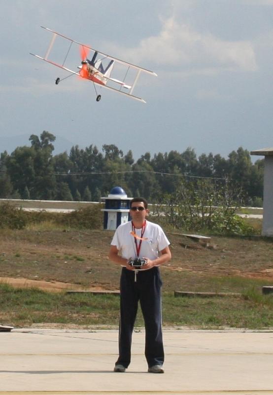

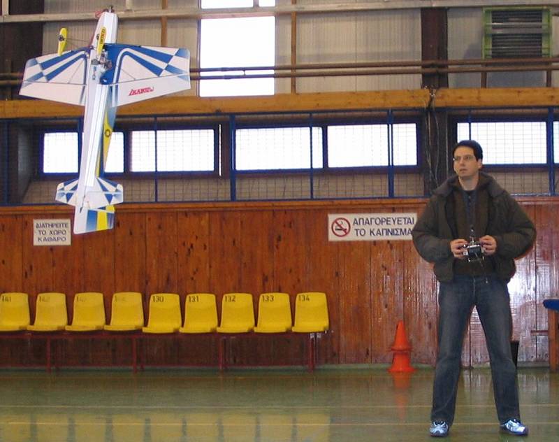

With regards to Quasar I first flew it indoor last Sunday. Total weight with Thunder Power LiPo 3s 730 around 315gr, AXI 2208/34 with APC SF 9x3.8 gives a static thrust of around 550gr.
I did not perform any pattern with the plane, I just flew it around to get used to it. The plane exhibits some coupling in knife edge but did not bother to correct it with mixing. Also in High Alpha there's some wing rocking. Pitch coupling towards the deck is normal with this plane as it has a positive wing incidence for both wings. It is a nice plane BUT definatelly not for indoor F3A-P, it makes your rather stressed in the downlines as it is heavy. I will try to perform the indoor F3A-P schedule outdoor though.
Here is a brief video of the first indoor flight, nothing special, just to get used to its characteristics.
http://www.aeromodelling.gr/album/al..._the_movie.wmv
Also a photo in knife edge, there are some other videos flying very low high alpha knife edge that I''l try to post.
Regards,
