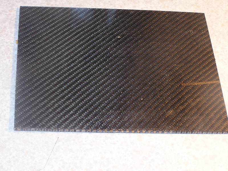

Hi everyone
I have just finished my carbon fiber laminated nomex firewall for the Black Magic, I still have to cut and shape it came out about two thirds the weight of the liteply at the same size and quite a bit stronger. Will post more later when they come out of the press
Troy

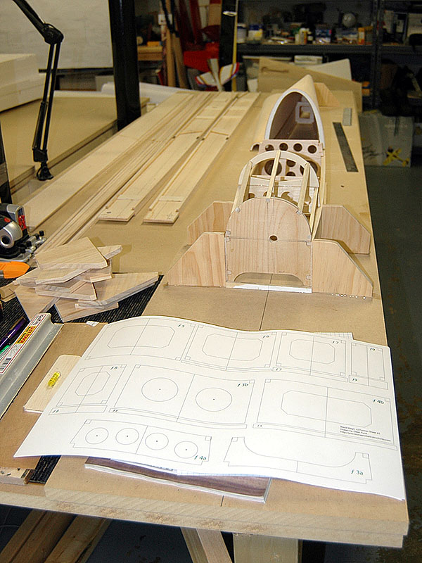

Now you didn't think I'd let it out of here without taking pics, did you? [8D]
Sorry, I was in such a hurry last night, I just forgot to download them. It was after 8 and I needed to get out of here or I wouldn't have been there till midnight. I went to bed about 1 last night, and didn't get out of bed until 7 tonight LOL. Geez I am tired.
But anyway, here's some more sneak peeks and they give a better idea of what the V2 really looks like (before graphics and such, Emory has some really cool stuff for these planes!). Anyway this is one of the electric twins. The real news is the weight. I don't know what they'll end up being, but they will be really light for electric planes. You guys that have seen it in person, wouldn't you agree this thing is about the same size as PL Partner? If it were glow, it would be around or even under 9 lbs. makes ya wonder.
Anyway assuming the owner doesn't mind, here's a few shots right before delivery.
Now I have to put mine together!
-Mike

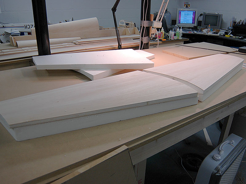

BTW for future reference, use more weight on the wing cores. I put about 200 lbs or more on mine each. Makes them bond really well in leiu of a vacuum. Which is my next major purchase...
-Mike

That is all the "weight" I had on hand, about 100 lbs. per panel. I need to get some sand bags, I guess. They came out nice and straight, I also used a litte 2" foam roller to help spread the epoxy after I squeegeed out the goo.
I think my wing panels came out fairly light at 9.25 oz trimed. I am back on my fuses tonight, hope to get three framed up in short order. I am cutting new formers right now.
I have forward fuse doublers all figured out now, a litte extra DZ beefing is needed to tame that thumper. Should have pictures of that soon. I've also made some jig improvements.
yea - vacuum bagging would be nice, keep us posted on what equipment you get. I am going to get a "feather cut" wing machine as my next big shop purchase. oh, I am looking at spray guns, tell us what spray painting equipment your using.....

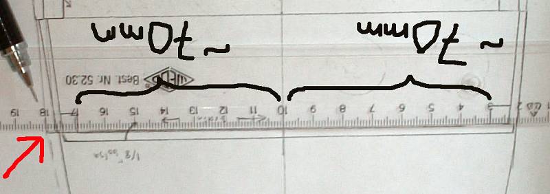

Hi Everyone
Can someone please confirm this measurement for me the size in the picture is not correct
Troy
Troy
#272
Join Date: May 2003
Location: -.--.-..---..---.-.-.-....-.., FINLAND
Posts: 63
RE: Black Magic v2 builder's thread! *Updated*
Hi Troyhm.
I think you meant F4?
I think there's been a bug in Mike's pen on this one... looks like main line is ok, but outline is a bit out of centre.
(I think we are making symmetrical fuse here)
see attached shot, (I know how difficult to you is to read norhern hemispfere pictures, therefore enjoy )
-Jari-

Troy,
Looks like that is F5 -
mine is 126.5 mm not 138.55 - (this is adjusted to fit the taper of the two sets of turtle deck cores I have.)
I've been in a state of total flux regarding my former widths, there is where I am at, at the moment..... : )
I've just updated my templates (again), on my website download a new copy...
http://www.precisionaerobaticstructu...v2_formers.pdf
