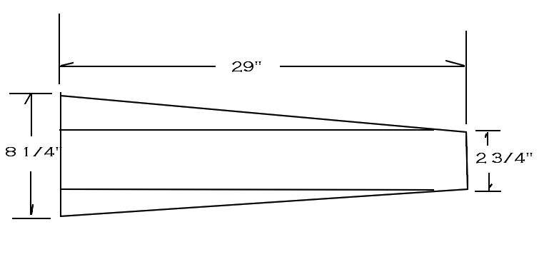

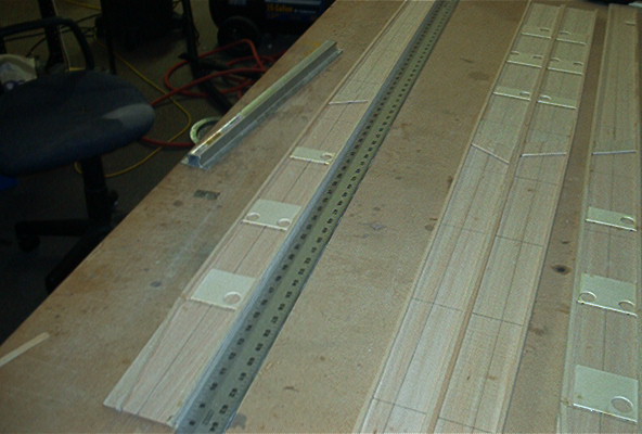

Wing sheeting

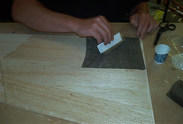

This really isn't as hard as some people make it out to be. All you really need is a flat hard surface (that's the real trick) and a piece of 3/4" MDS board cut slightly larger than the wing.

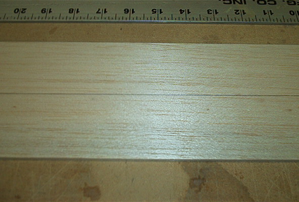

As for the sheeting, select 8 pieces of 1/16"x4"x36 for each wing panel. These pieces should be light with minimal defects, about 14 grams a piece is ideal.
Begin by edge sanding the pieces. Stack them up and sand the edge while weighting them down.
Next lay 6 pieces out on a flat, clean table. Check the fit and make any adjustments now.
With 1.5" masking tape, tape the pieces together lengthwise so they are tightly fit against one another.
Do this only on one side. You should be able to open the seam like a hinge.
Open one seam at a time and apply glue.
Apply a small bead of white Elmer's glue to each joint. Wipe off the excess with a paper towel. Weight the skin down so that it doesn't rise and buckle. Move your weights around occasionally so they don't get stuck.
After about 25 minutes, lightly sand the surface with 220 grit paper. Let the dust migrate into the seam, this will fill the crack well. Now let the skin dry for about 1 hour.
Carefully flip the skin over and peel off the tape. be careful here because it's easy to break the sheets apart with too much force.
Wait about 15 minutes and repeat the light sanding. Let dry for a few hours.

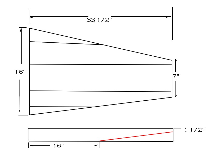

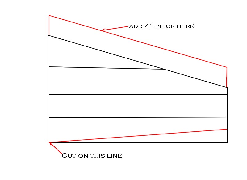

Trim the skin square so length-wise the assembly is 33" long.

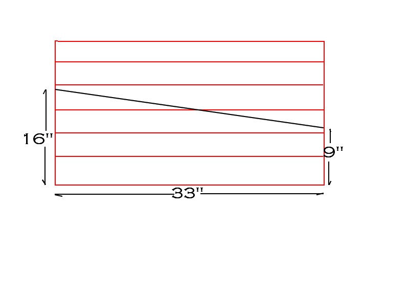

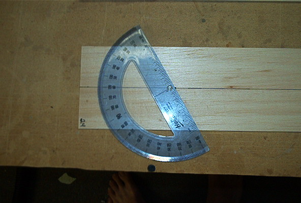

Taking measurements from ONLY the bottom edge, make marks at 16" on one side, 9" on the other. Using a long straight edge and a very sharp blade, cut the skin in two diagonally as shown.
Now edge sand the skin on the diagonal cut with a long straight bar.

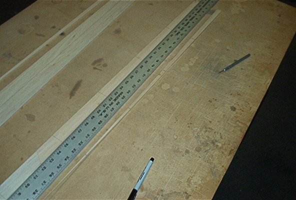

Tape down and attach one piece of 1/16"x 4"x36" balsa using the same methods previously mentioned.
Make a mark at the tip (from the bottom!) at 2" and using a long straight edge, cut away the TE taper as shown.
Let the skinds dry overnight, then block sand them with 220 grit paper.
Using compressed air or a vacuum, clean the skins thoroughly.
Spray the surface of the skin that will attach to the wing with aqua net (or similar) hair spray. Be careful of your skin orientation. The skins will curl up, but don't worry about it.
Let this dry for a couple of hours, then lightly sand with 400 grit or finer. Clean again and you're ready to glue the sheeting.

Begin by laying the core on the sheeting and making some marks just inside the honeycomb area. Remove the core and connect the dots; the inboard (larger) section is the area you will spread resin onto the skin. Don't spread resin in the honeycombed area, you'll defeat the purpose. if you didn't honeycomb, skip this step.
Spread a good quality laminating resin such as West systems, MGS, EZ Lam or similar onto the surface of the skin that has been treated with hairspray.
Use a folded piece of poster board for this. Spread it as thin as possibly, it should be darker but not soaking wet looking.
Take a glue syringe and lay a bead of resin on the core outlining the honeycomb pattern. The bead should be about 1/16" thick. Use 2 beads around the edges and tip.
Spread also a thin bead across the false rib and spars to make sure you get a good bond there.

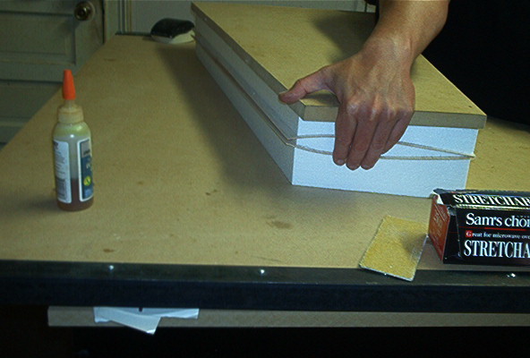

Applying top skin first, lay the top shuck on teh flat table and line up the TE of the top skin into the shuck. Carefully lay the core on top of the skin and press gently.
Now apply the bottom skin, again lining up the TEs with both skins and the shuck.
Apply the bottom shuck and flip the whole assembly over, so it is sitting right side up on the surface.
Lay the piece of MDS board on top of the shuck, and go around and align the corners so that everything is in the correct place. A little tweak here and there is usually needed. But this step is critical, make sure it's straight.

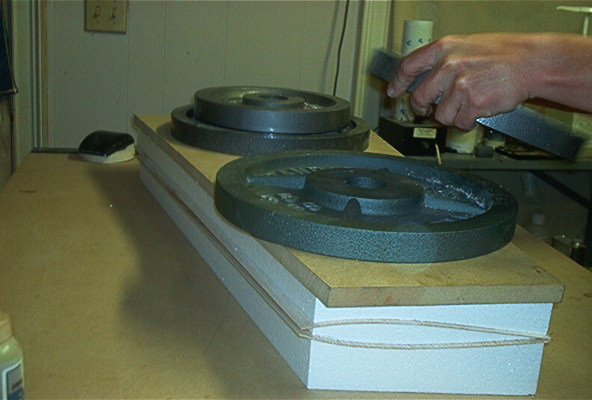

Now apply weight to the top of the MDS board. You will need about 200 lbs per panel. '
At this point, check the LEs and TEs with a straight edge. It should be perfect, if not, shim it with poster board until it is.
Let cure overnight, and your wings are sheeted.

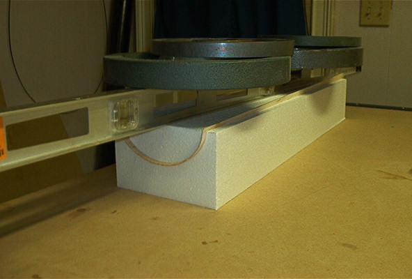

Turtle deck sheeting
This one can be tricky. Easily it's the most difficult of all the sheeting chores you'll have to do with the Black Magic.
Select the lightest 1/16"x4x36" balsa you can find. It should be A grain, that is you should be able to easily bend it across the sheet. It will need this flexibility. Especially the center sheet.
Lay out your sheeting as shown in the diagrams. Use the same techniques as we used for the wing sheeting, with one change: use Duco cement instead of white glue. These sheets will need to be applied wet so we don't want to use water based glue.
Block sand and use the hair spray sealing method just like on the wings. Sand and clean when ready.

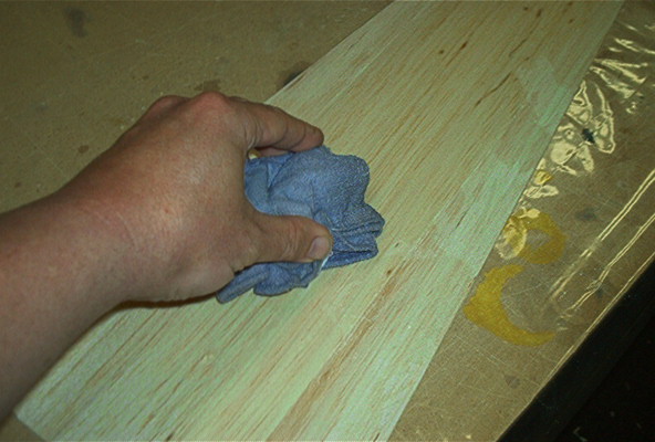

Using a wet rag, dampen the outside of the skin (the side not bonded). This will allow it to better take the shape of teh turtle deck without cracking.
Spread good laminating resin extremely thin, you don't want to use any more than you absolutely have to. The bond isn't nearly as critical as the wing, but it needs to be down and tight. Especially the front area and the edges.
Lay the outer shuck on the flat table, and center the skin in the shuck. Paying particular attention not to twist the skin and keep it aligned, gently press the assembly down into the shuck. Since the nature of these cuts tend to cause a loose fit at the rear, you need to move the whole assembly toward the rear slightly (about 1/4" or so). Put the inner shuck in place.
Now, get creative. You'll need to weight down the center shuck with as much weight as you can get on it, up to 70-100 lbs. Yet you need to be sure you don't get into teh edges, so you'll need something to press down the center.
I use an old level and weights. They'll want to slide, so use masking tape and once again, get creative.
The rear can be a littl problematic. Here I use a carpenter's clamp and adjust until barely snug, being careful not to distort the shape and keep the edges true.
Let it cure overnight, then trim the skins flush with the foam.
Tricky, but not really difficult.
Note: the one shown in the last picture was sheeted before I made the center cut on the core.

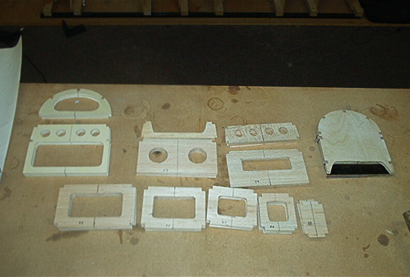

Fuse Formers
These are fairly easy. Every former except the firewall and F2 are made from 1/8" 4-6 lb balsa. you need good, stiff C grain wood for this.
First cut the formers to approximate size.
Lay the former on top of the plans, and mark a center line with a sharpie.
Now using a block sander, sand the edges until you can barely see the outline all the way around the former.
Flip the former over and transfer the center line to the other side.
using a straight edged cork back ruler, mark the notches for the stringers and cut them out. note that a few of the formers in the front have flat bottoms, they simply sit on top of the stringers at those locations.
Now cut out the centers and sand smooth.
For F-2 and the firewall, you'll need to ither cut the plans, or make a copy and cut the copy. You will use that as a template. You'll need 2 copies of F2 as the parts overlap, or you can just wing it.
Spray the back of the paper lightly with 3M 77 spray adhesive. Let dry for about a minute, then apply the F-2 templates to a piece of flat 1/8" lite ply.
Apply the firewall former to a piece of 1/8" AC ply.
Cut them both out on a scroll saw or band saw.
transfer the center lines to these as well. Transfer the trust line onto the firewall. Sand F2 to final shape and you're done with it.
For the firewall, it needs to be laminated with a piece of 1/8" 4-6 lb C grain balsa. if your building a glow version, you'll need to make a circular cut out to back up the engine mount. Make a circular hole the same size as the plywood piece in the balsa, and fit it into place. Laminate them with a thin covering of epoxy and weight down and let cure. See pics for details.
If you're building the electric version, you need to laminate it straight with a piece of 1/8" balsa, with carbon on both the outer surfaces. Use 2 ounce carbon, and you can either vacuum this down or put piece of mylar over both sides and a LOT of weight on it.
When this cures, drill the holes for your motor mount. This will vary a LOT depending on what you do here. But using a drill press and a 3/8" piece of charpened brass tubing, cut into the balsa side until you hit the ply (you'll know). At this point remove the cut out piece with a small screwdriver or whatever. then laminate in pieces of 3/8" dowel. Let this cure and then redrill.

Select 4 pieces of flat, straight,, very nice C Grain 4-6 lb 1/8" balsa for the fuselage sides. Try to keep the weight around 26 grams or so.
Begin by marking a center line down the sheet, end to end. Now at the ends, measure out 1 3/4" and make marks.
Using a long straight edge, connect the marks and cut away the excess just outside of the marks. With a long, flat bar sander, true up the edges so that when you lay the piece flat on the table, it touches nicely all the way down.
Now refer to the plans and use a good square corner for your tail post, which all measurements will be taken from. Notet he location of the splice cut, and make the cut.
Paying no attention yet to the length of the front piece, match up the cut on the front piece. You should be able to butt them together flat on a table against a straight edge, and the edge follow the straight edge from one piece to the next.
Using a piece of scrap from what you just cut away, make your splice joint piece. Make sure the grain runs accross the joint in the same direction as the fuse sides. Leave 1/4" at the edges for the stringers! the bottom will be a little closer because of the cut angle, so just make it a little shorter.
Lay the whole thing on a piece of wax paper and glue it together, using a long straight edge to guide you in keeping it straight. Remember to make a right AND LEFT side. Make sure your center line marks will be on the inside of the fuse.
After you have this made, measure the left side down the length from the squared tail post. The total length of the left side when laid flat should be 63 5/8" long at the center line. make a mark at this point on the C/L. The total length of the right side whould be 63 3/8". Again make a mark.
Using a protractor, mark a line at 1.5 degrees tilted DOWN at the mark location. Cut this away, this is where the firewall lines up.
Now lay the right fuse side down on the plans, and line up the rear TOP corner with the rear top corner shown on the plans at the tail post. The angles do not match, but that's fine, we'll make this cut later.
Transfer the former locations to the fuselage sides. This line marks the front edge of the formers.

Tail block
This is a piece of cake, but sort of critical.
Use a piece of 1" 4-6lb balsa, cut to slightly oversize vertically. Forward to rear should be the exact dimension between the end of the stringers and the rear of the fuse sides, still squared off.
Begin by marking a center line around the circumference of the block.
Now make your measurements for the edges; use the top plan view for the size. Connect all the dots and you have your "sand to here" lines.
Using a band saw, scroll saw, razor saw, craving knife or whatever, trim to just outside of the line.
Lay the block down flat on a hard surface and sand with a hard flat sanding block. Take care that the surface remains flat and doesn't develop a curve to it. With soft balsa, this is pretty easy.
Now we're ready to jig the fuse.

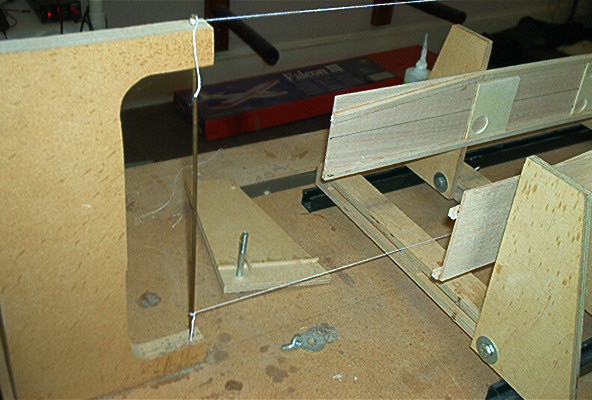

Building the Fuselage
First, get your jig set up. using a level, triangulate everything and make sure your jig is level. On mine I have it mouned to a piece of 3/4" MDS board.
I've included a pic of a slight modification that I use to make everything straight. At either end of the jig, dead on the center line, mount a piece of "C" channel MDS board with a piece of music wire, thick brass tubing, or whatever.....and make it high enough to clear the fuselage in the jig. The only thing that is critical is that the wire/tube is centered and perfecly vertical.
Next tie strings and pull them tight at the top and the bottom of these tubing/wire pieces. Now you should be able to sight down the strings and have a perfect vertical plane. this is what we'll use to align the fuse.
Starting at the tail block, adjust the jig so the center line of the tail block is perfectly centered in the plane. Lay in the fuse sides so that it's upside down. the long flat surface on the bottom. Using the jig itself and a couple of pieces of scrap wood and clamps, glue the tail block with a thin coat of slow cure epoxy. Make sure the fuse sides are exactly asligned with respect to one another, if you are off here it will throw the wholep lane off. If it takes an hour to get this step right, it just takes an hour.
After the tail block has cured, put the formers in place from F3 back. Don't glue them yet. Tweak everything and continually sight down the strings until everything is perfect and you are satisfied that it's straight. Also be sure to step off to the side and be sure it's seated down properly in the jig and one side doesn't raise up.
When you're happy with what you see, apply thin CA to the formers and make sure you geta good bond. if you have any small gaps, use thick CA. I usually go down the back sides with thick CA anyway just to make sure.
