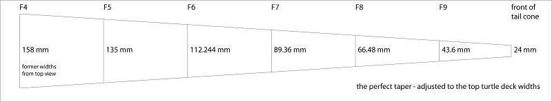

RE: Black Magic v2 builder's thread! *Updated*
Hi Dean
I have found the same thing with a laser cutter here, the wattage of the laser seems to be to high for cutting the balsawood and it just burns, thats what I got told anyway.
Dean if you have one a cad package is easy to get the excat right taper, just get the start former correct the the end former and draw a straight line between the two the place the other formers at the correct position and the correct size can be easily measured on the screen

Hi Troy,
take a look at this....
it's easy to do it in illustrator too, they are both vector drawing programs and illustrator is just as accurate.
Since I have my turtle decks sheeted I have adjusted these widths to match the taper of the turtle decks that Mike is supplying. Granted I am making the fuselage 1 mm wider to allow for the rounding after sanding that Mike is reffering to in that part of this thread. My sheeted TD cores match the profiles on the plans. My method of hand cutting and my jig set up requires accurate widths, without "sanding to fit"... of course you have to be able to slice a hair in half with a #11 blade to really be able to use my method....
since I only tack glued my formers I am going to cut these widths tonight and replace - remeasure, etc....
I am only talking about a few mm here and there, but since I am a nut about stuff like this, all this is going to pay off big, as I am building about 5 fuses right now once I get this perfected.
well, I am having fun.... and my quest goes on.....
so how is your cad drawings coming, can't wait to see them....
dean

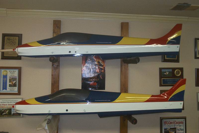

And here is a sneak peek. Blurry, not polished and canopy not cleared, but an idea of what's coming soon.
-Mike
-Mike

I am now looking at f4 - I am thinking a shaving off maybe 2 mm in width just to make the forward fuse taper really smoothhhh into f5, my f5 to tail block taper is perfectly flat and looks awesome, I can lay the side of the fuse flat on my building table, it freaking rocks and looks sexy as hell...
take a look at my recent formers and my top view drawings. what I was doing is comparing Mikes turtle decks, to his templates, to my templates... what I am trying to do is be able to create all my fuse parts without any "sanding to fit"....
Once we get things perfect, I am going to send my drawings to my new buddy Scott to cut a set on his cnc table.... This should cut down the time required for basic fusebox framing by a large margin.
get some rest and let me know...
