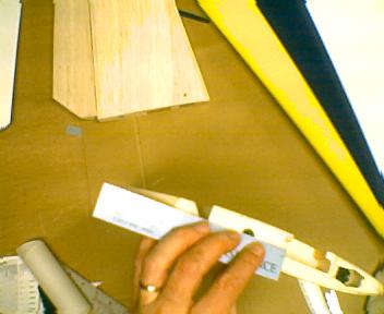

Chin cowl. There are several ways to do this. I mounted it the same as the canopy. Cut two slots 1/8 inch from either edge just in front of the firewall, and then slipped the half circle ply pieces from the underside and added some CA to the back side to secure them. Cut slots in the chin cowl to correspond.

A nice tool to make is a piece of 1/16 inch ply with a piece of 150 grit sandpaper glued to one side. This makes nice straight slots that look very clean.

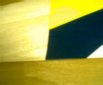

Dual elevator servos is what I plan to set mine up with.

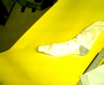

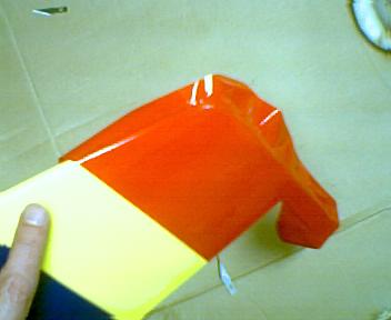

Finishing. Well, its been a bit of a learning curve to cover again. I've been spoiled by having my planes professionally finished, or flying an ARF for the last few years. I am covering with Ultracoat. With a few pointers from Dave Guerin, I've become very happy with the results. Here are the steps in the covering process.
Use a sanding block with some 220 then 400. I use the 220 to level out the surfaces, then the 400 provides a nice smooth surface to cover. The block is 1 1/2 inch by 3 inch by 9 inch balsa. The balso gives some which makes it nice, yet straight enough to be a good tool.
Starting from the back to the front. White piece goes on first, then the blue piece, then the yellow piece. Its good to cut templates first, and mark the balsa where you want the end points. Finally use a shart exacto knife. I've gone through about a half dozen so far as the dull quickly. But this is important to get nice clean lines. To trim the outboard end of the covering, I pull up the covering about a quarter inch past where I want to cut, put a piece of paper under, then use a straight edge to get a nice straight cut. The covering is overlapped between 3/32 and 1/8 inch. The top is covered first because the dark blue has to overlap the yellow from the bottom. Definitely don't want to overlap the yellow on anything dark, as it shows through.

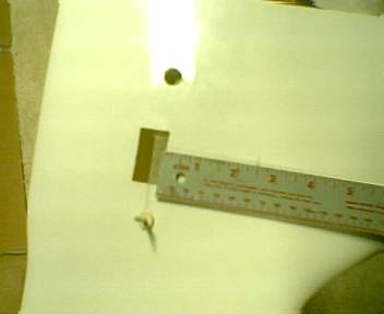

The overlaps beween the blue and yellow will be a 1/8 piece of white trim tape. That hides the overlap nicely. I am so very happy with the iron setup. Dave suggested using a sock. Its very thick and allows you to press down on the wing as hard as you want with no marking or scratching.
The work board is very simple and makes the covering job easier. Just using some cardboard to protect the work surface with a couple of good straight edges allows nice cuts and lots of room to work.

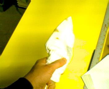

Hope you washed that sock first Don!
Greg

I laughed so hard I can't keep the mouse steady. The sock. Many of the best looking planes, including two of the last three years' National Champions have won with planes that were professionally covered using a sock. It really works better than just about anything I've seen. Superior to any hot-sock, mit, cotton balls and heat gun...Well, here's the story. It's a new sock. My wife bought me a pack of a dozen for Christmas. Now, I'm not sure how she'll take to me using my Christmas present this way. I've kind of started to burn up the first one, but I've got a lot more. I hope to only use a few in this process; maybe she won't notice them gone... that is until tonight when she poked her head into the shop and started to cry. Not literally but I thought she was kidding until I heard her and my daughter upstairs. Not about the sock but I am using blue instead of metallic Plum. How in the world would you figure that? She remembers from like, I don't know, 10 years ago when I was picking colors for the Jekyll, then the plane after that. What was that called? It was like a Jekyll II but with double tapered wing? It got me in the finals at the team selections in 1999 and a TOC invite. Hmmm. It was yellow and it had purple on it. Hmmm.. there was another plane that was like it under a different name. Sequel. Is that right? Let me go check. Well, I think it was a Sequel. Any way, she remembers discussing color schemes with me and I asked her what she wanted in terms of color. She said purple. Now that was like 8 years ago or something like that. How can she remember a detail like that when I can't even remember the name of the plane. She also said that was the color on the Focus from 4 years ago. It sat in my basement for a year until I dragged it out in the spring of 03 to put the gear in it and get it flying. Well, a month and a half later I won the NATS with that plane. This is a very serious issue. Blue vs Purple. I'm torn.
Camera- I'm using a really nice keychain camera. Its only 2 inches by 3 inches in size and runs off of a AAA battery. Its nice because its very convenient and its fast in terms of downloading on to the computer. If anyone has a digital camera that you would like to donate to me, mail it to me. I'll give you my address off-line. But it has to download quickly to the computer and have small file sizes so they are easy to upload to RCU.
Everything is OK now, I think. She tells me now that its ok, and she gives me permission to use blue on the plane rather than Plum. Ok, side-story complete. Now, what was that about a sock?

Baby socks work really well over the head of the iron. They are just the right size.

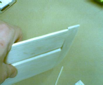

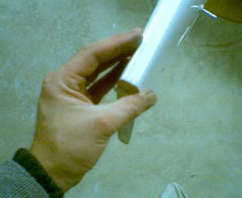

Stab finishing.
To get a good reference point on the stab tips, with regard to final sanding, draw a center line at the root. Use a ruler and center the elevator tip. Sand the tip of the stab to match the elevator position.

To strengthen the tips for resistance to hangar rash, sand 1/32 inch down on the TE of the tip, cut a piece of 1/32 inch strip and glue on the TE.

Covering the Stab. Ultracote is very easy to work with in terms of covering. The tips are easy to cover with no wrinkles. The material stretches very well around the tips and then trims nicely. Again, using the sock which still allows enough heat to flow through without scratching the covering or making indents.
