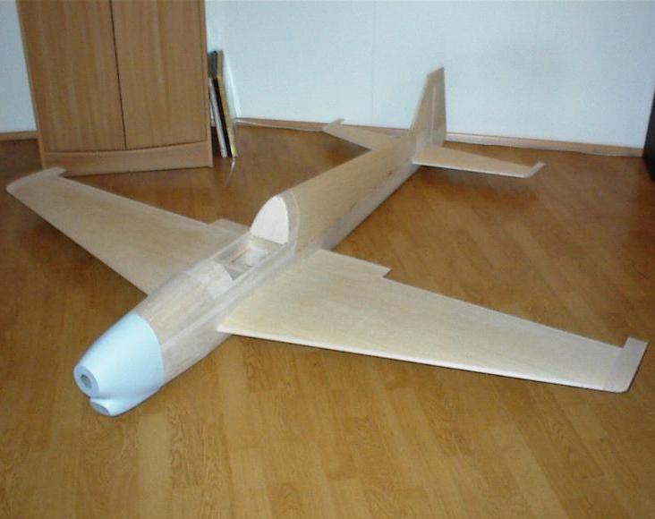

Here is an update on my Typhoon.
The front has been sheeted and I am really pleased with the result.
It's about 2,6 kg now, not to bad I think, considering I'm not using the wood this plane really deserves.

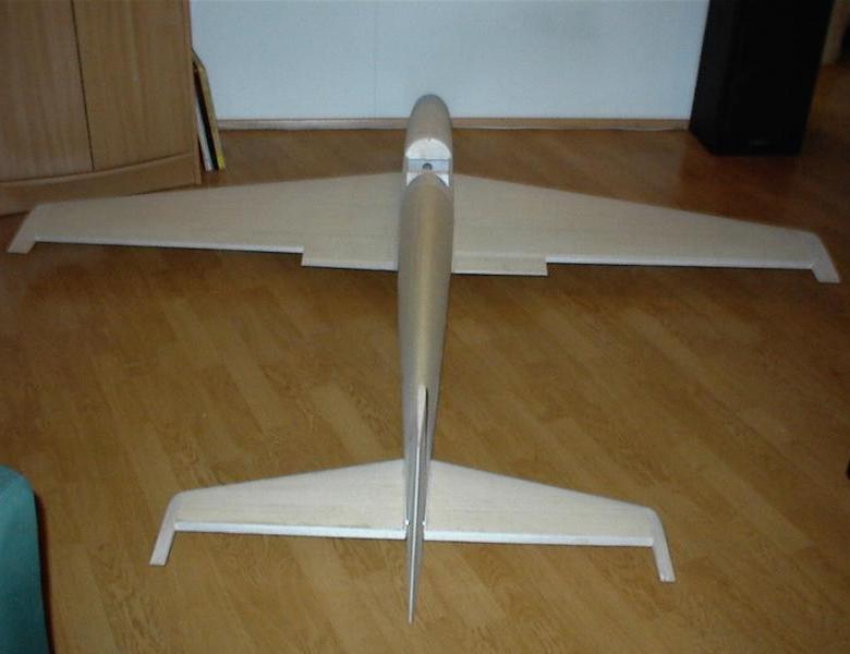

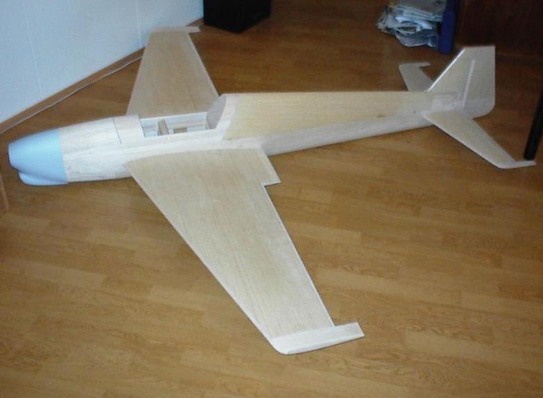

The thing about the Typhoon, it seems to grow on me.
I just like this plane better and better And if this bird flies as well as they say, I'm sure I will build another one but next time spend more money on it, buy lighter wood and use lighter wing tubes etc.
And now I have come to my original idea, to make two sets of wings. But instead of using wings from another plane, I will use the Typhoon wing, but with double taper, moving the tip rib 1,5" forward (similar to my Supra) and using the W2 rib as the root rib. That would be a
5 1/2" shorter wing.
Now that the fuselage is built it's so much easier to see how different wing shapes will look on it. I´m just not sure how big the stab needs to be.

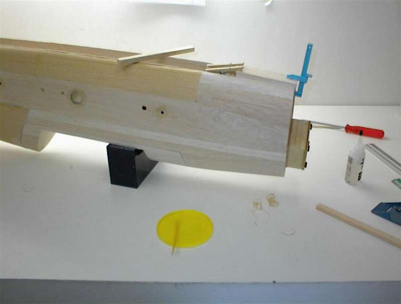

The cowl has been opened up to accept the engine. Unfortunately the Walbro carb is so big that there is hardly anything left to glue the cheek cowl on to, so the cheek cowls will not be used this time.

After sheeting the pipe tunnel one of the last things to do is the fairing behind the cowl, a very nice feature and for me it is one of the things that make this plane a very enjoyable building project and makes the plane look so much more beautiful.[8D]
