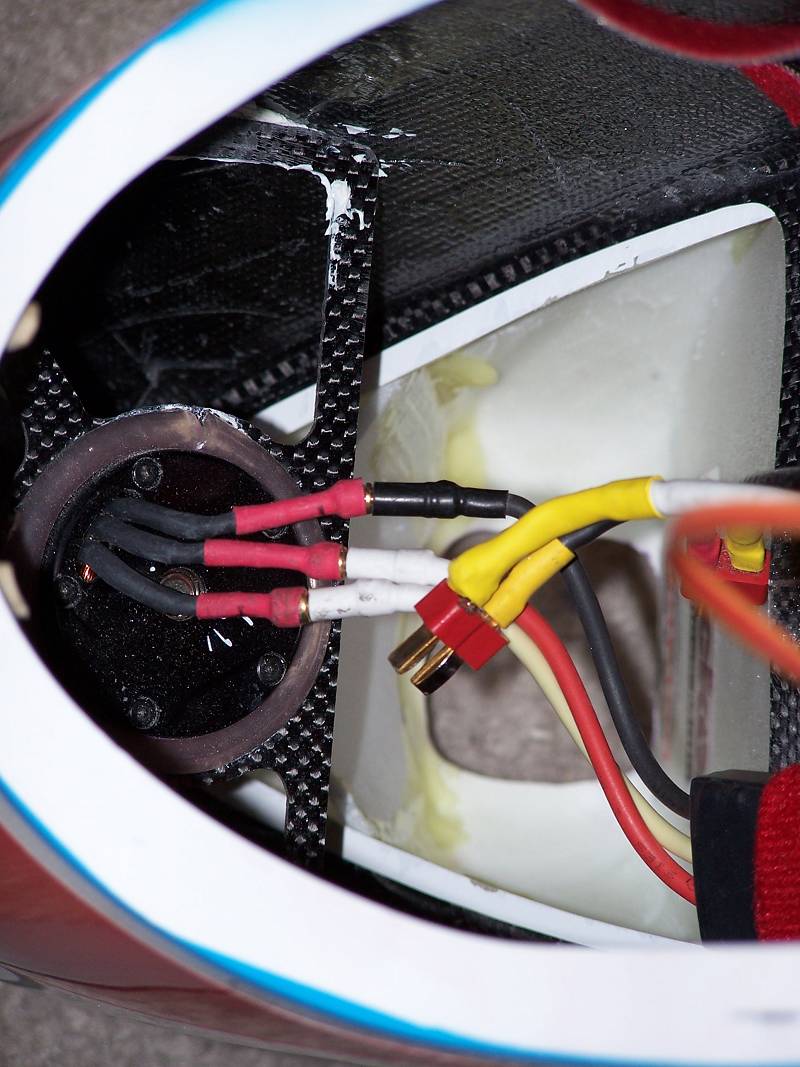

RE: Composite-ARF Integral, kinda build thread
Hi Tony,
I would like to see a couple more pics which show your airflow management especially through the battery space. It looks like you bring the battery cooling air in from the front of the underbelly, up through the battery compartment and then back down into the underbelly to exit. I asume you have an air dam in the centre of the underbelly as well as one in the fuz at the rear of the battery compartment?
Malcolm
Malcolm
#282
My Feedback: (17)
Hello Malcolm. Yes you are correct on the air flow. I have 2 air dams up front. one goes to the motor and the other goes up and to the batteries. Here in Arizona I flew the plane yesterday, the temperature outside was 105 degrees. The batteries were 106 degrees before I flew the plane. After a 7 min flight with the TP 4200 the batteries were 132 degrees. I do believe I could even keep the batteries cooler by making a deflector to blow the incoming air through the batteries. i will post more pics Tomorrow.
Tony Watkins
Tony Watkins
#283
Hi Tony,
132 F or 55 C is getting pretty warm though not drastically so. On the basis that you are measuring the temp of the outer cells in your pack I would try and get some more cooling air through there.
Look forward to seeing the pics.
Malcolm
Malcolm
