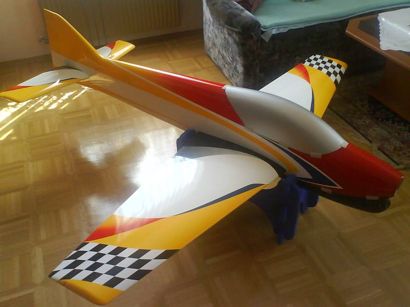

Hi Kjell,
Fuselage is very light, I did not expect it to be honest. This glass-balsa-glass technique seems to be be a lot lighter than glass-herex-glass one, this is what Oxai also does. So by bying an Integral is like buying an Oxai with a bit worse finishing...
Anyway I am very satisfied by the kit parts etc, have not assembled the tubes yet to see whether they fit and measure incidences etc. but don't think there will be an issue. I don't like the classic scheme but nevermind I really like the ZN Line one but I would have to wait till mid October for new delivery.
Kjell when yours was built? Mine according to the part labels is March 2007.

#427
RE: Composite-ARF Integral, kinda build thread
... sounds good ...
actually it was better than i expected also ... My labels say the same as yours ..
Beside the low weight, there is another thing i like specially with this bird; the low-wing displacement. In other words , i think it`s better to see how it perform in different attitudes when the wing / fuselage are defined clearly ... I really didn`t thought about it before i was told, but i totally agree ...
Now , it`s time to get known to it and enjoy!

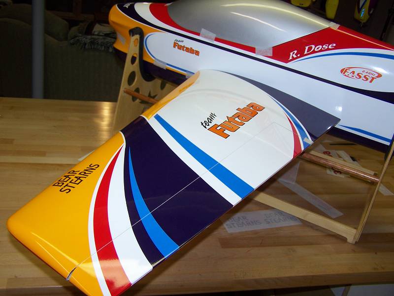

Composite- Arf Integral very much a build thread...
My first model arrived with the same "creased" chin cowl. Jason (Shulman) said that several of the models have had this issue and he has ordered a number of chin cowls for replacement purposes. Personally, I pushed it back into shape and it looks ok. Is it ok enough to never notice? Probably. Is ist ok enough to have BadBrad come up with a nifty silver swoosh complimenting his new "Integral" logo with swoosh? Yes!
Here are a few photos of the electric version. I will more than likely offer a NEW Integral Electric/YS DZ 170 powered thread in the next month sharing a few potential items of interest acquired from my past (24) months of "Pattern Camp".
