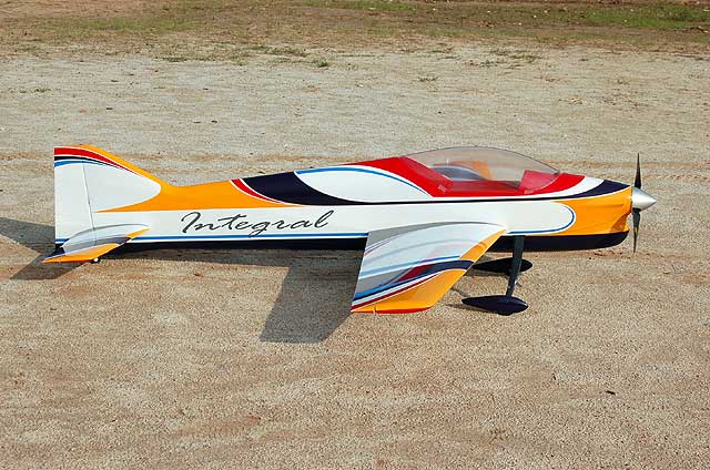

Jason,
I'm curious how the final weights came in. If I read correctly from your earlier post the basics are:
Fuselage 27
Belly Pant 2.2
Canopy 4.5
Hatch 2.4
Right Stab 4.1
Left Stab 4.2
Rudder 2.1
Right Wing 14
Left Wing 14
TOTAL: 74.5 oz for empty airframe
plus Engine OS200 EFI* 41
Neither the airframe or the engine are remarkably light. The engine itself is 11 oz heavier than an OS140RX. My fascination was your prediction of a 9.34 lb final product, which is remarkably light. Actually I don' t this this was so much a prediction as an accounting of the weights you knew at the time. However, if the final plane is close to this and the plane is stiff enough and durable, then there are some building skills in play that you have that would be of great interest. Many people starting at this weight would have a hard time making 11# much less 10#, so I hope to learn more. Thanks.
--Lance

#28
Join Date: May 2002
Location: Around
Posts: 1,432
RE: Composite-ARF Integral, kinda build thread
Lance,
Those are weights as I pulled parts out of the box. Don't forget, the fuselage has a bunch of stuff already installed, and is only missing a rudder/tank/batt/rx tray. The OS weight is including all the parts with a * next to it. Hyde mount, header and pipe. It looks like we probably will change the canopy to a solid composite one to save about 3ozs or so. My list also includes a heavy back plate spinner, a 24oz tank (using a 20) and other than a 2-cell Lipo, I'm not doing anything to make it lighter. I want basic, everyday numbers. Anyone that spends some time with it I'm sure will make it lighter. 9.75lbs... maybe with work, my prediction is 10-10.25lbs. I'm not really a builder , I think I can hold my own, but I could easily be way off on my predictions.
Jason
Jason

#42
Hello JAS
Weights of differents pieces as in the kit on picture are :
fuse 750 g (26,455 oz), underbelly 130 g (4,586 oz) , rudder 20 g (0,705 oz) , wing 257 g (9,065 oz), other wing 260 g (9,171 oz) , stab 2x 55 g (2x 1,94 oz).
Claude
Claude

#44
I have
Fuse 823 g
All wood in bag 393 g
Leading edges + other 197 g
Right stab 57 g
Left stab 60 g
Right wing 226 g
Left wing 234 g
Rudder 22 g
Canopy ( Nut cut yet ) 227 g
Total 2239 g
" All wood in bag" includes the undercarriage along with wheel pants and tail tube of aluminum. Fuse is huge (!) on this one, so it will be difficult to build a really light aeroplane. In comparison the fuselage of the Cocaine was 765 g with a large plate for undercarriage allready installed.
Your models empty weight seems to be 78.8 oz, 2234 g, so this is now all alarm lights starts to turn on for keeping the weight down going electric, but for glow it is going to end up in the 4700's. That is also the weight i'm shooting for....Back to the building table ...
Fuse 823 g
Right stab 57 g
Left stab 60 g
Right wing 226 g
Left wing 234 g
Rudder 22 g
Total 2239 g

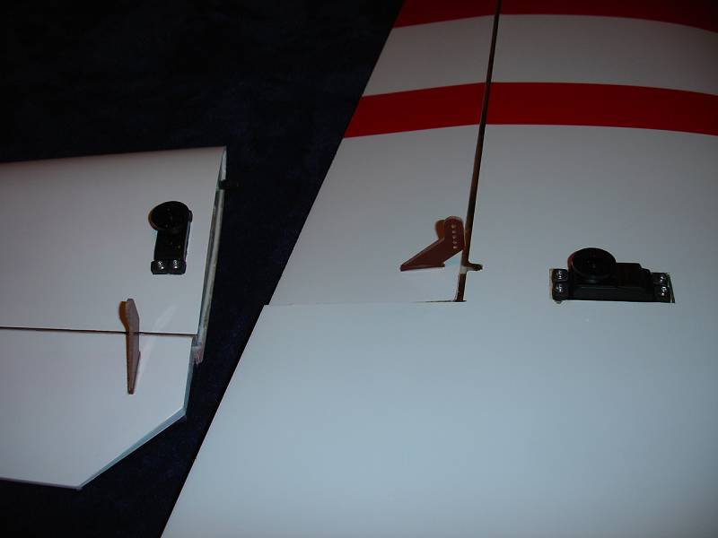

#45
Join Date: May 2002
Location: Around
Posts: 1,432
Here are a couple of pics of the horns. I taped off the area I didn't want the glue to get to and removed it after I made the fillet around the horn. Leaves a nice clean glue joint.
Also, here's a pic of the rudder pin that holds the rudder in.

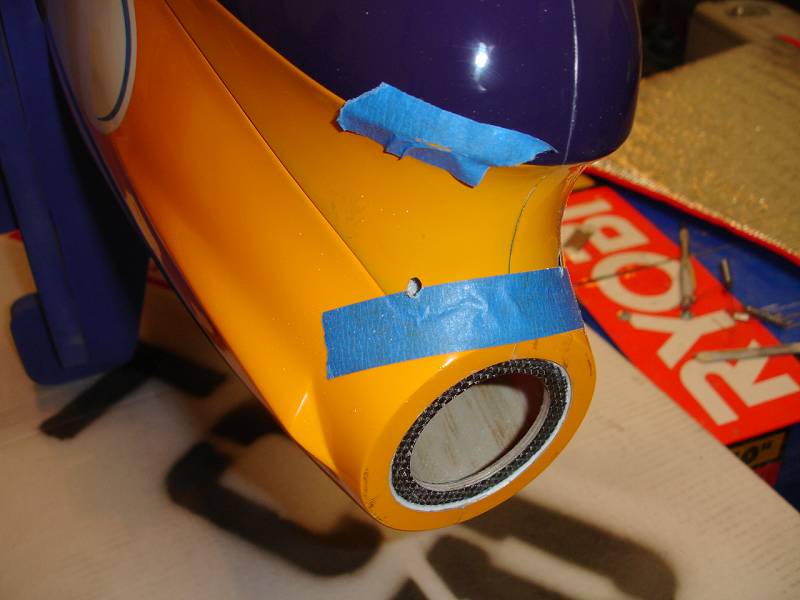

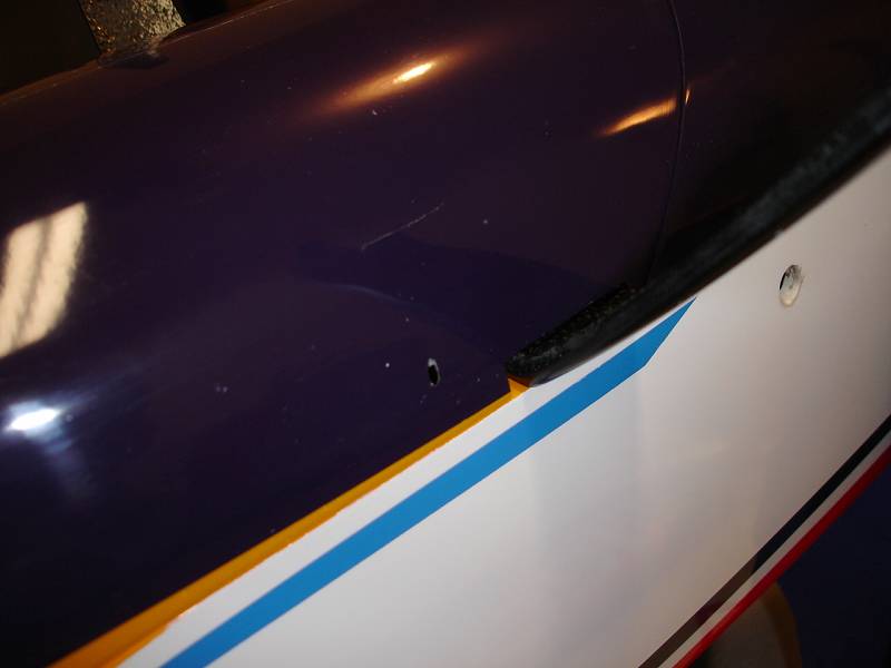

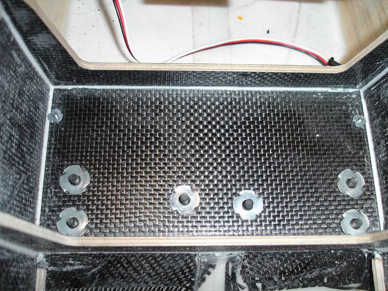

#50
Join Date: May 2002
Location: Around
Posts: 1,432
Here's some pics of the way I mounted the chin cowl. 4- 2/56 bolts with blind-nuts. I added wood to the front for the front 2 screws and used the landing gear plate for the rear 2.
