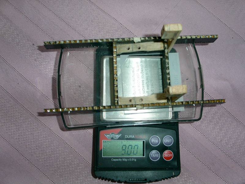

In an effort to save weight I'm considering replacing the 2mm wire(11g) rudder hinge with a carbon rod. Has anyone tried this?
Also the rudder servo tray is pretty beefy. Besides acting as a servo tray, is the tray in the normal position needed to provide structural support for the turtle deck.

The carbon pin is do-able. Just make sure to check it for wear every 50 flights or so. Since the rudder tray is only carbon/balsa, I would suggest that stays as is. The biggest culprit for weight that we've found in building these is equipment selection and glue. No gobs of glue and you can save an ounce or more. Just make sure everything fits close (not wedged in or loose with air gaps) and use a little epoxy to make fillets on each side of the pieces being glued, and you should be good to go.

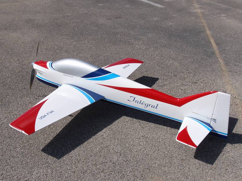

I replaced the metal pin with a carbon rodsaved 6 grams. The carbon rod had to be sanded a bit to fitdon't recall the size of the rod used. 300-ish flights with this on electric power. I probably would not use the carbon rod if glow powered, or it would need to be replaced frequently.
Rudder servo in tail: If you are going electric you will need to be careful with weight in the tail.
Concur with Jasonequipment selection and minimal glue control the weight in an ARF. The Integral I am flying started out as an all white version, and relative to other Integrals I have seen was about 3 oz. heavier to start. With careful equipment selection, replacement of the wing tube with a PBG tube, replacement of the LG with a Bolly F3A large and with the trim painted on, I came out at 10#6oz using the following equipment: Hacker C50-13XL COMP, Budd Mount, Hacker COMP ESC, FlightPower 5350, APC 20.5x14, TT spinner, Jaccio regulator, TP910 Rx battery, 5014 Futaba Rx, 9650's in the stab, 9550's on ailerons and a BLS-451 on rudder.
Out of the box alignment was very good. No trim issues with CG at 162mm from the wing LE.

The present rudder tray is 20g. Here's one I installed in a Prestige. The picture says 9g, but I added more structure and it came in at 12g. The elevator servo mounts above the rudder servo. I used 1/8" carbon/nomex, plywood, and spruce.
